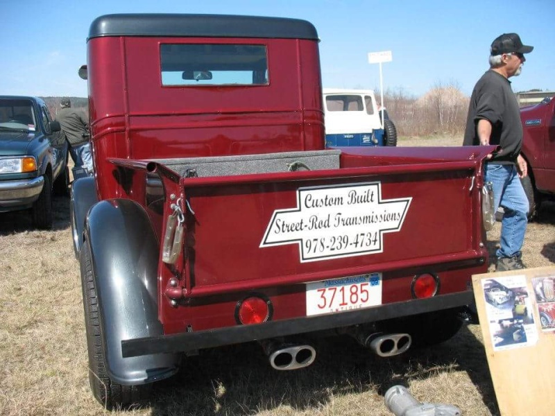

So I still have this car... Lol
The brakes have felt awful since I got it so I finally got some Delco rotors and Wagner Thermo quiet pads for the front.  Did one side after work today and will finish tomorrow. I think the calipers weren't sliding or something... Pads had meat and rotors were thick but glazed and rusty.
I recently got a good seatback from Al and put that in there.. I made one good drivers seat out of two, no more little rip driving me crazy. I think this means I've replaced more than half the interior... Haha.
I may put my bilstein shocks in but not until I finally flush the heater core... I totally forgot about that issue ... Weak heat especially if you put the fan on high.
The trans has been working excellent.... No issues and I think it has about 4k on it now.  Shifts nice.
I forgot to mention the guy who did the transmission in the first place... His name is John Batakis,  he's out of Middleton Mass.  His email is "astreetrodtrans@aol.com" I've seen him answer tech questions on forums in the past and I'd recommend him for sure.
