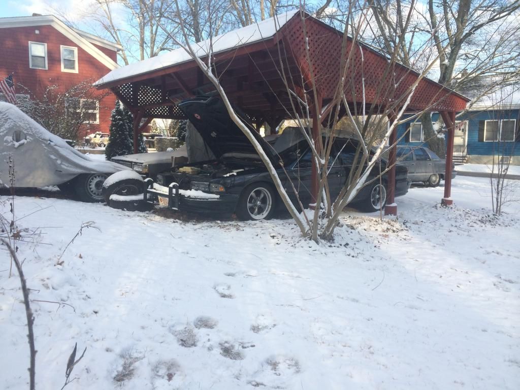

That town line picture is SWEEEEEEET!
 Arrow
The SSheriff (1996 9C1) - Page 12 Empty
PostSubject: Re: The SSheriff (1996 9C1)   The SSheriff (1996 9C1) - Page 12 EmptyTue Jan 07, 2014 2:05 am
Indeed! Inspired by the pic below. Too bad my pic(s) is a crappy cell phone pic.

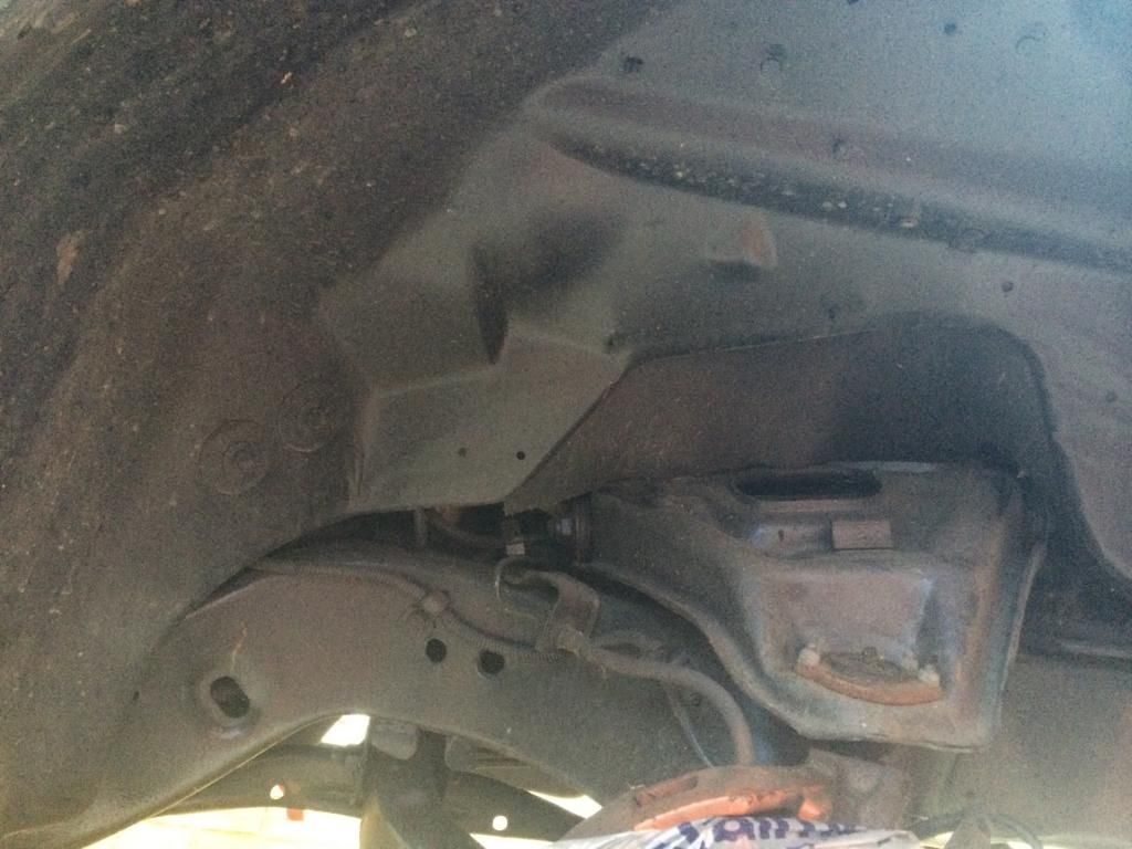

Yup. Found this guy loose and rattling and 2 others completely missing. All on the drivers side.
The SSheriff (1996 9C1) - Page 12 Image_zps22eb02ee
PostSubject: Re: The SSheriff (1996 9C1)   The SSheriff (1996 9C1) - Page 12 EmptyFri Jul 25, 2014 10:49 pm
About a month ago I replaced all the bolts on the passenger side of my wagon. The rear most bolt was broken and the gasket blew out so it was loud as hell. I couldn't get that stud out using the well known method so I installed a new metal fel pro gasket using all new bolts in the holes I could get bolts into and it is quiet now. All the bolts came right out without any penetrating oil just using a 3/8 ratchet and small breaker bar on the end of it. Which is surprising because there is rust everywhere. The motor was warm and I didn't detach the cat from the manifold. Just unbolted the intermediate pipe.
PostSubject: Re: The SSheriff (1996 9C1)   The SSheriff (1996 9C1) - Page 12 EmptyFri Jul 25, 2014 11:04 pm
I also replaced mine, with grade 8 bolts. Backside driver bolt backed almost all the way out!
PostSubject: Re: The SSheriff (1996 9C1)   The SSheriff (1996 9C1) - Page 12 EmptyFri Jul 25, 2014 11:16 pm
I've heard of it happening, I knew the front drivers was missing, but I didn't expect to find this!

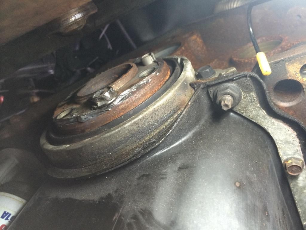

Here's my loud ticking/clacking. It's been too long like this, but now that I know for certain I'm gonna wait to purchase an aftermarket flexplate and a better TC. No sense in getting under there multiple times. One shot, one kill, as we say. A friend offered up his lift at his shop after he's finished building his plow truck. That'll hopefully give me enough time ($) to gather what I need. Anybody know the specific size/thread of the flywheel bolts?

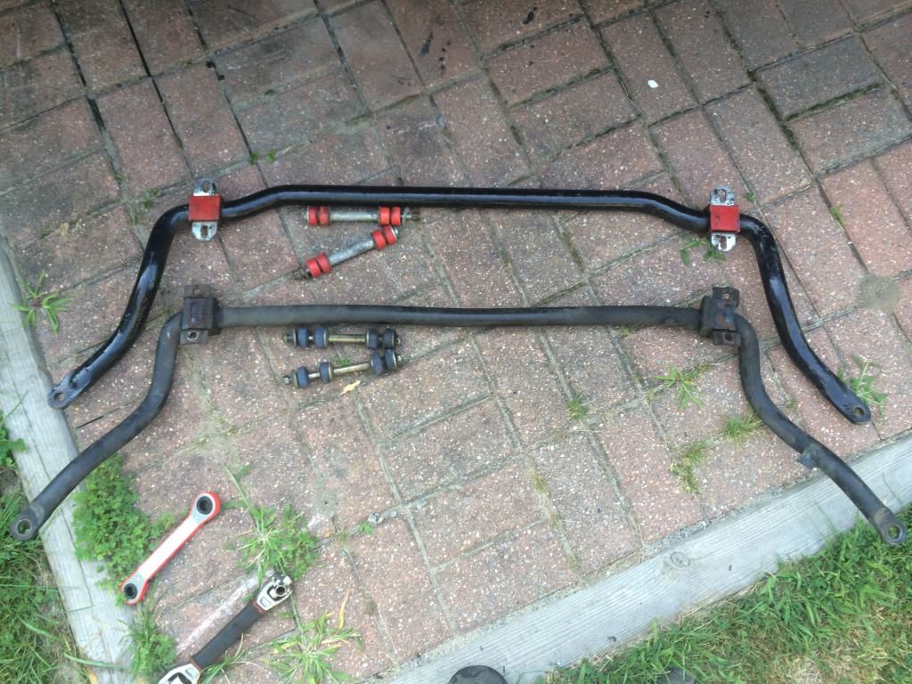

I re-found my corvette fuel rail covers from a couple years ago. I installed the studs before I even owned the covers. Might end up putting some washers under the studs to allow some room for the harness. Everything is ready to be neatly tucked. I ordered the 90* Gates hose that "replaces" the disco corvette booster hose. Good ol rock auto!
I started putting the new (to me) solid Spohn chromoly sway bars and poly bushings/end links on. These are HEAVY. Gonna have to do some counter-weight reduction elsewhere on this pig.
Spohn on top (upside down) stock on bottom
The SSheriff (1996 9C1) - Page 12 Image_zps0abbd7c1
Also swapping out the SS springs out back for the PPM springs I had in last year. Sits too high with the SS stockers.

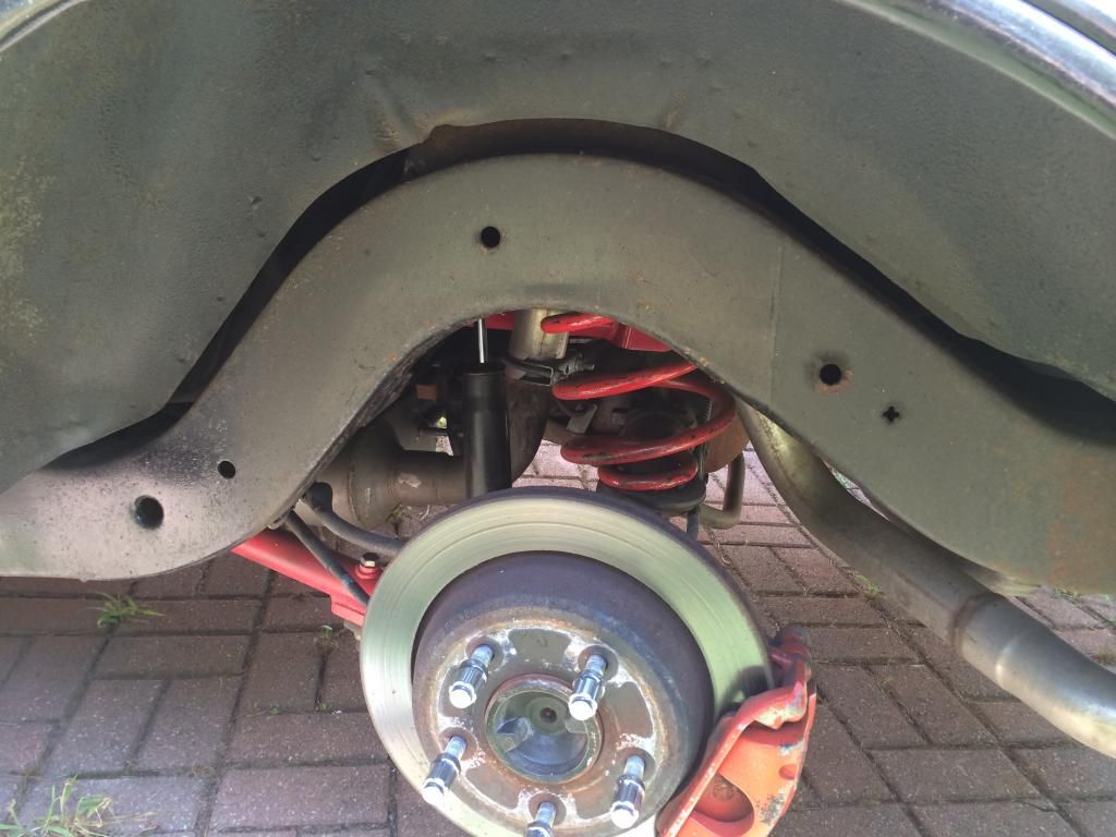

Started on the rear Spohn sway bar install. By start I mean, jack stands, wheels off, not one bolt turned. But, here's the rear of the car still clean.
The SSheriff (1996 9C1) - Page 12 Image_zpsb97c5571
The SSheriff (1996 9C1) - Page 12 Image_zps2e0e029e
Hopefully when it's all done, I didn't add too much sway bar. Next things to upgrade are valve springs, rockers, brakes, exhaust (headers and elec cutouts) and some other small things. She may be "down" but she sure ain't out!

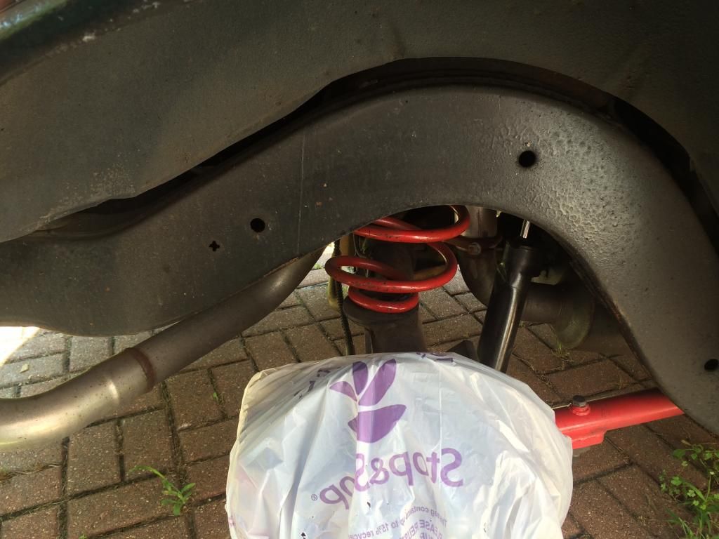

Got the rear Spohn sway bar on. It seems as tho the extended control arms do in fact spread out the mounting points for the sway bar. The stock one is apparently flexible enough. As I had little to no trouble putting it on maybe 2 years ago. I had to work some sorcery to get this one to fit on and bolt up properly. I also unbolted the shocks and swapped the PPM autoX springs back in. 1" drop difference between them and the stock SS springs I had in.
The SSheriff (1996 9C1) - Page 12 Image_zpsf50a55c6

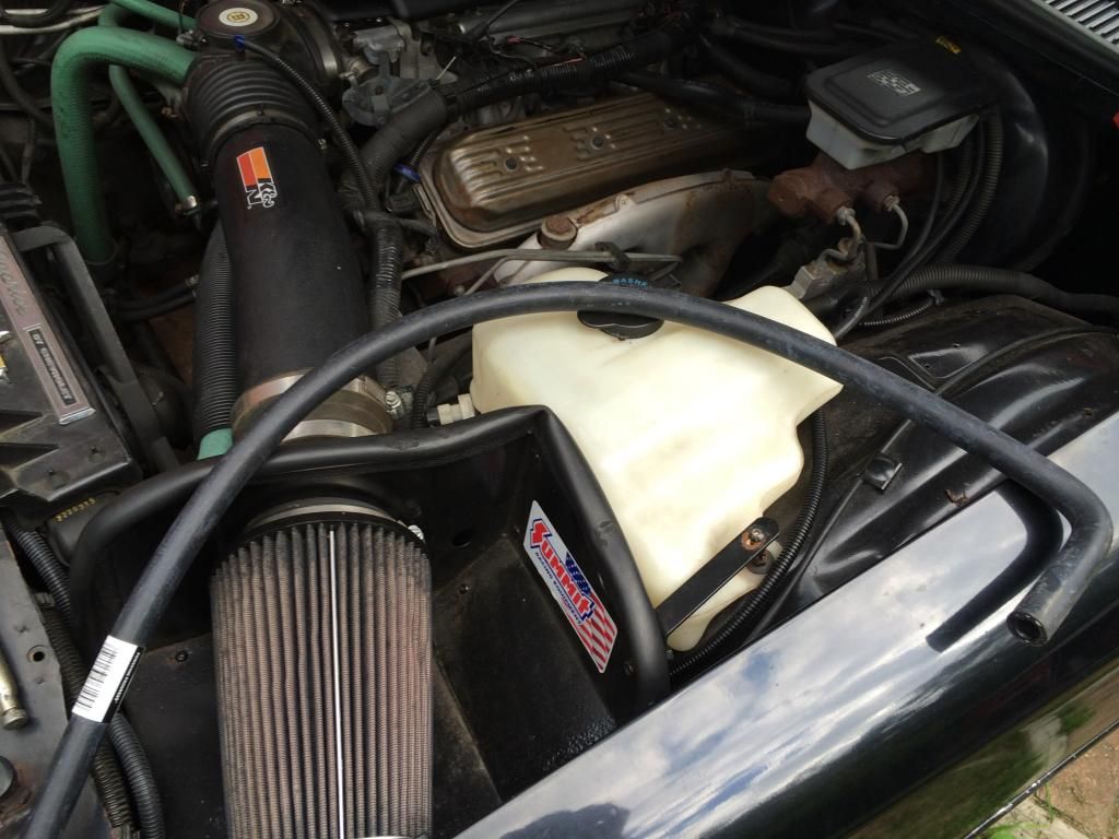

The hose I ordered from rock auto came in. So I'll be tucking and stretching to get the corvette covers on.
The SSheriff (1996 9C1) - Page 12 Image_zps88758def

This pretty much ruined everything for me. I think I'm done until spring time. Roll her back out when it's warm again and reassess my situation. I tried it all from welding to vice grips to bolt-outs.
The SSheriff (1996 9C1) - Page 12 Image_zps01f2ed27
PostSubject: Re: The SSheriff (1996 9C1)   The SSheriff (1996 9C1) - Page 12 EmptyWed Oct 15, 2014 9:11 pm
Hey. Are you having a problem breaking it loose because the motor turns? I have used a pipe wrench tuned back front to back in relation to the car on the harmonic balancer. Basically you put the jaw of the pipe wench in the big opening on the balancer, while the other part is gripping the belt side of it. then turn the motor with wrench til it puts the wrench against the frame. Now the engine will not turn in that direction. I have used this method several times to break the balancer, and the flex plate bolts loose.
PostSubject: Re: The SSheriff (1996 9C1)   The SSheriff (1996 9C1) - Page 12 EmptyWed Oct 15, 2014 9:17 pm
No. Give me some credit, here. For that, I threaded in some bolts on the balancer and stuck a crow bar in there. Works great!
One (of the many) cracks in the plate was cracked up over the flange on the bolt head. Any attempt to break that bolt loose stripped it more and more. Me I'm here. Up the creek. No paddle. I've used the craftsman bolt-outs to no avail. They just cut the corners off the bolt head :/
I'm at a loss here. Extremely beside myself.
PostSubject: Re: The SSheriff (1996 9C1)   The SSheriff (1996 9C1) - Page 12 EmptyWed Oct 15, 2014 9:24 pm
Can you get a dremel up there to grind or cut away the welds?
PostSubject: Re: The SSheriff (1996 9C1)   The SSheriff (1996 9C1) - Page 12 EmptyWed Oct 15, 2014 9:30 pm
Weld an offset wrench to the bolt. Then hit it with a hammer.

This is me needing a paved driveway or garage with a lift bom
Pic from months ago. Probably another 3' of snow now.
