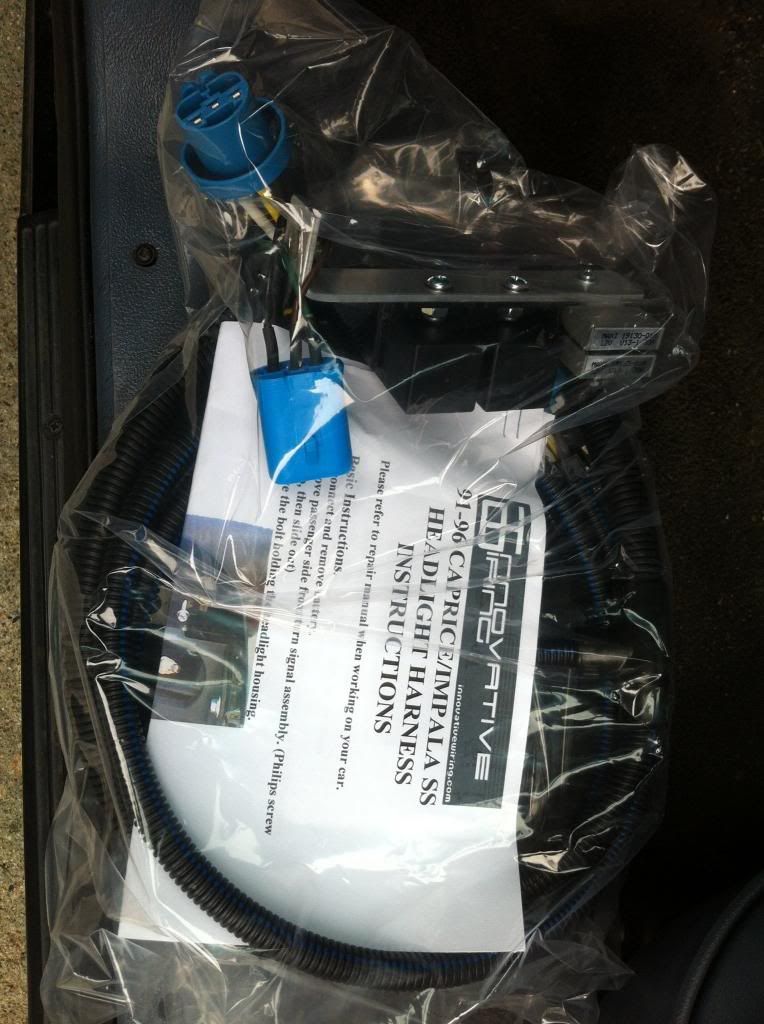

I bought Gary's Innovative Wiring 2 relay plug and play headlight harness. A bit of change, but will help take the load off that switch.
http://innovativewiring.com/?page_id=232

Got HIDs hooked up the other day.
Today I received Gary's wiring harness. Super simple to do. Includes instructions, zipties, and extra relays.
Took me all of about 30 minutes to do.

Interesting, my streetlights came with that exact relay pack.
