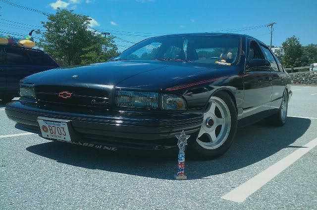

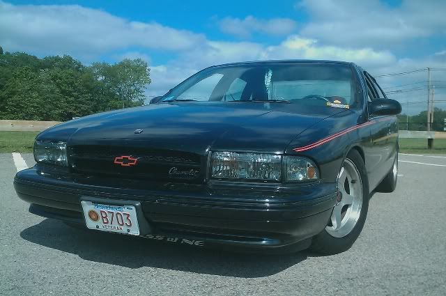

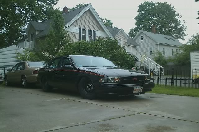

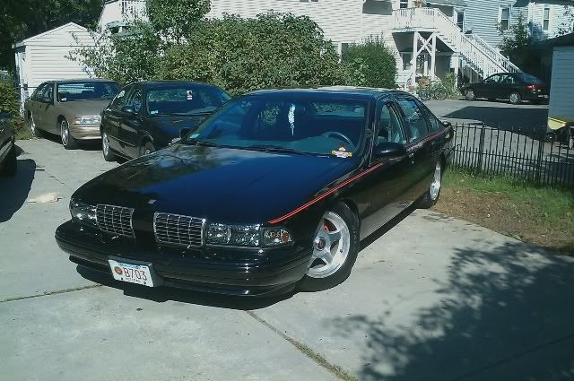

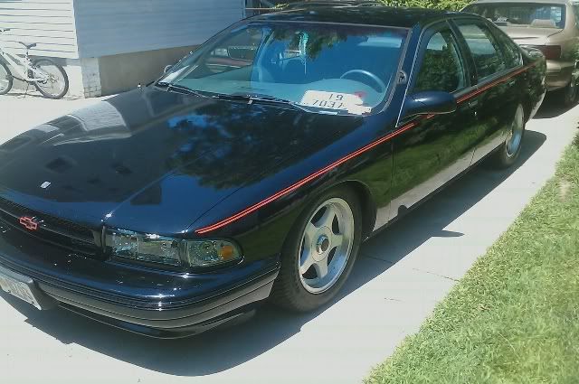

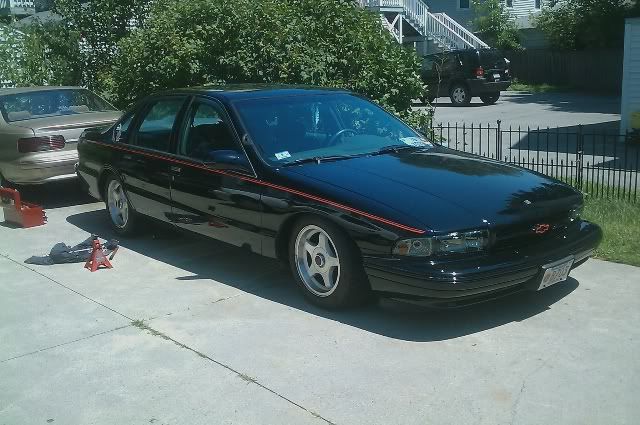

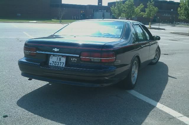

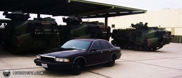

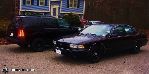

Since retired in 2009, this one's gone through something close to an identity crisis. I'm still not fully sure on its direction as time and money always play the key roles in everything we do. New additions to the family play a bigger role as well. Its got the 5.7 with 40 something k new, new rearend(posi) stock 3.08's etc. I'll save you the list of the small things I've done so here are pics...
The day i bought it
After paint
Spotlights, SS grill, and pinstripes added
As of today
Note my "euro plate" from a friend in Jordan
PostSubject: Re: The SSheriff (1996 9C1)   Sun Jul 03, 2011 4:17 pm
Looks good!
PostSubject: Re: The SSheriff (1996 9C1)   Sun Jul 03, 2011 4:20 pm
Agreed- it looks sick now and you can always put it back the way it was if you wanted anyway. I'm split on the red stripe but it's really up to what the owner wants to do when it comes to that stuff, people told me to take the blue one off my Caprice but I like it, lol
PostSubject: Re: The SSheriff (1996 9C1)   Sun Jul 03, 2011 4:51 pm
Pinstripes are the way to do it with bigger cars and trucks IMO. I like the ss wheels and the new ride height too!

I tried the stock N97's a little while ago. Thoughts?
PostSubject: Re: The SSheriff (1996 9C1)   Sun Jul 03, 2011 11:57 pm
Damn that looks good. I kind of like the N97s with all thats done to it.

PostSubject: Re: The SSheriff (1996 9C1)   Mon Jul 04, 2011 12:21 am
Thanks guys. The pin stripes will probably stay, just because it was my first time doing it. Atleast until the car gets resprayed. BTW, 5% tint is NOT, legal in Mass. It looked good for a few months until I moved back tho...makes me miss cali. All they care about is smog. Great place to buy 9C1's tho Wink
