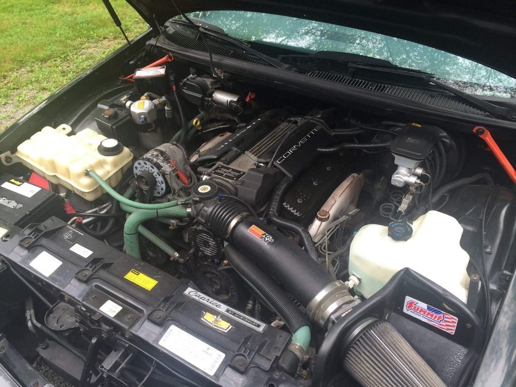

| Been driving for about a week and a half. All it needed was a new coolant temp sensor on WP (kept getting a code) and trans fluid (from the shift shaft seal leaking. But I fixed that). I also bought a new wheel for the drivers front to replace the severely bent one from last year. Was $10 more than having it reconditioned with no guarantees. $20 mount and balance my old (new) tire. Can't beat that. I also installed that fuel gauge calibration device. Took about 15 minutes to instal, full tank of gas, dial it back, and boom. Accurate gauge again. At least on the high side of the gauge. A friend from ISSF in Michigan located a mint rear blue non limited Roadmaster sedan seat for me for $46. Waiting to have it shipped. Pics... New battery and you can see the Innovative Wiring headlight harness and battery cable bolted up. | |
