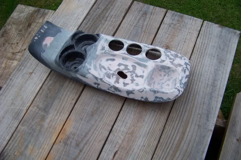

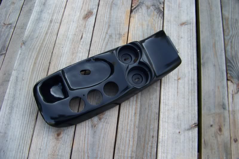

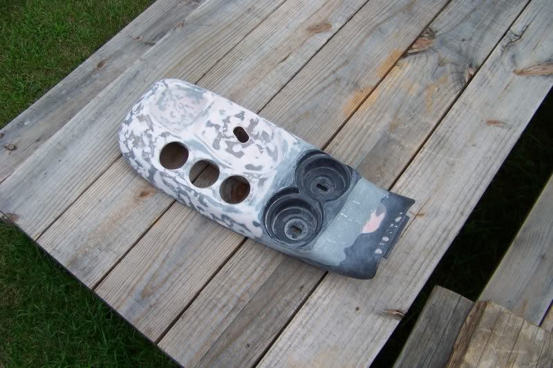

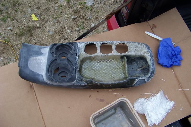

a little more progress on the console.
dont mind the odd shaped gauge holes, i just need to
keep track of where they are for now.
[project] laidlow,pt.2 pg.3 - Page 2 000_0160
[project] laidlow,pt.2 pg.3 - Page 2 000_0161

i love pics like that. then you can compare before and after. keep them coming. Very Happy

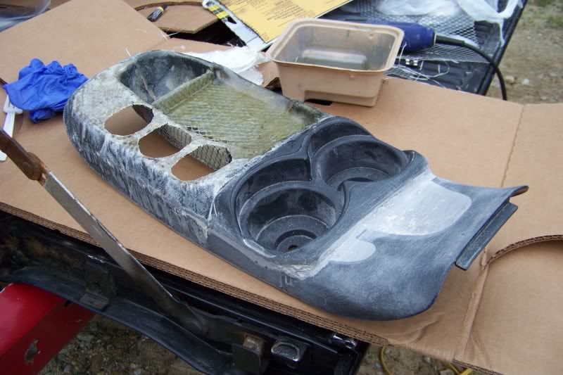

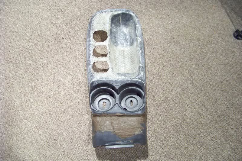

ive got to try and finish this before it gets nice out.
im running out of things to do with out the gauges and switch box hooked up.
[project] laidlow,pt.2 pg.3 - Page 2 100_3926
[project] laidlow,pt.2 pg.3 - Page 2 100_3927
[project] laidlow,pt.2 pg.3 - Page 2 100_3929

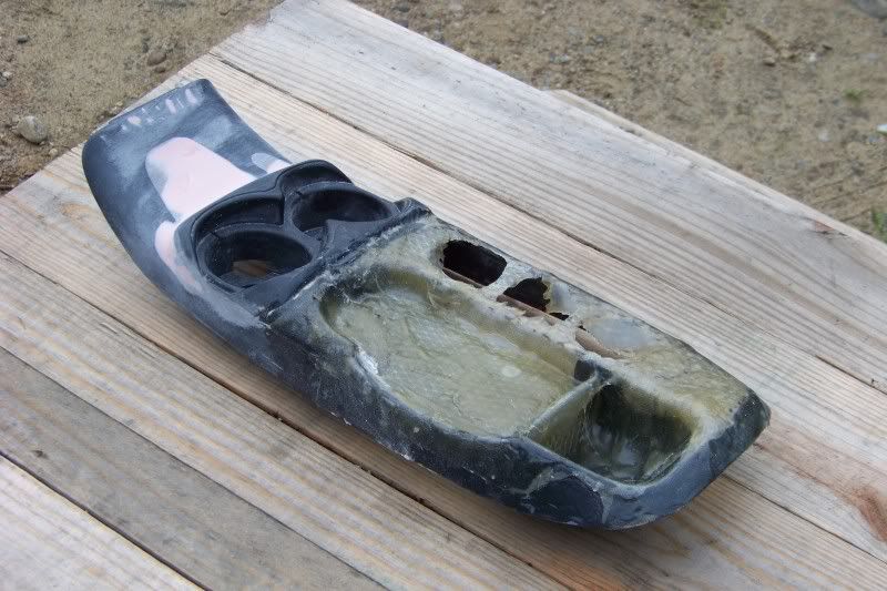

just a small update.
the weather has finally started cooperating and ive been able to get alot of
work done this week.sunny
just about done with the console need one more thin coat on a few spots.
thought i would throw in a before pick.
[project] laidlow,pt.2 pg.3 - Page 2 100_3880
[project] laidlow,pt.2 pg.3 - Page 2 100_4079
[project] laidlow,pt.2 pg.3 - Page 2 100_4080

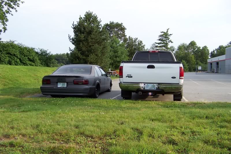

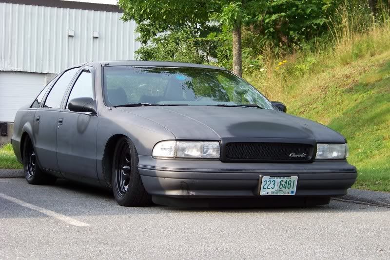

just some random pics.
[project] laidlow,pt.2 pg.3 - Page 2 100_4069
[project] laidlow,pt.2 pg.3 - Page 2 100_4073
[project] laidlow,pt.2 pg.3 - Page 2 100_4074

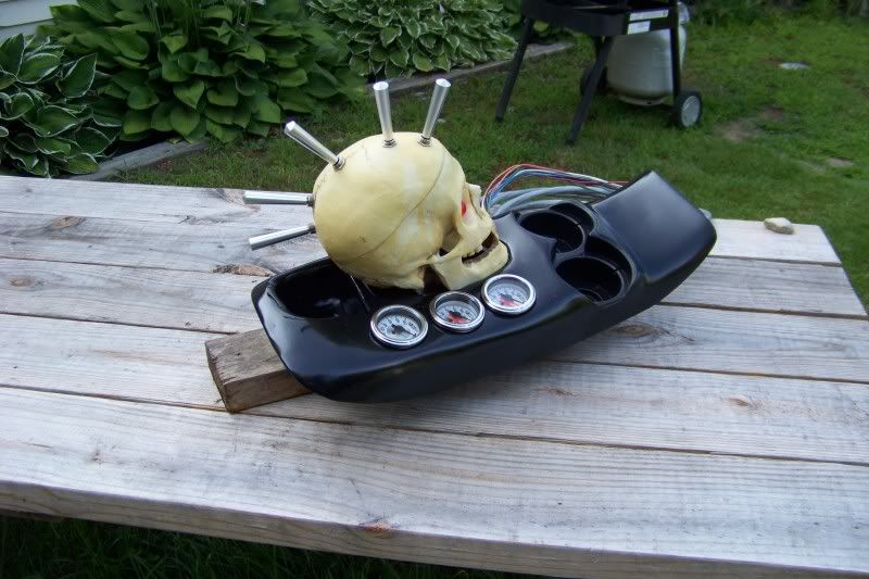

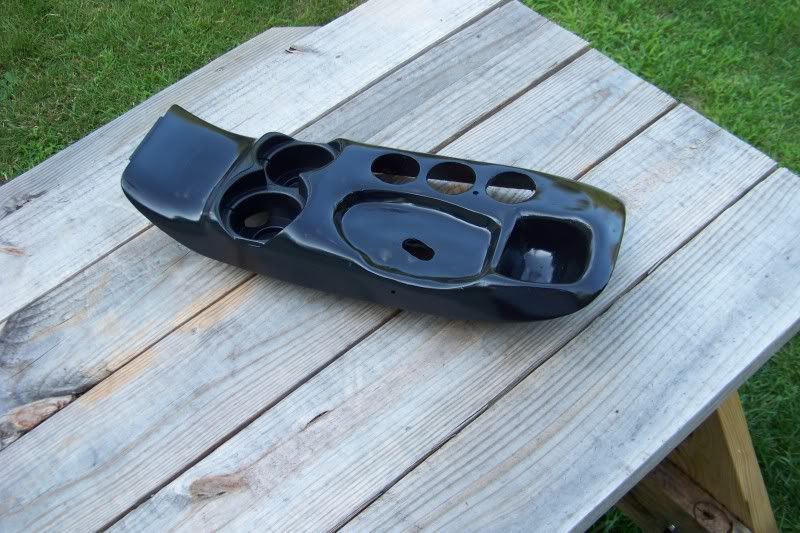

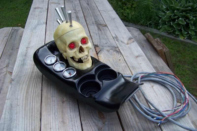

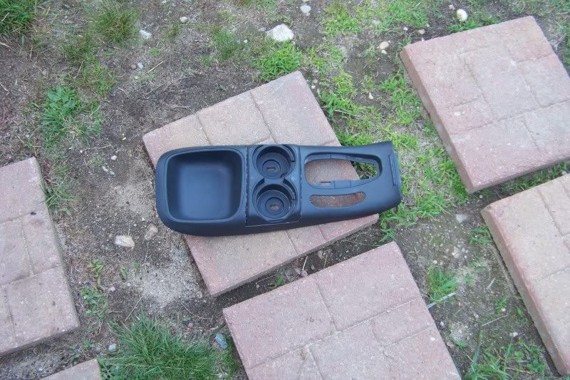

made some good progress today.
the console is 99.9% finished, got one more thing im going to try with it.
its not perfect but way better than i thought it would be.
dont know if the paint can was marked wrong but its supposed to be SATIN.
[project] laidlow,pt.2 pg.3 - Page 2 100_4081
[project] laidlow,pt.2 pg.3 - Page 2 100_4082
[project] laidlow,pt.2 pg.3 - Page 2 100_4083
[project] laidlow,pt.2 pg.3 - Page 2 100_4084

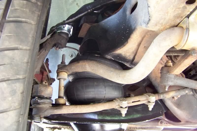

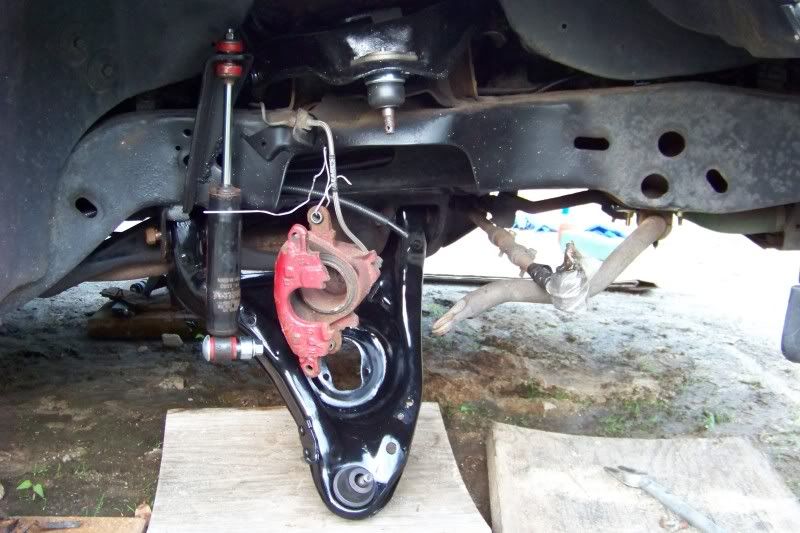

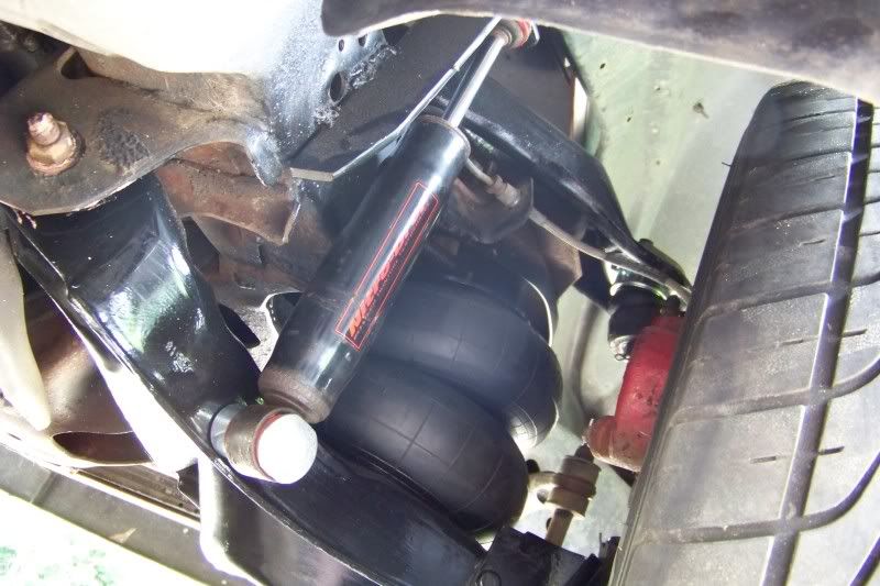

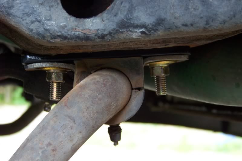

got the sway bar spacers in.
[project] laidlow,pt.2 pg.3 - Page 2 100_4088

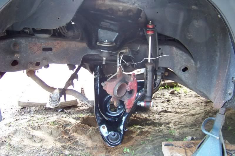

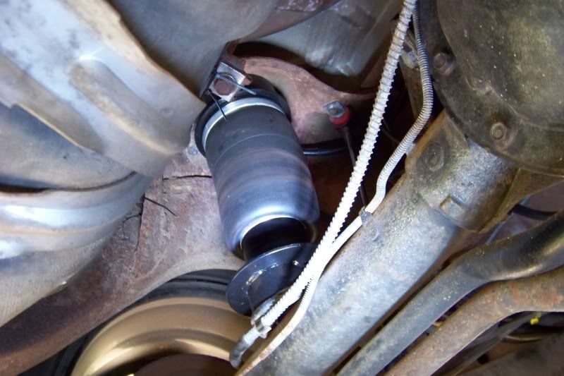

and got most of the front put back together.
[project] laidlow,pt.2 pg.3 - Page 2 100_4089
[project] laidlow,pt.2 pg.3 - Page 2 100_4090
just got a few things to finish up then ill bolt the bags in. cheers

Console and switches look effin BAD ASS!!!!! Very Happy

Awsome job Anthony. See it in your head, then build it.
Anthony, what you can do is give it another coat then after a couple minutes fog on a light coat. This will give it a texture, and make it appear more satin.

ive had the car aired up since sunday and have not lost
any air in the bags or the tank.
im very pleased, usually a fitting or two needs a little tweaking.
i put it up on ramps tonight to check the clearance around the bags.
everything looks good. should be able to test drive this weekend.
took a few pics while i was under the car.

took the car to work today.
the truck is a 2wd.
[project] laidlow,pt.2 pg.3 - Page 2 100_4122

and this is my favorite pic, and now my wall paper.
[project] laidlow,pt.2 pg.3 - Page 2 100_4125

Looking good Ant! Did you finish the console yet?
thanks Doug.
i tried to airbrush the console, came out alright.
when i cleared it thats when the problems started.
not sure what happened but the clear reacted with the airbrush paint and wrinkled.
had to resand the whole thing down and repaint.
so its just black like it was when you saw it.
ill take some pics today with it installed.
