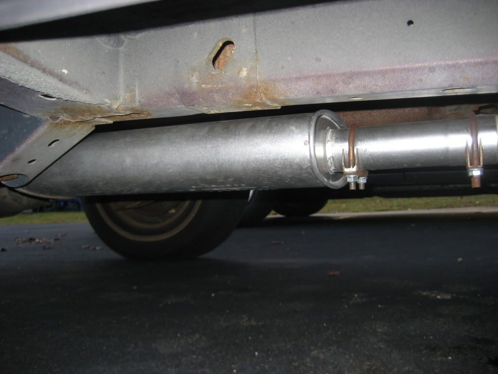

Side note i installed a brand new muffler and tailpipe.

Last but not least the shiny new WARRANTIED muffler. Laughing
