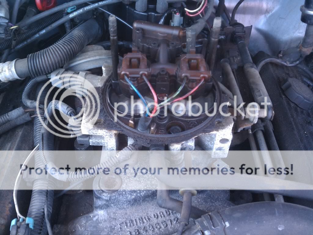

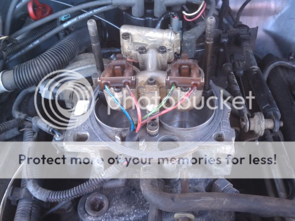

Well the stumbling/cutting out came back today. Not really sure what the issue is as it only seems to happen when the car gets warm and gets worse the farther you drive. Not sure where to start troubleshooting this one...
The Blue Whale Empty
PostSubject: Re: The Blue Whale   The Blue Whale EmptyWed Apr 02, 2014 7:44 pm
I got a "known to be good" TBI  throttle body with all the sensors sitting on a shelf for sale......... Jusssssss sayin......
Did you check the timing?
I'm thinking vacuum leak or EGR clogged
Posts : 595
PostSubject: Re: The Blue Whale   The Blue Whale EmptyThu Apr 03, 2014 4:29 pm
Thanks Indy, I appreciate the offer. I actually just re-sealed the throttle body today. It was pretty clean inside, some of the passages were clogged with goo, and the fuel regulator diaphragm looked like crap, no tears tho. So I doubt this is the answer to my problem, but good to know it's fresh now.
Before - Ewwwwww
The Blue Whale IMG_20140403_133304_zps749b0507
After - Nice!
The Blue Whale IMG_20140403_161812_zps1b8a1676

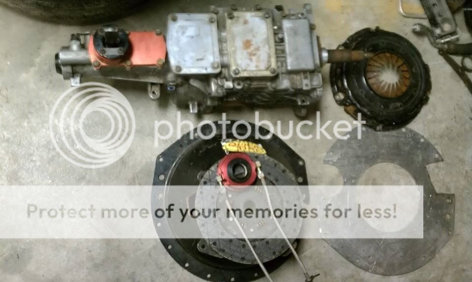

Went on a craigslist adventure last night to pickup the next mod for the OCC.
The Blue Whale Trans_zps43b95ed9
Price was right and the guy was cool. Had a sizable garage stuffed with Chevelles. I could've drolled over them all night, but I had to get back on the road.

So forget the four speed. Got an unbelievable deal on this TKO600 this week.
The Blue Whale 11896129_10154214509129816_9211810680876170851_n_zps4jpib0nz
I'll just say I got it all for less than the bellhousing sells for new. Now I just need a 6.0L, LSA supercharger, etc etc.
