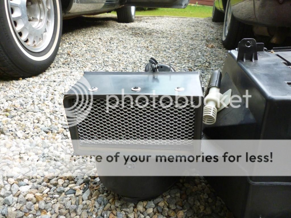

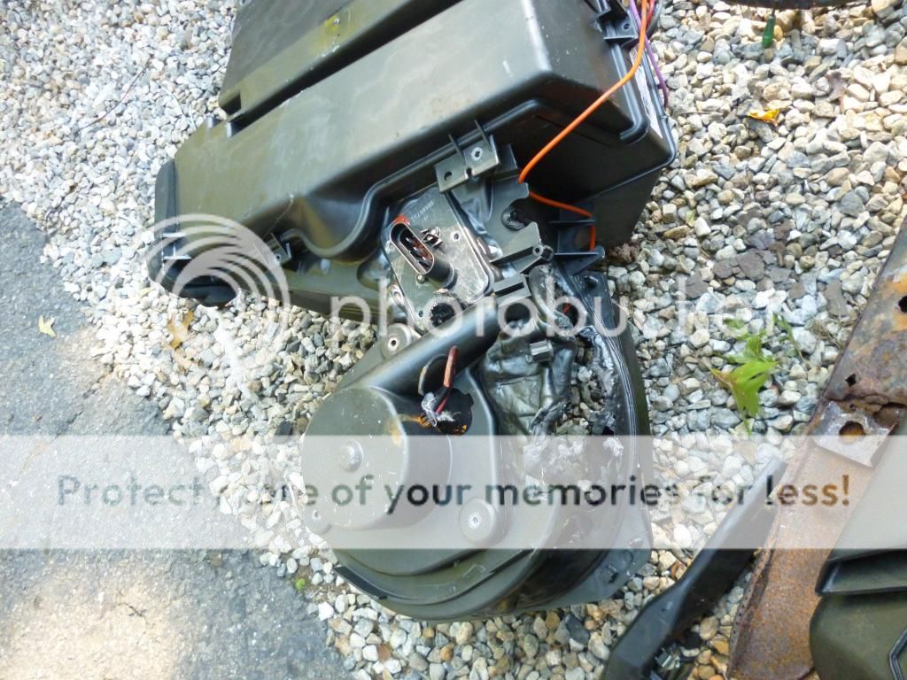

Now that I found my SD card from my camera I can finally show you all what I did to prevent a fire from breaking out in my Caprice again. As a lot of you know I have had a problem with mice getting into my 9C1's HVAC housing since I bought it. What started out as a minor annoyance of having to clean out the blower every now and then escalated into a fire. While I had the car torn apart to replace the melted and burnt parts (and upgrade to auto climate control) I went ahead and permanantly addressed this problem. My previous fix was to install the cabin air filter mod, which I did buy but never installed.
The "fix" itself is pretty simple, the difficult part is getting to the intake part inside the dash to do it. You could probably do this under the cowl, but if the box is out of the car it's much neater. I used a piece of steel gutter leaf guard from the hardware store and cut it into a box shape. Once tested for fit I riveted it into the box. So far it's been in there for 2 months and I am happy to say nothing has been living in my car cheers
Rodent proofing the B-body P1000817

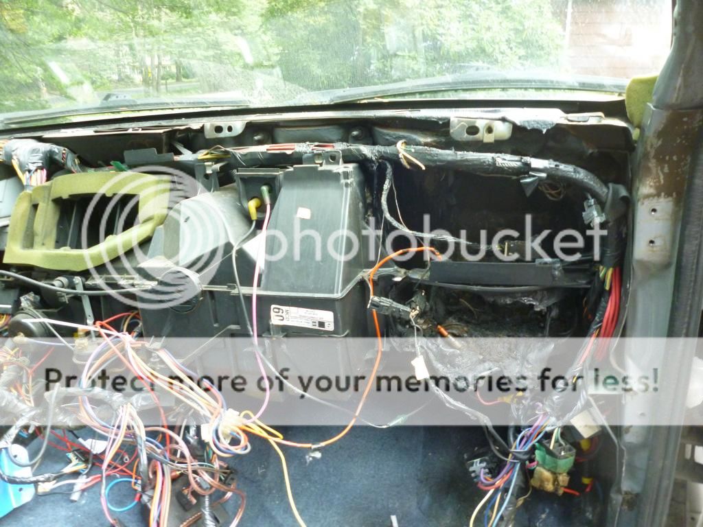

And what your dash looks like when you almost have this thing out of the car:
Rodent proofing the B-body P1000819

Interesting. How long you figure it took to get the dash down to that point? Matt, let me know when you're doing this mod to the dggm. I wanna stop by and check it out. Arrow
Rodent proofing the B-body Empty
PostSubject: Re: Rodent proofing the B-body   Rodent proofing the B-body EmptyFri Nov 16, 2012 8:48 pm
Damn, I had a really good pic of this thing with all the lines on it. I'll have to dig through my camera again.
As far as disassembly, I would guess hour and a half to get to this point, give or take. Its easier if you have parted these cars before to learn all the little tricks of how parts are attached.

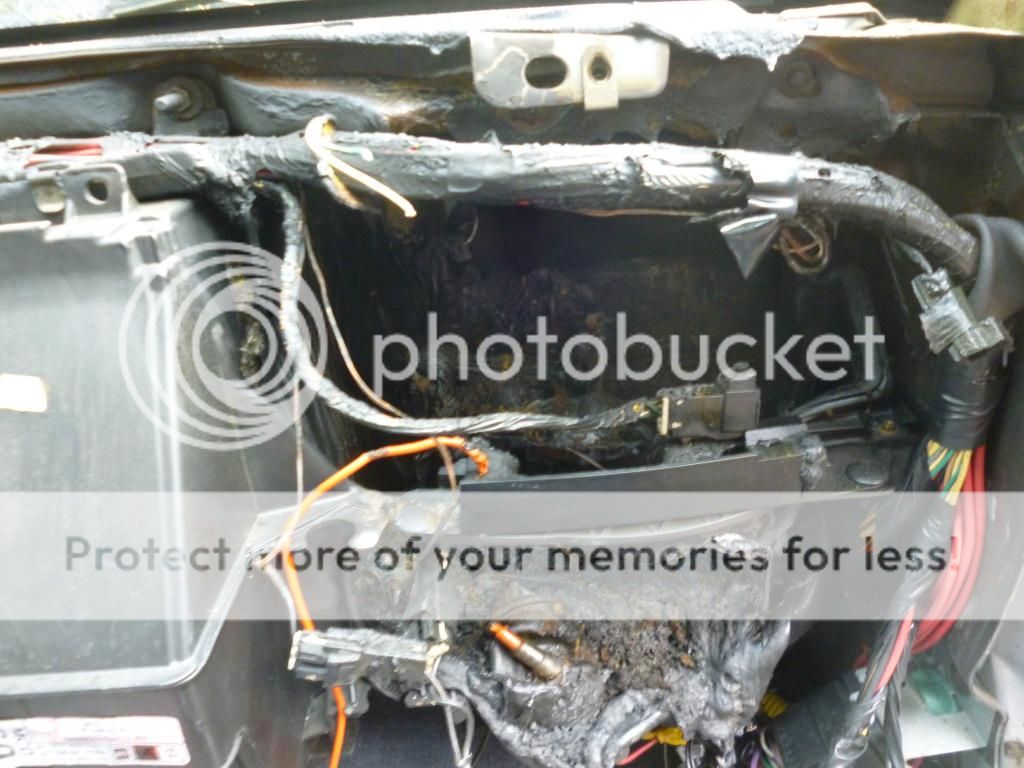

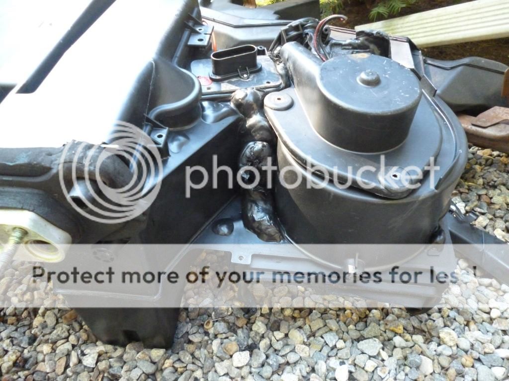

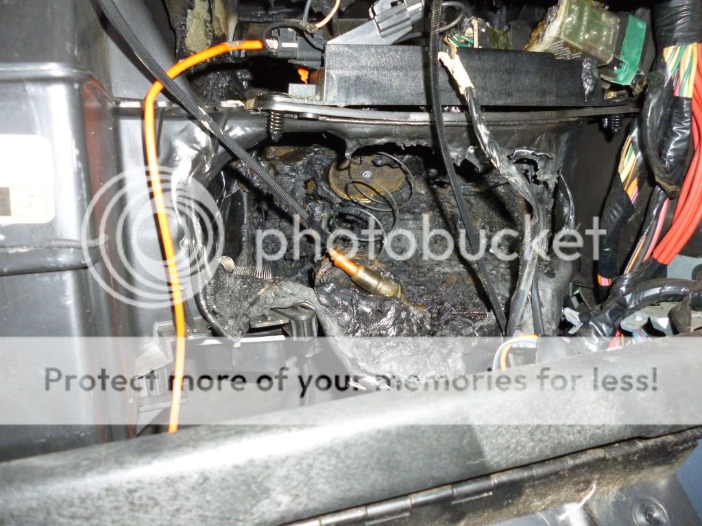

Dave, for some reason I thought this happened because mice chewed wires that started the fire? Was it actually a nest or something that ignited? So relieved my problem didn't get to that level!
I'm curious as to where the mice get into these cars, like an entry point? Mini Coopers have a big problem with it where there is a very convenient air intake sort of thing that they just hop right into, so I'm told.
PostSubject: Re: Rodent proofing the B-body   Rodent proofing the B-body EmptySat Nov 17, 2012 6:22 pm
Matt,
It wasn't chewed wire that started it, it was the nest they made on top of the blower resistor next to the fan. That thing apparently gets hot enough to ignite something flammable if there is no airflow from a clogged blower. I guess that's why they stick it in there to be cooled by the blower. I had always wondered how they got in there in the first place, I always found insulation under the dash, in the trunk and under the rear seat. As it turn out, they were getting into the car under the cowell where the air intake is and would find their way out of the air duct or something into the car. This is not the first B-body I had to clean a nest out of, just one with the most persistent mice. I lost track of how many I killed over the years. Nothing funnier than an LT1 covered in mouse traps Razz
This link shows where the cabin filter mod is done, that is the intake where they get in along with all the other crap we have to clean out every now and then.
http://www.goldsswagon.com/cabinfilter/cabinfilter.htm
Below are some more pics of the CARnage.
