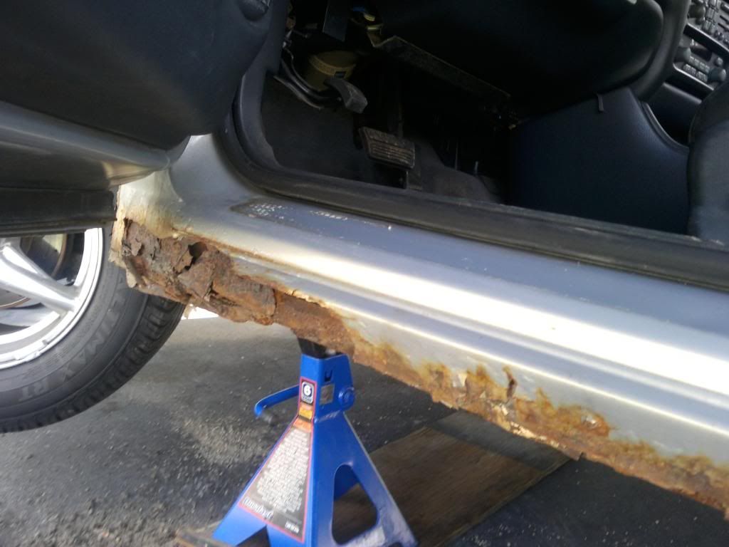

So the wifes car failed big time at inspection day. I knew it would. Rolling Eyes There was no drivers rocker, and the passengers side needs floor work by the rocker, and all four tie rods. I had all the parts, just have not had time. Until today. Found more rot than I thought I would going all the way back into the quarter. But since most is covered by the ground affects, I ain't makin it purdy.

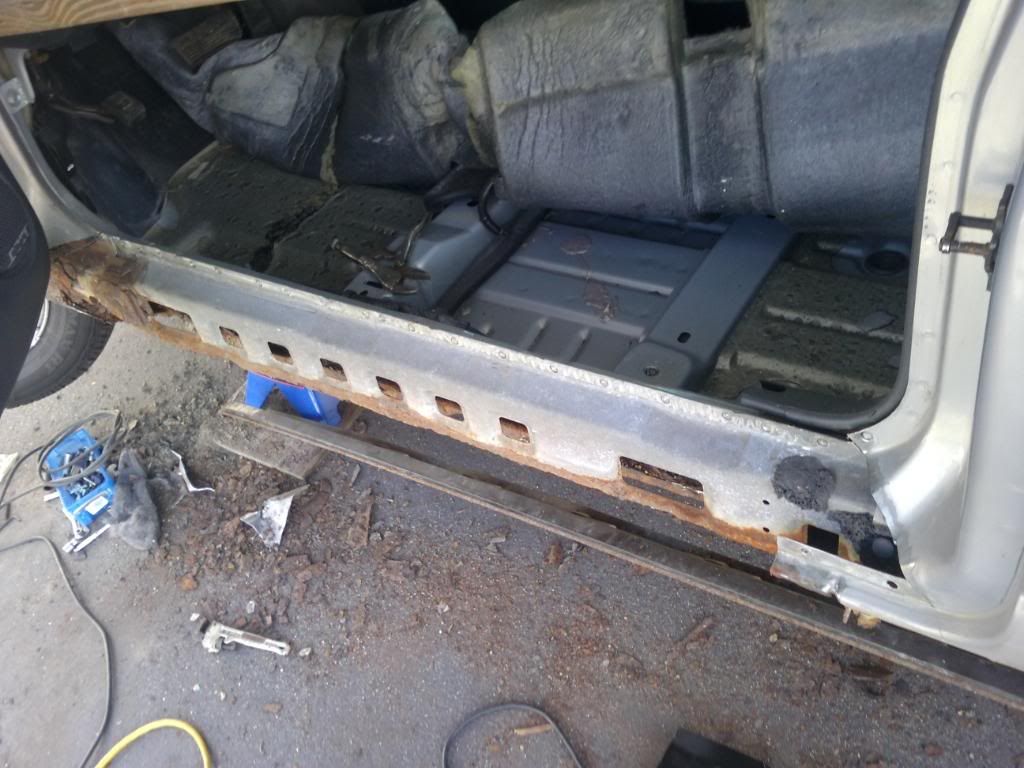

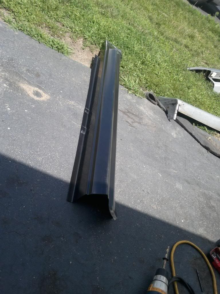

Once the ground affect came off, this is what I had to remove.

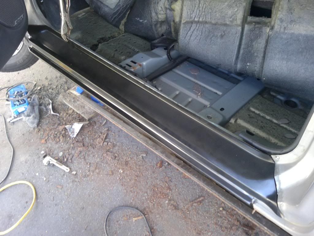

New hard to find drivers two door rocker panel.
All the rusty removed

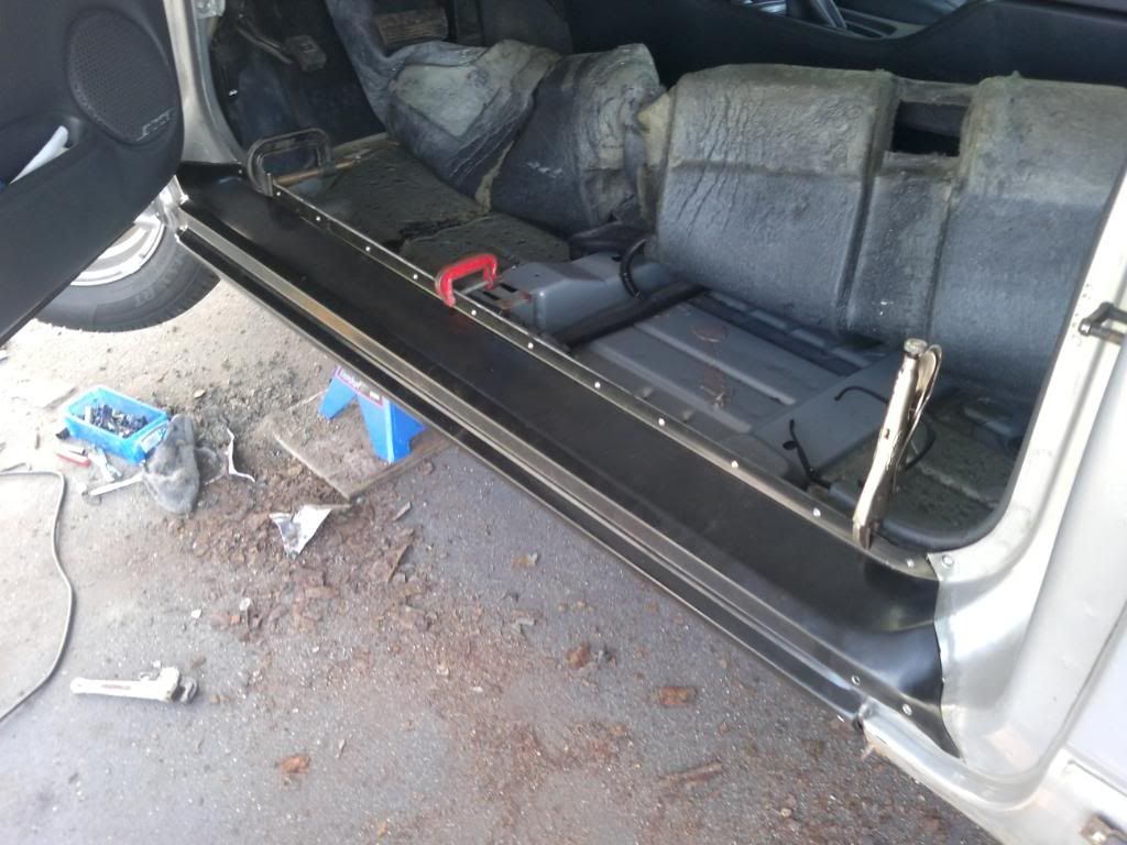

Test fit
ready to weld
Installed and some left over sheet metal tacked in to cover the uglys on the quarter.

Looks good Billy. So the cladding covers all of that anyway? Did the inspection station guy actually get down and look up behind there? Down here if they can't see it, it seems like they don't care...
Guy I work for has a Century that had the little water-filled bubbles forming there when the car only had 50K miles, every one I see in the junkyard is rotted for the entire length of the rocker, even some of the Wimpalas I've seen are like that. (They all seem to snap the front sway bar at the end links too. Evil or Very Mad)
He was thinking about getting the plastic pieces from a Regal and putting them on the car, but it seems like a lot of work...
Posts: 832
Join date: 2009-01-17
PostSubject: Re: W-Body rust repair   Sat Jul 07, 2012 7:15 am
Once on a lift, you can see behind the cladding. Not to mention there was a big hole where the door jam should have been.

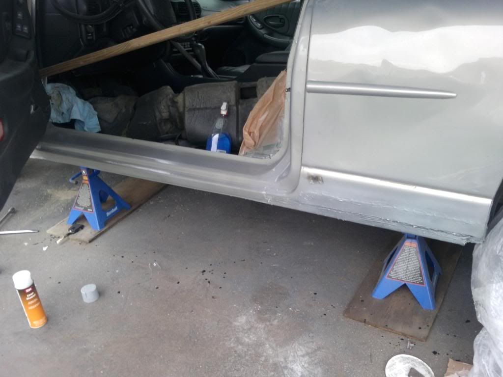

PostSubject: Re: W-Body rust repair   Sat Jul 07, 2012 12:27 pm
Finished with the drivers side

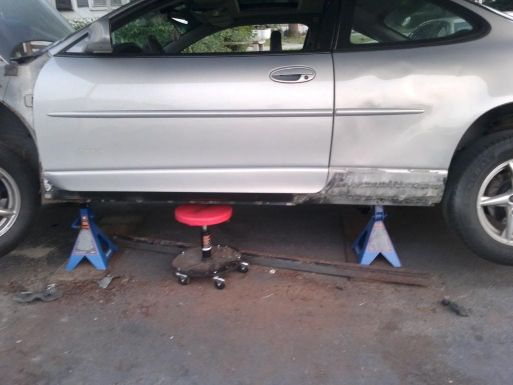

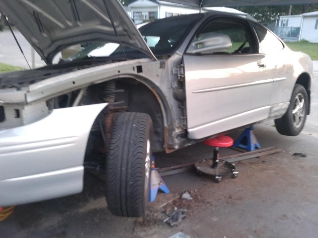

Passengers side really sucks. No fancy patch panel here. Just plain old redneck engineering. Rolling Eyes So the first thing I found after taking the cladding off
is there is no pinch weld left in the rear. Well none with any usable metal. I looked in my pile of scrap and found a piece of 1" angle iron. So I cut the pinch weld out, and plan to weld the angle iron to the floor. Then I will have something to weld some home made patch panels too. I am also using alot of rust converter on this side since I need as much metal as I can get just to weld to.
Even the cladding mount is rotted. But I will weld some braces, and a place to bolt it to the body.

Eeek! Shocked
Base coat on. Got the paint from Paintscratch.com
And I see you have the same fire extinguisher as me... Wink
Is that stool rated to hold up the car??? Razz
Nice work on the driver's side, man. Seriously!

ROTFLMAO!!!!!!!!! Laughing Yes. I may or may not have had a tiny fire.. Maybe. Rolling Eyes Extinguishers are in the boat which is not here.
And thanks. Wink
I can not tell you what it is like to be out in 98 degree humid weather welding and grinding.
Here is my home made pinch weld. Welded in. Suspect It is welded completely on the back side. I was just trying to weld to rust on the outside. Mad

Almost done. Nothing pretty, just about creating what was missing.
