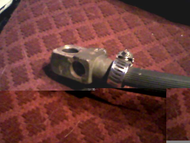

oh yea i found this when i was doing my brake lines..................whats wrong with this picture?

PostSubject: Re: rear drum parts   rear drum parts EmptyMon Feb 27, 2012 9:05 pm
That looks like one of those metric high pressure fittings. Illegal in Assachusetts Razz

PostSubject: Re: rear drum parts   rear drum parts EmptyMon Feb 27, 2012 9:09 pm
its the rear brake line tee ...............notice the hose clamp... haha i couldn't believe it when i saw it i have no idea how it didnt just blow apart .who uses a hose clamp on brakes?

PostSubject: Re: rear drum parts   rear drum parts EmptyMon Feb 27, 2012 9:13 pm
I know someone that clamped rubber hose over a rotted brake line to get the car to a repair shop, surprisingly it got the car there!
lol. I know Very Happy. I did that back in high school until I could afford to buy all new lines to put in.

PostSubject: Re: rear drum parts   rear drum parts EmptyMon Feb 27, 2012 9:21 pm
thats one thing but i had been driving this car for a while holy shit im glad i always stayed alert and never had to get on the brakes hard
