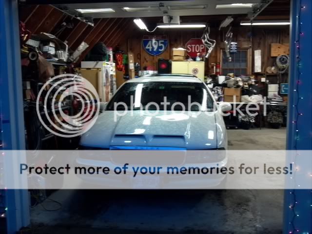

Here's a picture of her ready and waiting, because I know a thread is useless without pics... Wink
Squishing the Marshmallow... 2011-12-21160856

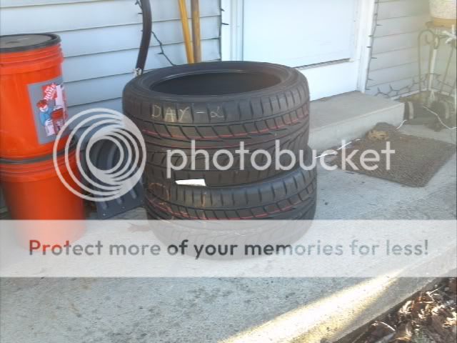

And here's my latest delivery:
Squishing the Marshmallow... 2011-12-28143244
Wow they're huge! Shocked

Cool!
Going to satin bomb it or keep it white?
Squishing the Marshmallow... Empty
PostSubject: Re: Squishing the Marshmallow...   Squishing the Marshmallow... EmptyFri Dec 30, 2011 8:47 pm
Real paint. Still undecided on scheme though...

We all know that rear end won't fit right
Smile
If you ever need a hand, you got my number!
PostSubject: Re: Squishing the Marshmallow...   Squishing the Marshmallow... EmptyFri Dec 30, 2011 10:05 pm
Two tone white and pewter. cheers
Two tone is not out of the question. But I'm not thinking pewter. I'm think more of a metallic caramel or bronze-ish color on top... Something that has some red in it to grab the interior. Sliver/pewter pinstripe that matches the wheels to split the colors.

295's affraid
Sweet. Whatever you do try to keep it white.

Those tires are the "other" Indy 500s right? The non-old school ones? They almost look like Nittos.
