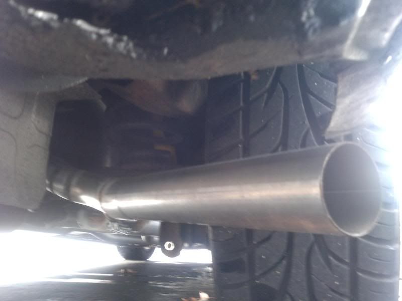

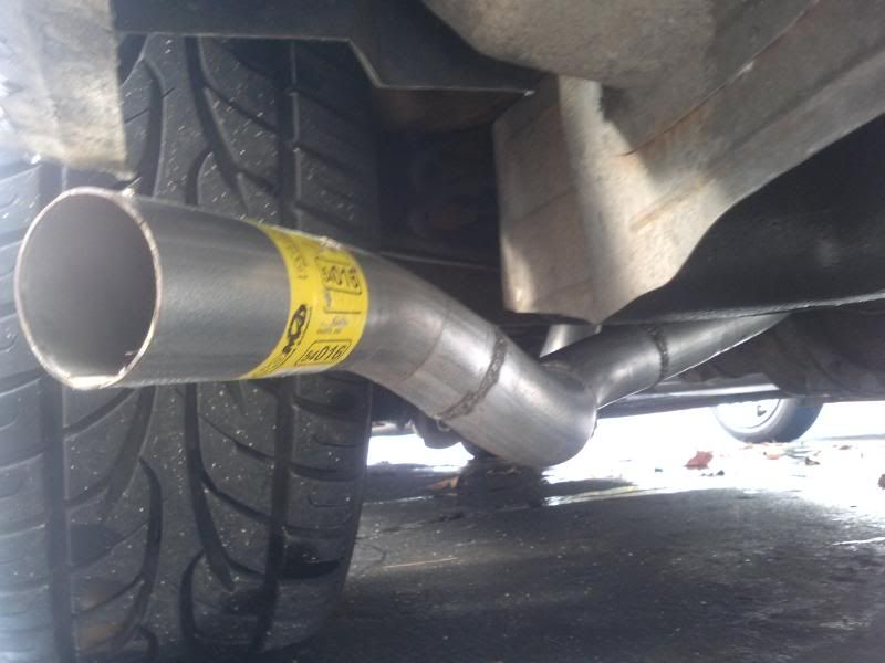

More shots of the OTA/tail pipes I made for the wagon. I love the location of these just behind the tire. One of my biggest complaints about these cars was going over a speed bump, or out of a driveway only to have the exhaust scrape.

Actually I whipped those together in about an hour using just the dynomax over the axle pipes, and one 18" piece of straight pipe.
Buy a cat back like Jegs or hooker, and a piece of straight pipe, or even a frankenstien exhaust like mine is, and I can duplicate the tails to fit the wagon and exit in the same spots.
I am also using band clamps this time around, as I can easily pull the system for other repairs like tranny swaps, and also so I can change the mufflers if I choose.
