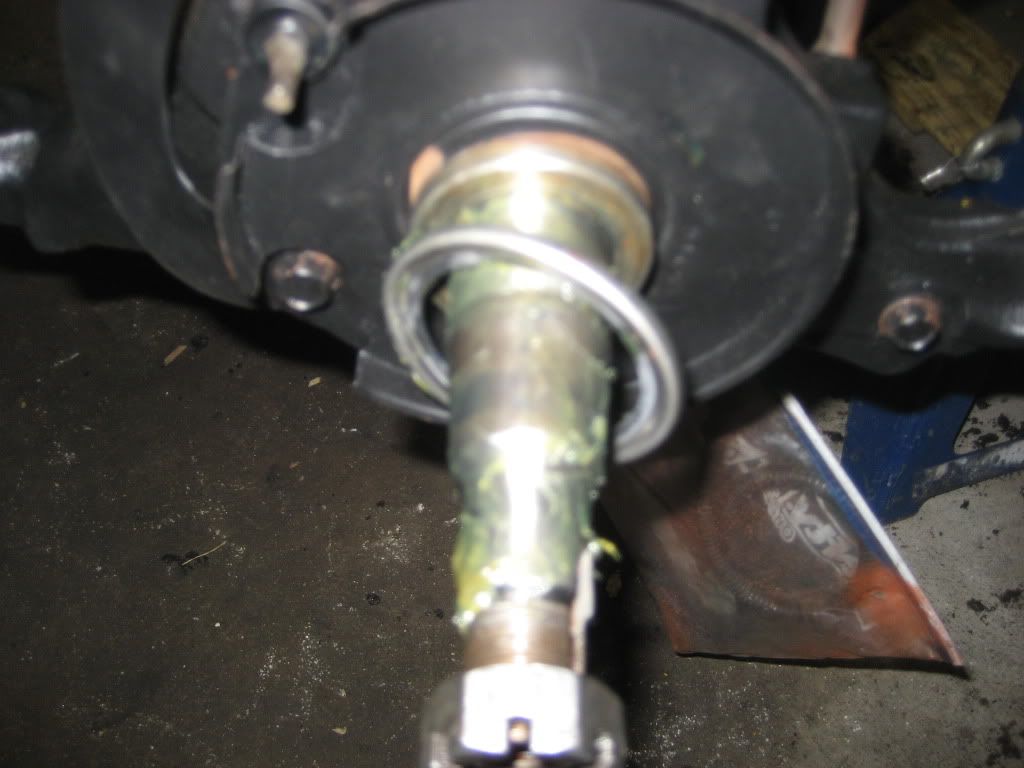

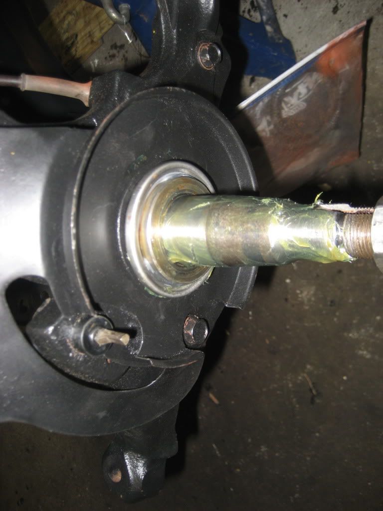

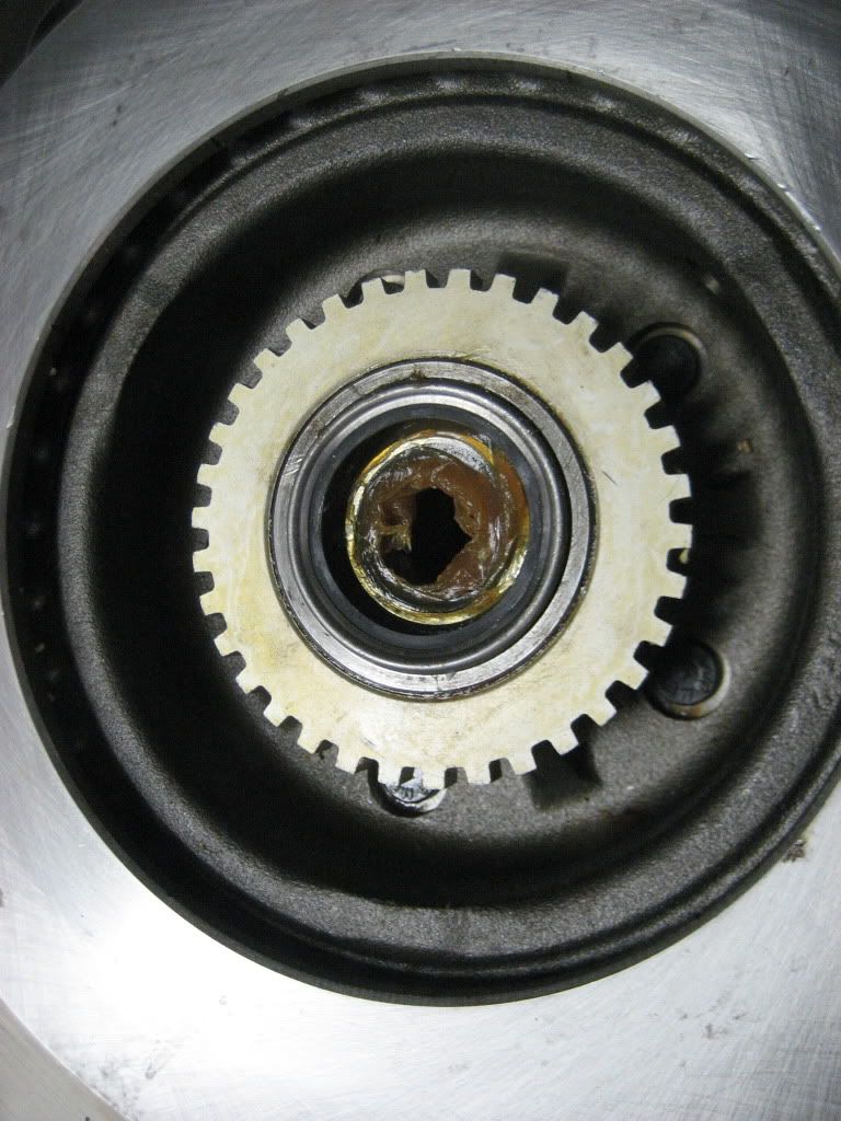

Where do i put this thing.Factory service manual has me confused.
Here on the back of the rotor.Would it have to be pressed in ?
wheel bearing seal assembly placement ? Frontendassembly007
wheel bearing seal assembly placement ? Frontendassembly006
Or here on the spindle ????
wheel bearing seal assembly placement ? Frontendassembly009
wheel bearing seal assembly placement ? Frontendassembly008

mark is this a trick question? pic number two is correct. its the inner grease seal. it goes on the inside of the rotor. ive a seal installer if you need it. or just tap it in with a small hammer. tap easy.

Yeah, like Ron said, you just tap it into the back of the rotor with a hammer.

...........or you could put it on the spindle first, then put the rotor on, and hit it REALLY hard Shocked J/K (don't do that)

I usually use a block of wood and a hammer to put the seal in nice and even and don't put dents in it.
