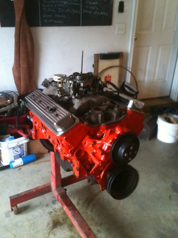

Losing some weight, got fully degreased and painted
The Little LO3 That Could 751576A3-972F-4B4A-AD9C-3D6BFD21A52D-1870-000003BEEF344ACC
Ordered a gear drive set for a roller cam, it came in and I definitely got what I paid for. Cheap non fitting garbage. Had to do some slight "goon handing" but they are installed. Let's hope it doesn't explode in there!! pale
All new gaskets, pipe plugs to block off all unnecessary crapola, aluminum edelbrock intake installed with 650 cfm carb
Almost ready to go (found a bunch of broken bolts stuck in the intake manifold. Working on re threading the thermostat housing bolt holes,
The Little LO3 That Could C055D616-AA7D-496F-866B-060DC5978F0E-1870-000003BED238E6EB
Installed the radiator and electric fans from Billy's DGGM caddy this weekend so hopefully that will work out.
