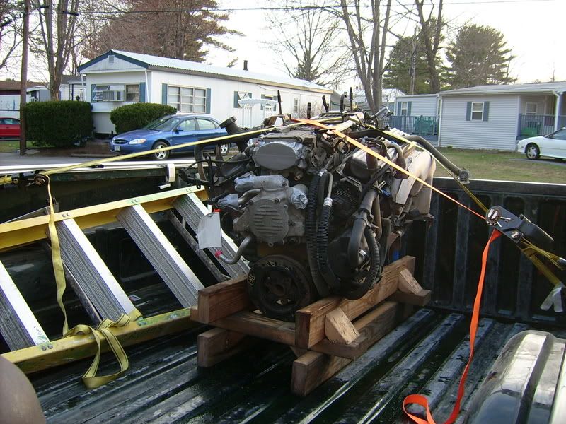

Original engine.
Mistake one: Change oil when you purchase a new car. I purchased a car, and did not change the oil right away. I then took the car to the track, and wiped out #7 rod bearing. Again, this only my opinion. I think what happened was the oil was old dirty, and it's viscosity had broken down to the point, that under normal driving condition, it could still do it's job. But when I ran the engine at very high RPMs for a 1/4 mile 4 times, the oil could no longer do it's job, and failed to lubricate the engine. Still not sure why number seven was wiped out instead of number one or number 2 unless I also got a piece of debris that made its's way through the filter media, and then it would explain why one of the first rod bearings to see lubrication was wiped out. And oil starvation from a clogged filter is possible as well.

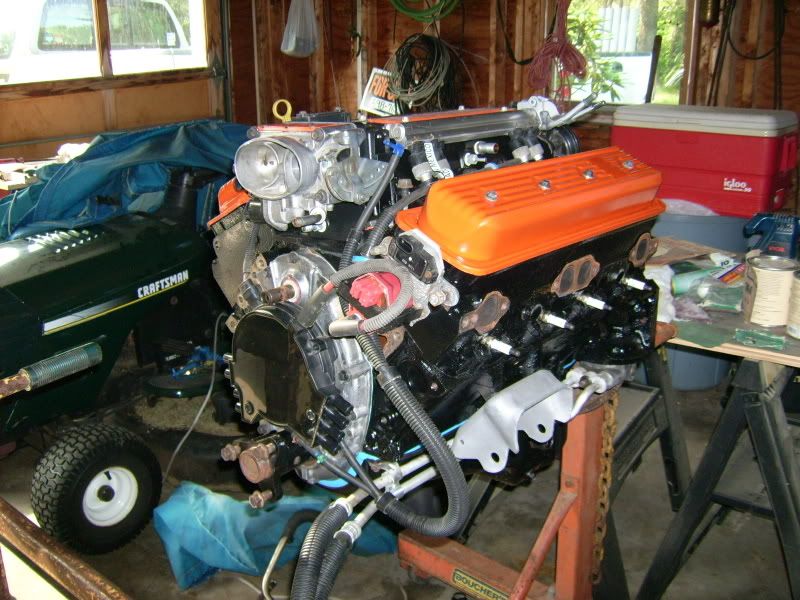

Replacement engine
Mistake two and three: did not keep the engine clean, and did not change oil after initial start up on the replacement engine. This is more simple. When you re gasket an engine. It is very important to keep any debris out of the engine. and after running it for a short time, change the oil and filter again before going to high rpm's, this will allow any debris to get suspended in the oil, and make their way back to the filter. I really think debris took this engine out.
