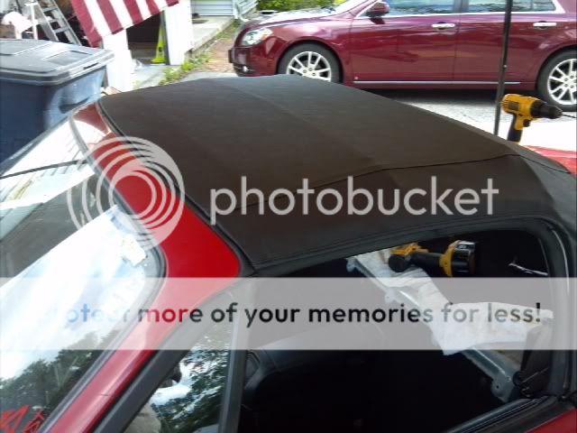

I laid the new top on, just to be sure. Then I laid it in the sun to stretch.
Installed the eBay $159 top on the Miaturd today...  2012-06-09101416

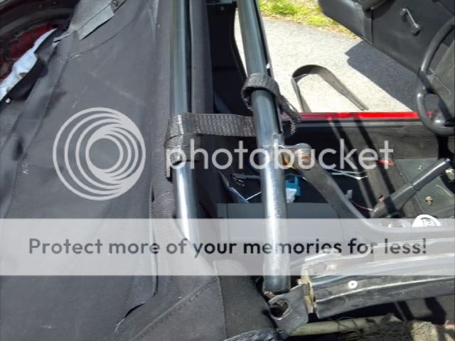

And start putting it back on. I struggled with that damn B-pillar for a while. That was probably the hardest part of the whole deal. The bottom clip, the screw and the two pushpins on the rubber. Ugh. Hated it. lol
Installed the eBay $159 top on the Miaturd today...  2012-06-09125610
I used the middle screw temporarily to hold the top to the pillar while I effed with the base of that B-pillar. Then I riveted it in place once I had things where they needed to be. Make sure your tension cable is routed correctly before you rivet it!
Installed the eBay $159 top on the Miaturd today...  2012-06-09151128

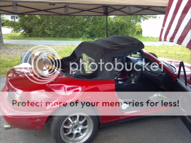

And here it is! Almost done! I have attached the back and rain rail stuff. It wasn't as bad as I was led to believe. See the 90* corner at the top of the side window? Nice and smooth. Remember that.
Installed the eBay $159 top on the Miaturd today...  2012-06-09170705

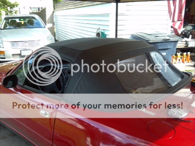

See this window? The top has a wrinkle in at that 90*... I screwed up somehow. I guess I wasn't paying enough attention on that side when routing the cable. I need to pull the moldings and their channels off and see if I can make it a little better. Bummer.
Installed the eBay $159 top on the Miaturd today...  2012-06-09170719
Nicey nice!

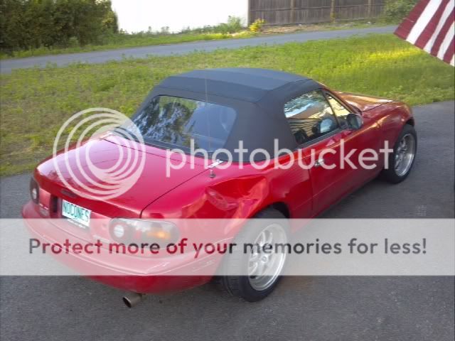

And here it is, all done.
Installed the eBay $159 top on the Miaturd today...  2012-06-09185131
