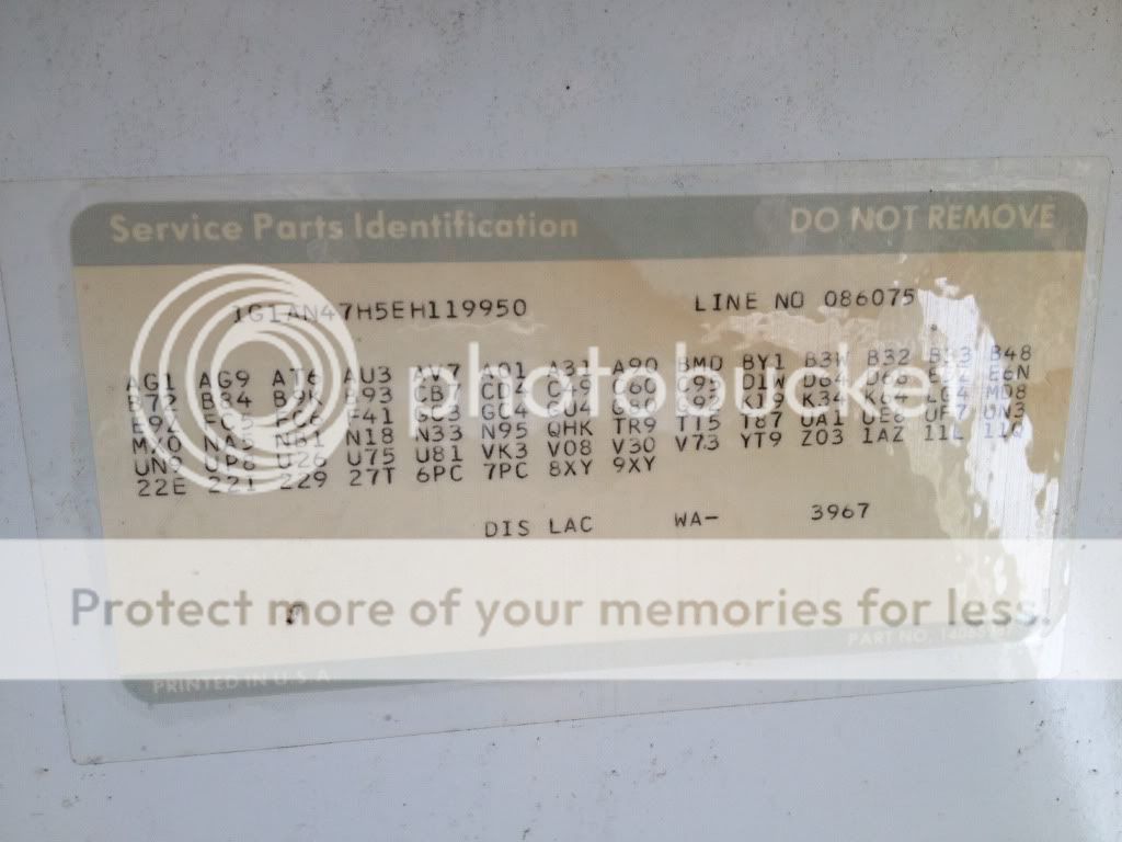

| It says G80, but I want to know the ratio. Posi would be nice in my bolt pattern, but a 2.56 posi is kind of lame [img] [/img] If anyone can tell me the gear ratio on this car I'd be happy And yes I tried to run it through compnine, and like every box I've tried to run through compnine...they give me nothing. TIA! | |

| - GasTT wrote:
- 3.08
Thank you! And explain? Which one says the gear ratio, there is obviously a diagram to show how to read these and I've never found it So a 3.08 posi rear..hmm Looks like I'm going to have to find out if it's in good shape. Thanks again Tim. | |

| - 1984twodoor wrote:
- GasTT wrote:
- 3.08
Thank you! And explain? GU4 is 3.08. Also, G92 is "performance" ratio. | |

| I'll add two more that I know of:
GU2 2.73's GW9 2.93's

| G44 Axle Rear 3.07 Ratio G72 Axle Rear, 2.14 Ratio G74 Heavy Duty Suspension G75 Axle Rear, 3.62 Ratio G76 Positraction Rear G80 Axle Positraction, Limited Slip G81 Positraction Rear Axle G82 Axle Rear, 4.56 Ratio G84 Axle Rear, 4.10 Ratio G86 Axle, Rear, Limited-slip G87 Ring Gear, 8.50 Inch G89 Ring Gear, 7.50 Inch G91 Special Highway Rear Axle Ratio 3.08 G92 Axle Rear Ratio, Performance G94 Axle Rear, 3.31 Ratio G96 Axle Rear, 3.55 Ratio G97 Axle Rear, 2.73 Ratio GH0 Axle Rear, 3.54 Ratio GH2 Axle Rear, 2.29 Ratio GH3 Axle Rear, 2.77 Ratio GH4 Axle Rear, 2.92 Ratio GK9 Axle Rear, 4.63 Ratio GL3 Axle Rear, 6.17 Ratio GM1 Axle Rear, 2.59 Ratio GM3 Axle Rear, 3.45 Ratio GM8 Axle Rear, 2.56 Ratio GN9 Axle Rear, 4.11 Ratio GS1 Axle Rear, 2.73 Ratio GS3 Axle Rear, 3.73 Ratio GS4 Axle Rear, 3.70 Ratio GS5 Axle Rear, 4.11 Ratio GS6 Axle Rear, 4.56 Ratio GT1 Axle Rear, 2.56 Ratio GT2 Axle Rear, 2.29 Ratio GT4 Axle Rear, 3.73 Ratio (dup With 5 X 1) GT5 Axle Rear, 4.10 Ratio (dup With Gt8) GT7 Axle Rear, 3.33 Ratio GT8 Axle Rear, 4.10 Ratio (dup With Gt5) GTY Axle, Wide Track GU1 Axle Rear, 2.41 Ratio GU2 Axle Rear, 2.73 Ratio G75 Axle Rear, 3.62 Ratio G76 Positraction Rear G80 Axle Positraction, Limited Slip G81 Positraction Rear Axle G82 Axle Rear, 4.56 Ratio G84 Axle Rear, 4.10 Ratio G86 Axle, Rear, Limited-slip G87 Ring Gear, 8.50 Inch G89 Ring Gear, 7.50 Inch G91 Special Highway Rear Axle Ratio 3.08 G92 Axle Rear Ratio, Performance G94 Axle Rear, 3.31 Ratio G95 Axle Rear Ratio, Economy G96 Axle Rear, 3.55 Ratio G97 Axle Rear, 2.73 Ratio GU4 Axle Rear, 3.08 Ratio GU5 Axle Rear, 3.23 Ratio GU6 Axle Rear, 3.42 Ratio GV1 Axle Rear, 2.73 Ratio GV2 Axle Rear, 5.83 Ratio GV3 Axle Rear, 3.08 Ratio GV4 Axle Rear, 3.36 Ratio GV5 Axle Rear, 3.55 Ratio GV7 Axle Rear, 4.11 Ratio GV8 Axle Rear, 2.72 Ratio GW2 Axle Rear, 2.56 Ratio GW3 Axle Rear, 2.56 Ratio GW4 Axle Rear, 3.31 Ratio GW5 Axle Rear, 2.73 Ratio GW6 Axle Rear, 3.27 Ratio GW8 Axle Rear, 4.10 Ratio GW9 Axle Rear, 2.93 Ratio | |
