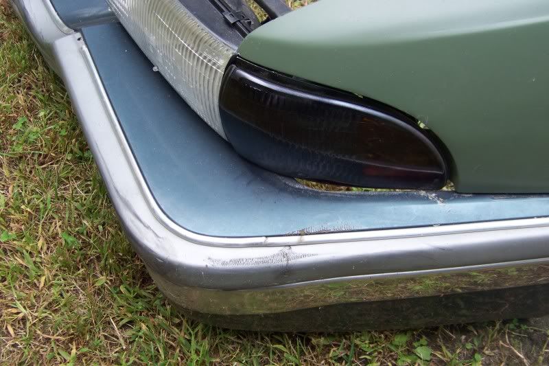

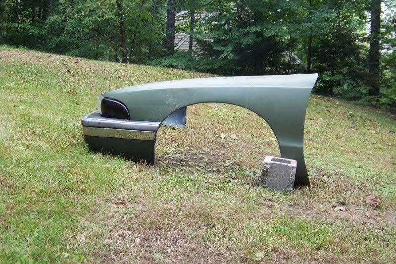

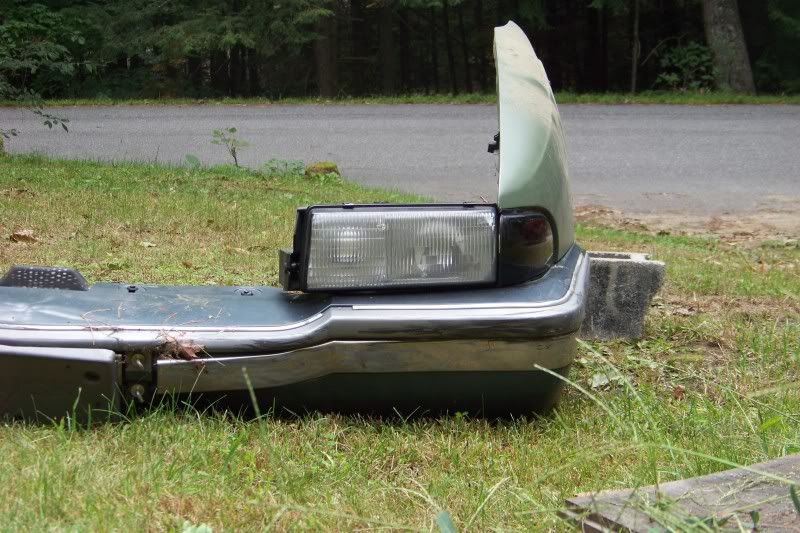

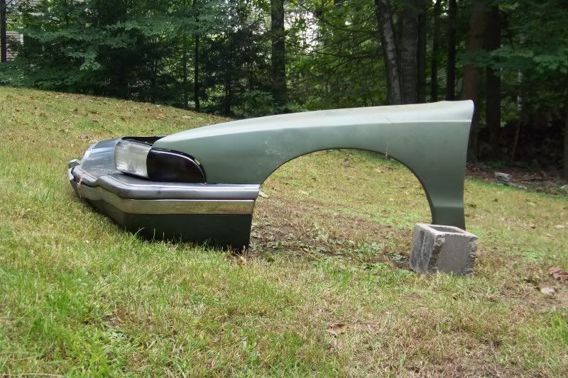

ok so your going to need to use your imagination here a little
but i think youll get the idea.
the bumper cover in the pic is a spare i have, so if youd like to try it out lmk.
Caprice with RMS bumper cover 100_5796
Caprice with RMS bumper cover 100_5795
Caprice with RMS bumper cover 100_5800
its not perfectly aligned, but im pretty sure there will be a gap here permanetly.

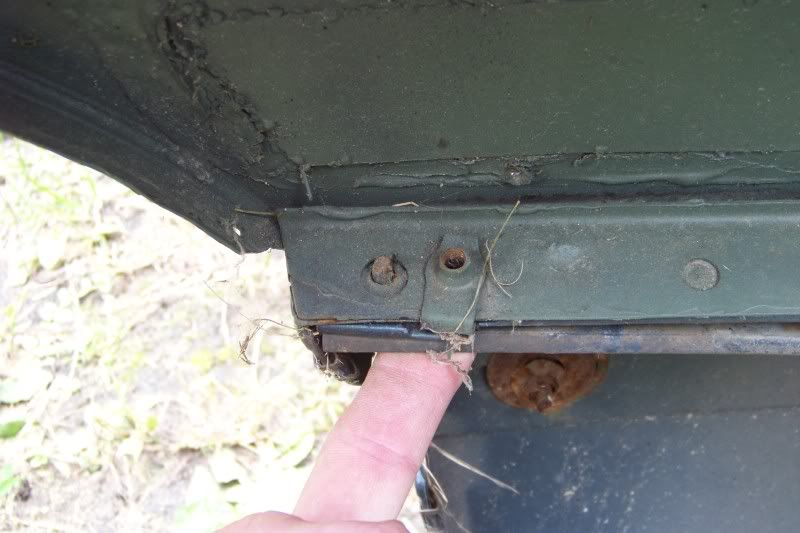

the back pin and clip/nut thing line up in the back.
Caprice with RMS bumper cover 100_5798

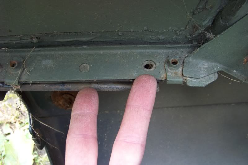

left finger area would need to be drilled to allow the other pin to come through.
right finger just needs that clip/nut moved to the left where my finger is.
Caprice with RMS bumper cover 100_5799
hope that helps a little.

It looks like it will work close to what I'm looking to do. Where would I have to modify the grill? I would guess the bottom. If so, I've got a bullet proof idea for that. Thanks for the time you put into taking the pics. I really appreciate your help! Next step is to get a cheapo, decent shape, bumper cover.
