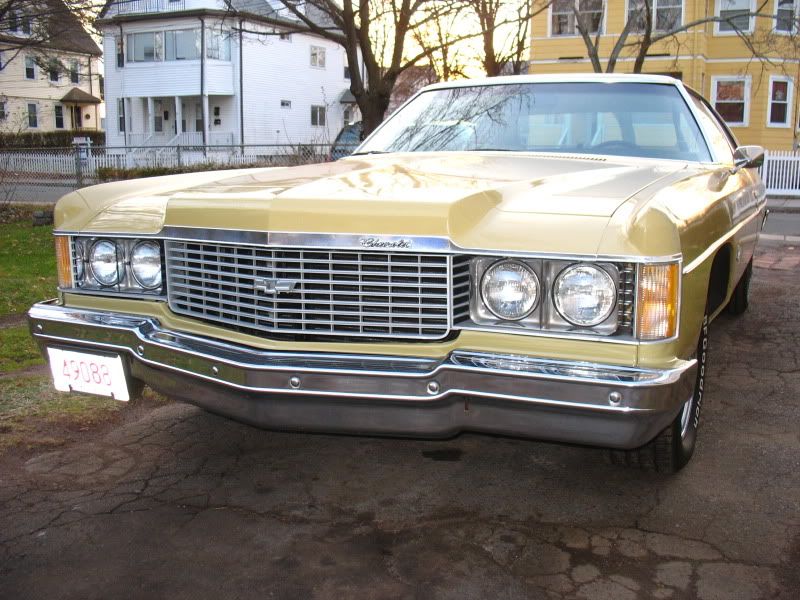

Um, yeah.
My buddy Carl shot the replacements for me. The damn paint cost 125 bucks! Apparently no cars have been painted the color of a Twinkie or Lady Kenmore washing machine in several decades...so...
They were trashed before, but not broken. The front one came off a wagon in the middle of nowhere Montana back in like 2003 (it looked like it had latex paint on it), the rear was from an eBay auction out of Missouri, the front corner ones came from the same guy in Montana, and I forget where the rear corner ones are from. I did not want to use the fiberglass ones, because the sizes are all wrong and require all sorts of prep and cutting. I have a front corner one I had bought just in case for my last Impala, and it looks ridiculous.
Some other body guy that painted the side of my truck told me to sand all the paint completely off them with 80 GRIT paper! I almost think he was screwing with me. I didn't use that, maybe 180. That was still too rough. Come to find you should leave the previous paint on there if it's still good. Hopefully this paint won't react with the bare, 35ish year old urethane and make them fall apart. My friend primed them with something, plastic welded a few trouble spots, and smoothed out a lot of crappy areas. They came out pretty nice for what they were.
These were a PAIN. Not totally frozen but the position sucked and I needed a cheater bar and a 3/8 drive, couldn't even use my breaker bar other than busting them loose. A rust fleck fell off the back of the bumper and went in my ear canal! Laughing
Of course, because it was ME doing this, the 5 billion pound bumper fell off the jack when I removed it and rolled down the arm of it. Nothing got damaged though. This bumper must weigh three times as much as a 1980s boxy bumper with the aluminum reinforcement. I wish I saved the mint shape rear bumper from my old green one, this has a couple dings and a small rot spot in it.

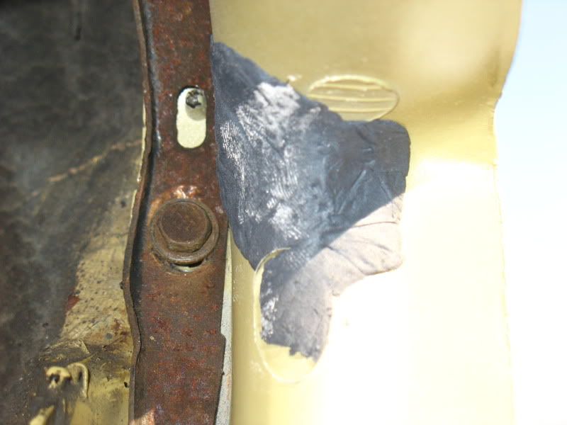

^I thought it was interesting how both the rear of the frame and the body itself are notched for dual exhaust outlets.
The old fillers completely crumbled into a million pieces when I took the bumper off. I called it a day and put all the tools away because the paint on the "new" ones seems a little fragile, so I'm letting them sit in my house for a few days. I'll take the front bumper off next, that shouldn't be as hard.
If these fillers fall apart too, I AM tucking the bumpers! I have a pic of a car like mine with it done on my hard drive at home I'll post sometime. It doesn't look all that terrible.

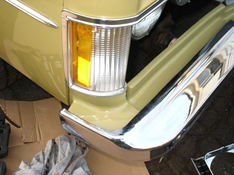

I did some more work today. Can I just say that this is a genuine pain in the ass? I almost want to just trade this car for a really nice SS and be done with this nonsense. Laughing
Seriously though, this sucks. I started by putting the corner fillers on the back. Apparently, when these cars were built, they just made the fillers and metal braces for them however they wanted, then some clown randomly shot screws into the body of the car, right in a nice area to cause rot, to hold the fillers on. Stupid. This means that fillers from another 74 Impala made next in line from mine may not even fit on my car right. Like how these don't. Laughing
I got one put together, tried to put it on, no good, I had to start each screw using the Impala's original metal braces to do the best to make them fit. This cracked the paint in spots, and even the fillers themselves. On one, a big web of cracks appeared, so I smeared some Quiksteel on the back to try and strengthen it. I think this effect was because of the whole sanding down the paint to nothing beforehand and then working with bare urethane, maybe a chem. reaction.
FWIW, they still aren't brittle, and I think I can use them. They're just fragile when you're ramming tools into them. The old ones hardened into this black volcanic glass looking stuff and literally blew apart on the highway as I drove.
Got the old crappy broken filler off the back bumper:
Replaced:
This is when it started to suck really bad. You know it sucks when you don't even bother to take any more photos.
Tried to put the bumper back on, it doesn't fit onto the car past the fillers! So after much wrangling and almost destroying the things, I took the corner fillers back off the car (which is a pain, because the screws I had to fiddle with for a half an hour are also almost impossible to get a mini-socket onto), and just put the bumper back on (loose) with it's filler installed. That filler actually looks pretty nice on the car.
I think I'm going to try and just put the corner ones back on with the bumper half-ass installed so I have wiggle room, do the best I can, even if I can't get all the screws into them, then adjust and tighten the bumper.
And, I'm planning to install the fronts with the front bumper in place. I can at least take out the grille and headlight bezels for that, I took all the old stuff off a long time ago with the bumper still on.

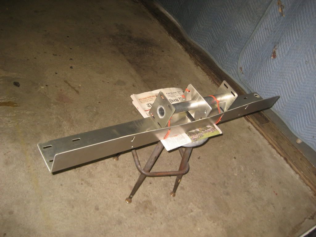

If I were to tuck the bumpers, this is what I'd be dealing with.
Has anyone ever done, or heard of, drilling holes in the pistons for the bumper shocks to let the pressure out, then putting the car against a building, with tires or towels in between, and then putting it in drive to mush the bumpers in gently? Someone told me that.

I think if I WERE to tuck the bumpers in, I'd like to have a backup set of bumper shocks so I could put it back the way it was...or I wonder how hard it would be to have some kind of bracket made to supplant the shocks? Cool
If you knew someone in manufacturing that wasnt to far from you it'd be relatively easy. scratch

Start measuring
Looks like 2 rectangular plates with appropriate holes & 1 X Dia pipe cut to length as a spacer & welded.
Because its a race car, I'm assuming you'd choose aluminum
You've got all winter to get er done

I believe the guy would have to make it out of AT LEAST 1/4" plate, but I'd use 5/16" or 3/8" and the tube, if aluminum, should be 4" diameter 1/4" wall T6 heat treat, then welded on both sides of the tube. Then I would trust it. Of course THAT would weigh more than the ones in the picture but they would be accurate, new, lighter than stock, affordable, & yes, strong enough. Probably just as well to make them out of hot rolled steel, cheap, strong and even more affordable than aluminum.
