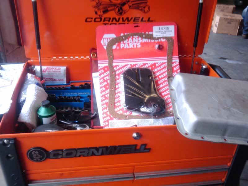

Slow day at work today, cleaned the Pan, changed the filter & gasket. Also changed the seal behind the TC, the pinion seal on the tailshaft, and the seal for the tailshaft housing.
