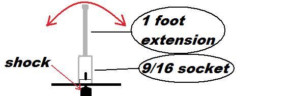

OK so if the post on the top where its threaded and supposed to have a hex head is stripped and corroded, how should I go about removing it?
If I jack up the lower control arm can I sneak a sawzall in there where the rubber bushing is to chop it off?
Front shocks Empty
PostSubject: Re: Front shocks   Front shocks EmptyThu Sep 23, 2010 7:39 pm
Take a deep 9/16 socket and at least a one foot extension. Place this combo over the top shock bolt, and go back and forth until the stud fractures.
This should take less than five minutes to do both sides.

I tried that didn't work. Ended up using a tiny grinding wheel and ground the nut off.

I have done it several times, and it has never failed. I have had some fracture quicker than others, but I have a 100% success rate with that method.

OK so bending it back and forth didn't work so well. I ended up raising the suspension with a block of wood and a jack. Then I snuck a sawzall blade in there and hacked it off. New front shocks are in. I'm pretty sure everything on this car is original. Even the exhaust is all original.. which is starting to fall off due to broken stuff. Next up: rear air shocks.

I torched one off and my buddy wrenched on the top nut until the stud broke off....
Just torch em both off

I cut them out with a sawzall. I think I am going to brush some anti seize on it so should I ever want to replace them or remove them for any reason I want it to be easy.
