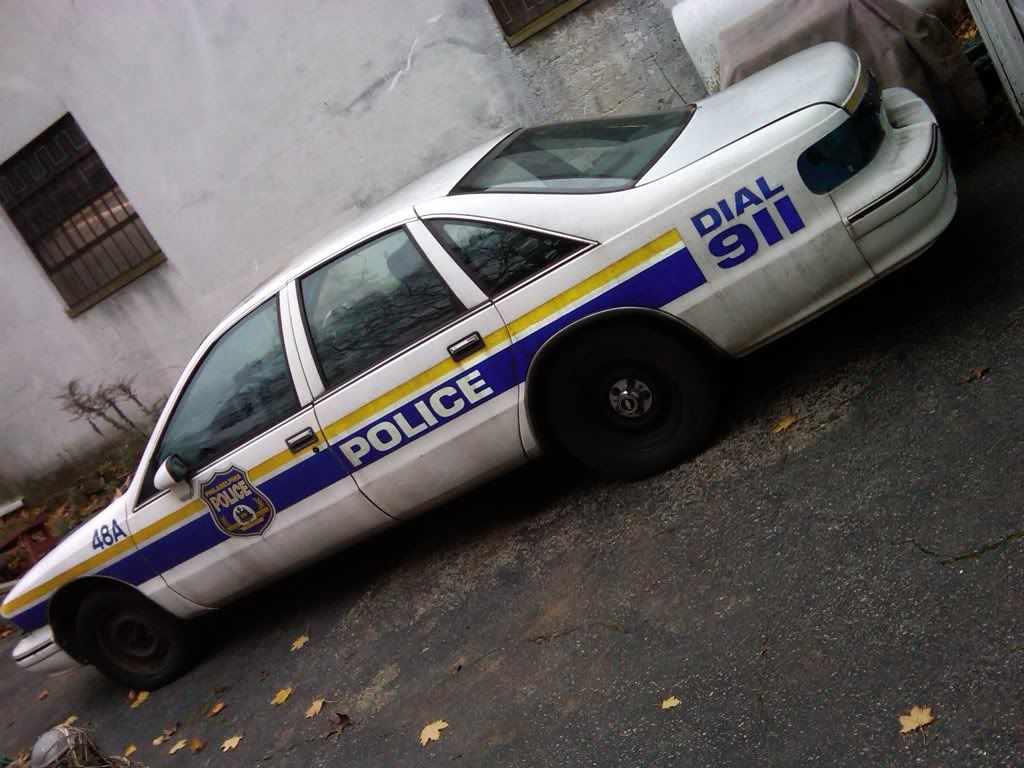

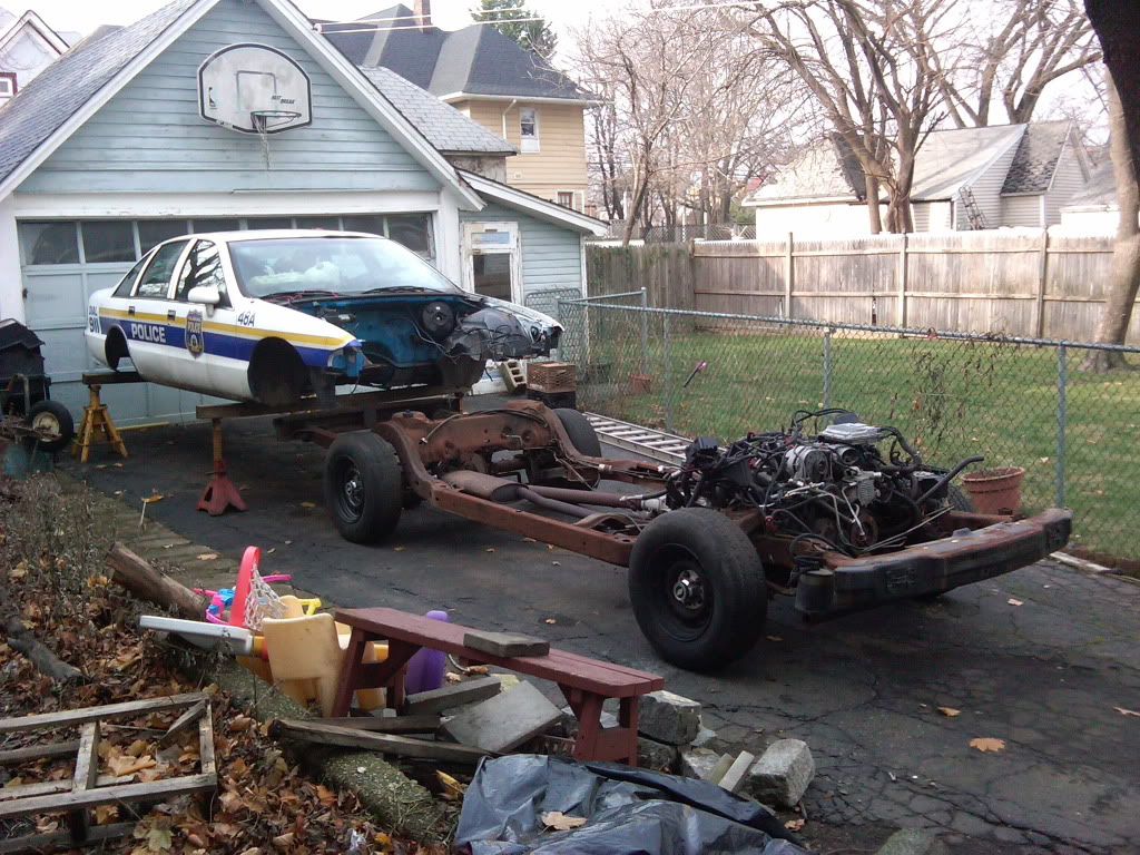

My parts car was used in movies after the previous owner sold it for more money than it would have cost him to repaint it first.
Sprint Springs IMG00315-20091215-1327
Now it is becoming the foundation for my next "sleeper" project. , , , Stay tuned!
