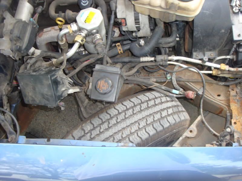

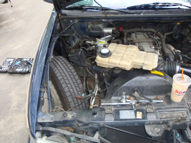

So I guess I'll just use this thread as a slow "build" thread??
Well, at Mod day at Doug's I installed the SLP air intake..
I also replaced the rear window struts i got from RockAuto..
I got something done today also..
Who says you cant pull an inner fender without removing the wheel!!
(p.s. America runs on Dunkins)
One day she'll run right.. NewCam001
One day she'll run right.. NewCam002
Here it is, back in.. Was kind of a pain in the @$$ doing it with the wheel on..
One day she'll run right.. NewCam003
What was it all for?
One day she'll run right.. NewCam004
