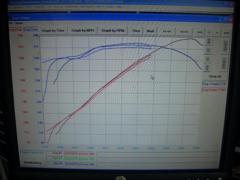

PostSubject: Re: Building an engine   Tue Feb 17, 2009 8:46 am
That is the one.
I was glued to your story over the summer. It is one of the best threads on ISSF ever. cheers
Yeah, that was a fun thread! Smile I really had a blast! And I have like 5K HARD miles on that motor and it still runs like a champ!!! I may just have built it right!!! Very Happy
An in case ya couldn't tell, NO! I don't mind at all! If anyone has questions, feel free to ask!
And check with Karl Ellwein. He's clearing out all his building supplies while he takes a year or so off to get married... I got all my rebuild parts from him. If it's just a refresh, you could do it for way less than a grand, even with a cam...
