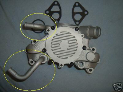

1) Do the tubes that run to the heater hose/overflow tank look like they are pressed in or welded in? I'm pretty sure the tubes are press fit since they are steel and the pump is aluminum, but I've never messed with one to find out for sure. I'm putting up the highlighted pic for those who don't get which tubes I'm talking about.

Why are you so interested in changing the dynamics of the water pump. A stock LT1 water pump is good for 100k+ miles and even rebuilt units are cheap enough. Why bring an electric drive into the equation? The tubes are pressed in.
