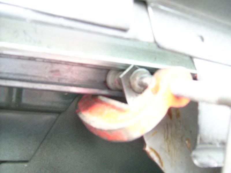

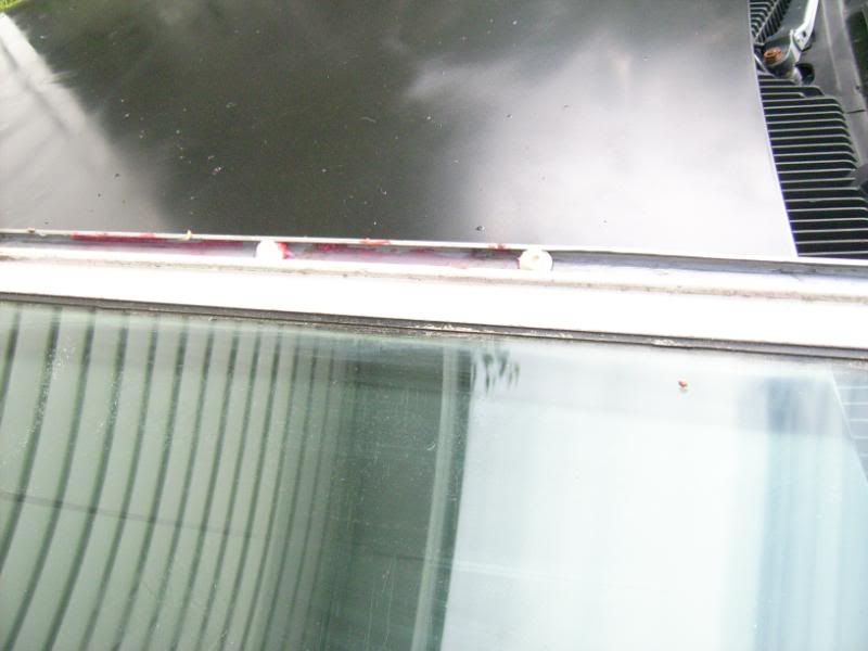

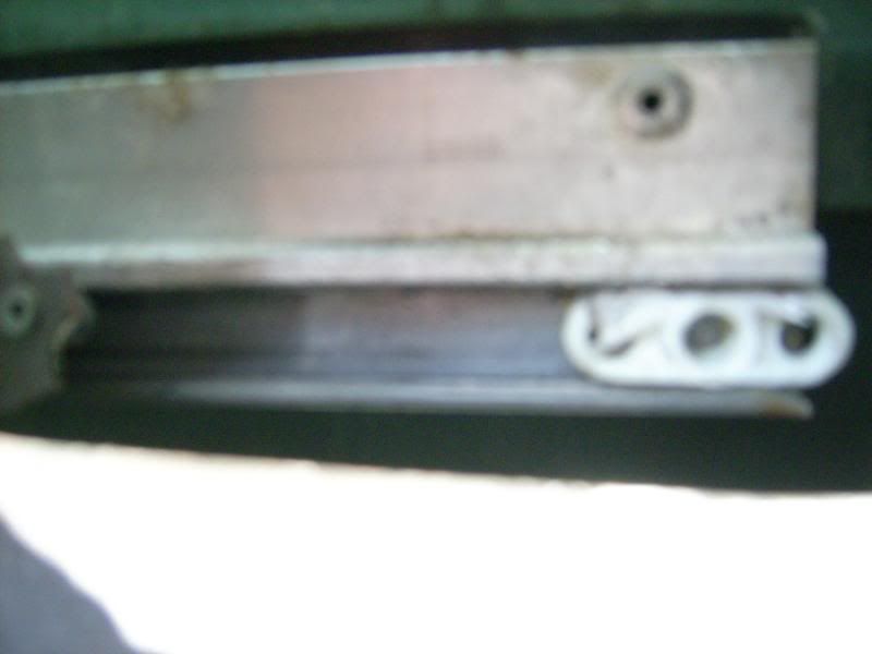

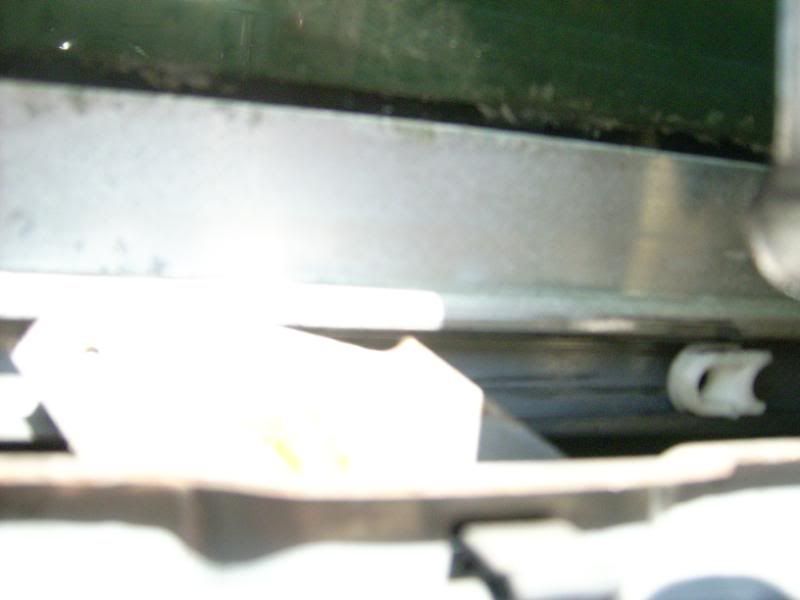

I got so sick of rolling my window down only to have it go west. So Today I took some time and installed the drivers door rollers. I still have to do the passenger rear one.
The old slider
The broken slider
Two new rollers
I pulled the glass out of the door to make it easier to install the rollers plus I wanted to take off the faded old tint.
A quick moment with a c-clamp to snap the window lift into the roller
After a good greasing she works like a charm

It's not that hard to do the fronts. The rear doors suck more since you need to work around or remove the bracket that holds the interior handle and stuff.

Good job, Billy! It's really amazing how simple those are to do!
