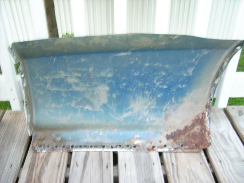

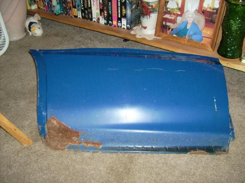

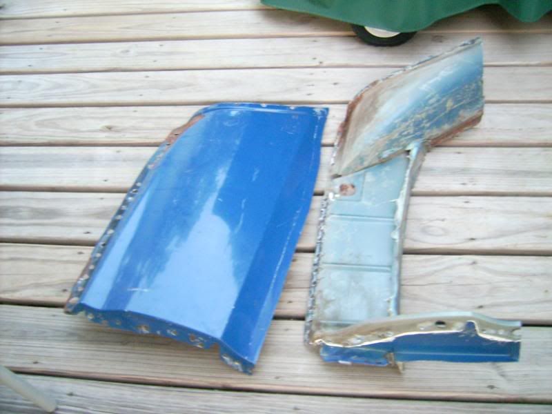

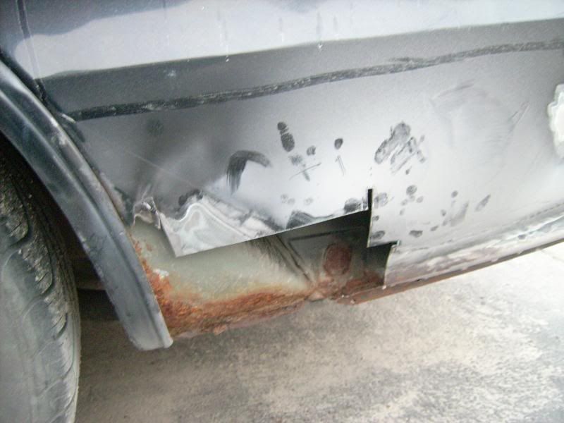

Thanks to Mr Crovo, I have a drivers side rear quarter. Over the next week or so I will be trying to find time to install it. I just need it installed to have the car ready for inspection. I will cronicle each and every step with pics.
Step 1
A reminder of the damage
The used but very solid repair panel and inner panel I will be using

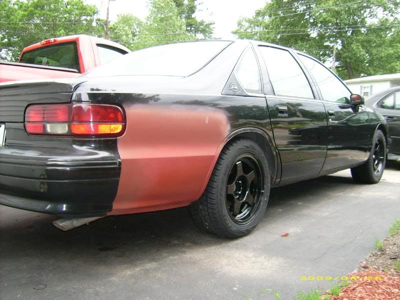

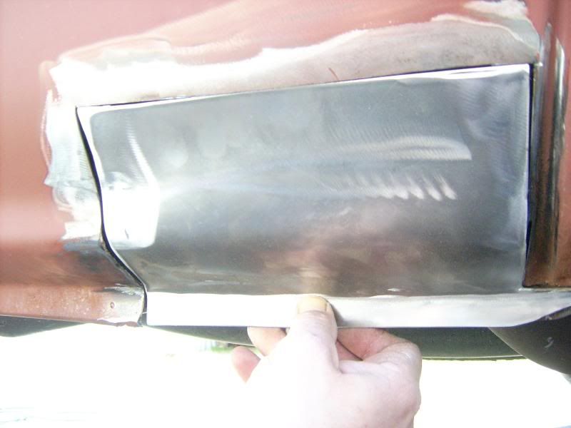

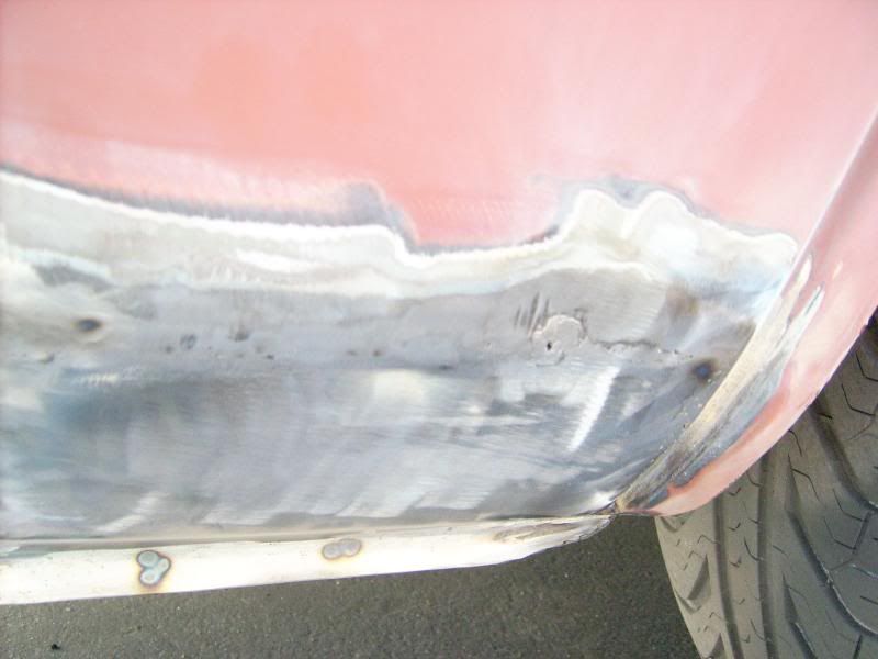

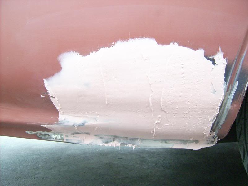

As many of you know, I did the passenger side, and it was the first patch repair I had ever done. Then I put my super skillz to work on Bill's Big Ugly. Doing both sides. So this will be number 4. And because it was so hard to get a drivers side patch, I plan on taking my time and doing it right.
When I did the passenger side, I made my own patch and was very happy with the results.
Here is a recap of my very first patch panel.
DA KID got skillz.

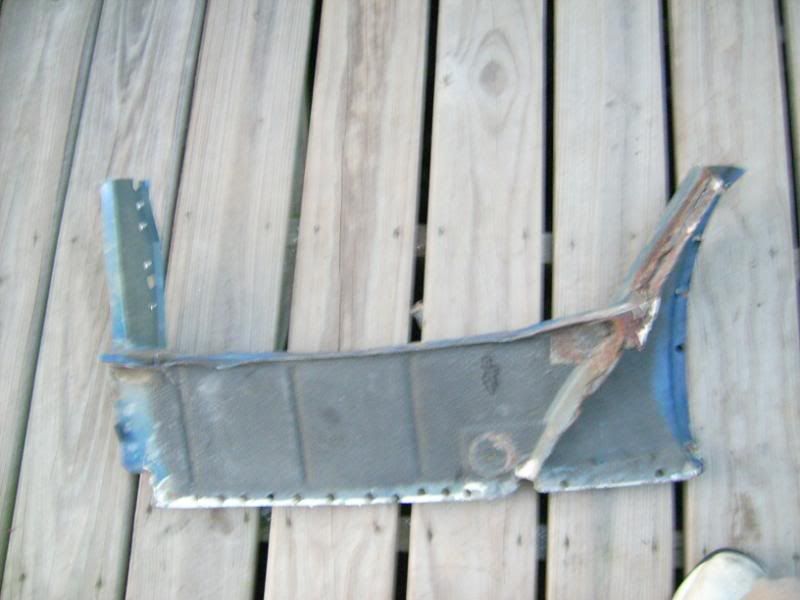

PostSubject: Re: Rotted rear quarter fix, PART 2   Sat Jul 25, 2009 1:43 pm
Had some time this morning to start seperating the outer and inner panels apart. This is the boring part but it has to be done, so I am posting pics.
Outer skin seperated.
Back side of inner skin
Inside panel

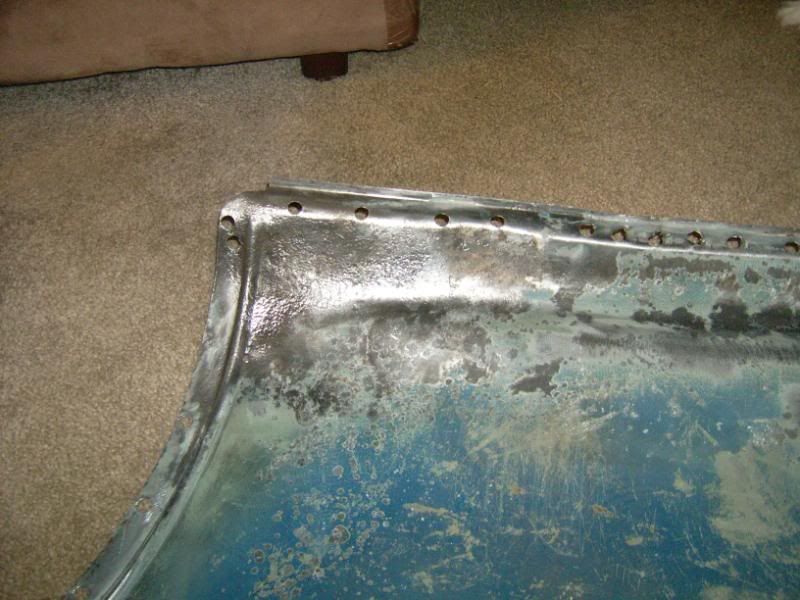

PostSubject: Re: Rotted rear quarter fix, PART 2   Tue Jul 28, 2009 1:39 pm
I finally got my battery charger back. So I decided to give the rust removal phosphate dip a try on the 1/4. I have used it many times and it removes rust well. I did some sway bars that came out so good, I was able to have them powdercoated after a good wipe down with brake cleaner.
You can almost see the bubbles from the chemical reaction

PostSubject: Re: Rotted rear quarter fix, PART 2   Wed Jul 29, 2009 10:11 am
So... was there any of the quarter left after the soak? tongue
No more Subarus. Ever. EVAR!
PostSubject: Re: Rotted rear quarter fix, PART 2   Wed Jul 29, 2009 10:36 am
Don't joke. I actually kept watching it, thinking I was going to pull it out and it would have a hole in it. But it is just surface rust. The quarter is solid. Very Happy

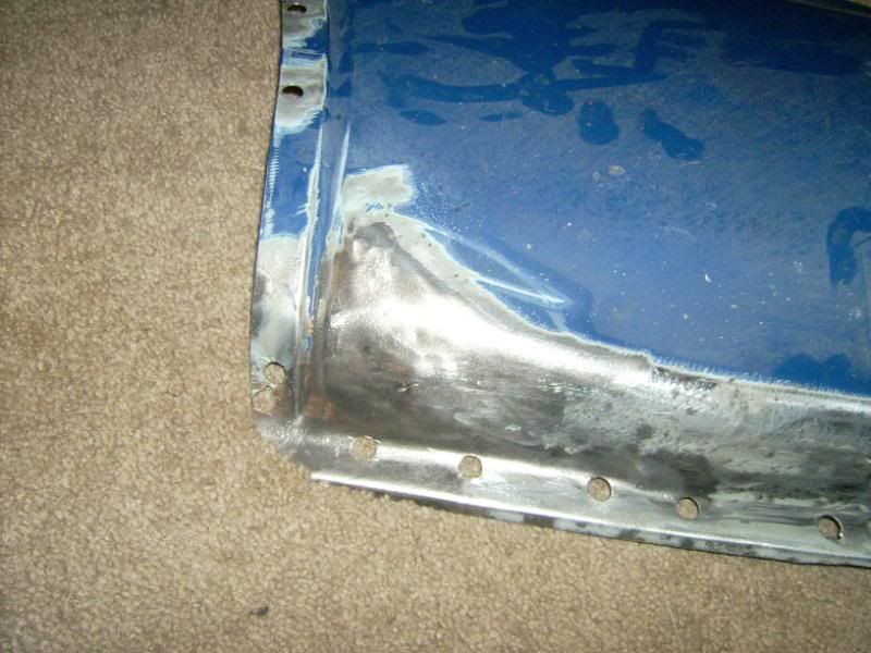

PostSubject: Re: Rotted rear quarter fix, PART 2   Fri Jul 31, 2009 11:57 am
Finally got the rust off with the dip and wire brush on my grinder. And I knocked out a two small dents. I had planned on using my sand blaster, but I had no more media.
Front
Back
