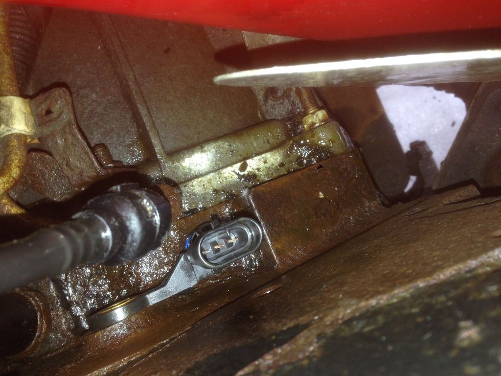

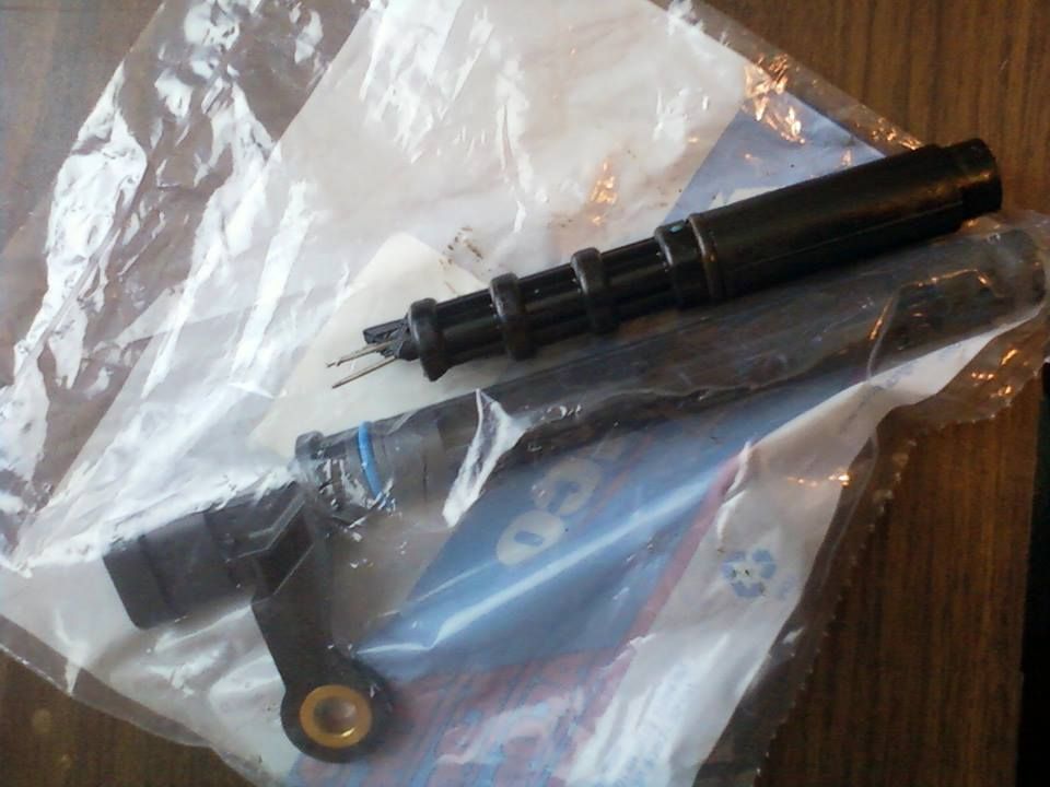

PostSubject: Re: Well what to do   Fri Mar 27, 2015 3:17 pm
Well got it done!
Got the old one out, took some ingenuity.
And new crank sensor in.
I am a bit sad that this engine won't be making it's way into the C10. Oh well, plenty of 4.8 and 5.3's out there
