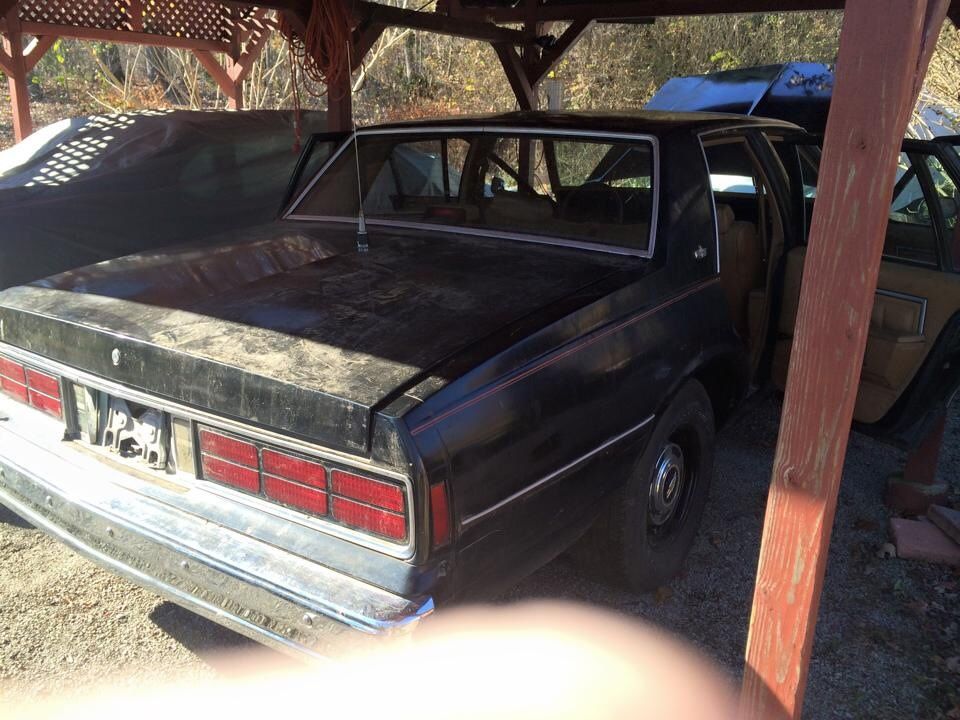

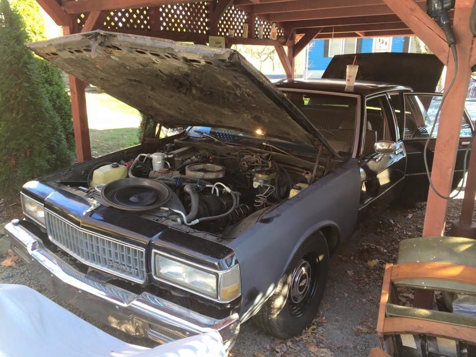

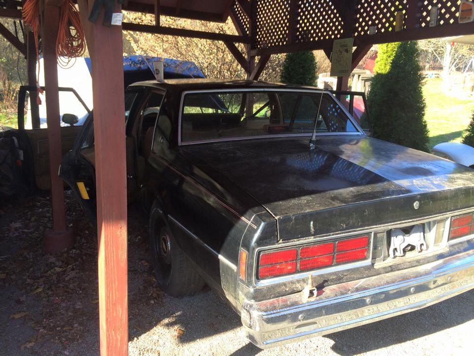

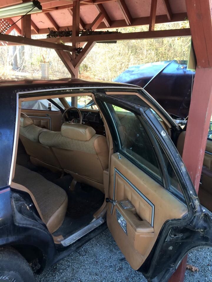

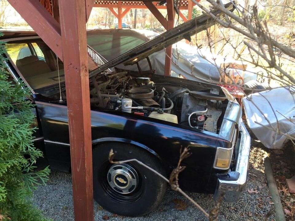

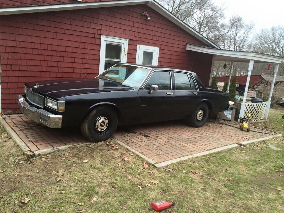

Below are pics of the car just as I parked it for winter last year. I've got all kinds of parts for this car since stripping 2 others plus 1 junk yard car. New dash piece, aux gauges, all kinds of stuff.
For obvious reasons, I've done nothing to the car besides clean it out, replace a bent hood hinge and spring I had from another car, and put $10 worth of fresh gas in the tank.

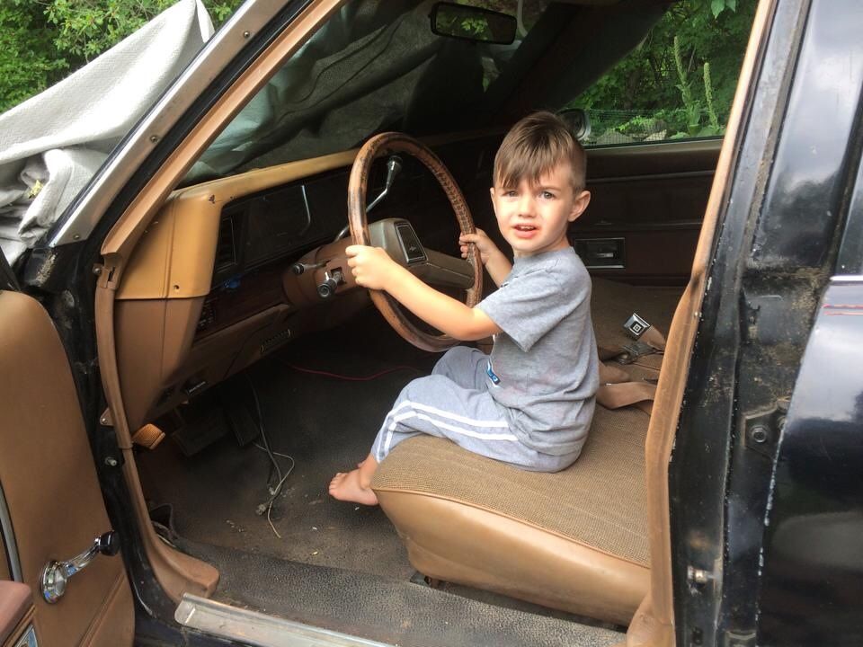

My little minion, for some reason, likes this car too.
1988 9C1 project "Sabotage" Image_zpsvnrtlvh6

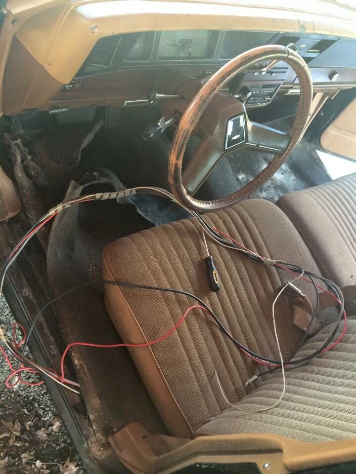

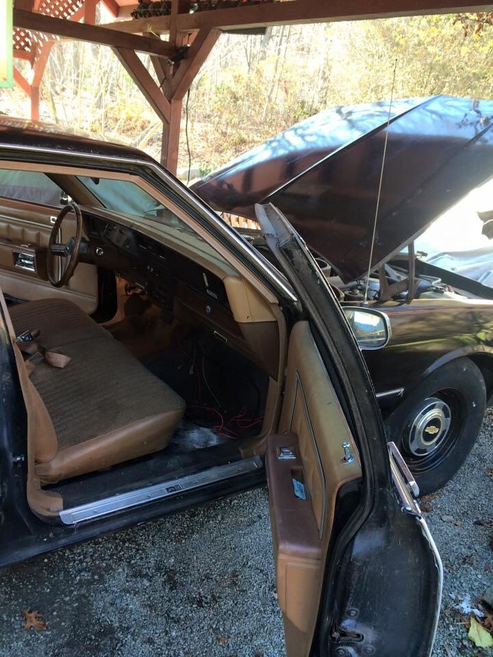

I took the sill plates off to remove all the extra radio and antenna wires hanging from under the dash.
1988 9C1 project "Sabotage" Image_zpsmjos6iro
1988 9C1 project "Sabotage" Image_zpsusa9tc2h
I removed the back seat to assist in the removal of those wires. This is the 2nd or 3rd round I've found between this and the gray parts car

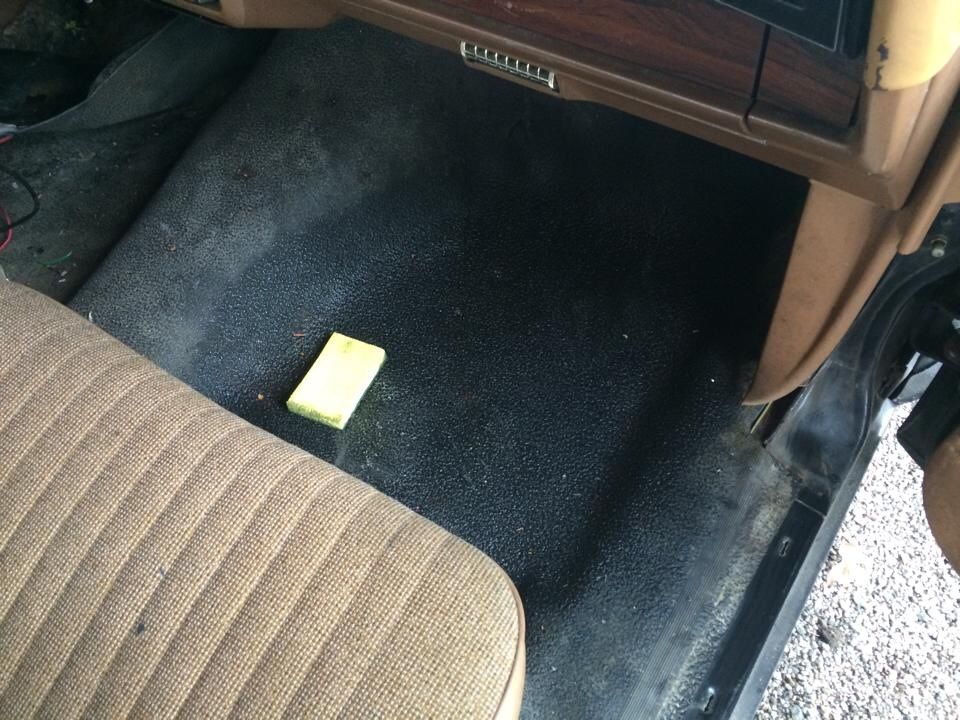

I also cleaned the passenger side floor nastiness. You can see what it looked like in previous pictures.

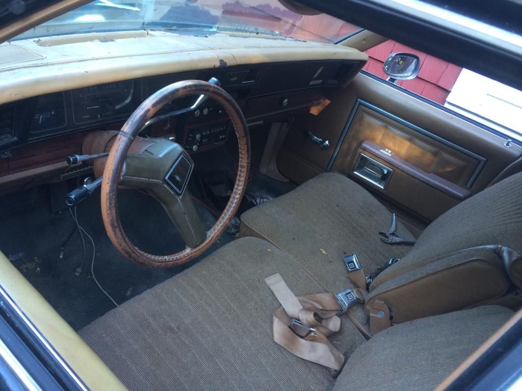

Started with the dash and the radio. The dash had several unsightly holes in it and some bad scuff marks. While I was in there, I replaced all of the instrumentation light bulbs. Haven't gotten the trunk popper or cigarette lighter to work yet tho. Still need to install the glove box, courtesy lights, and the dash top.
There was some sort of "high quality" (for the era) tape deck installed with an amp. Apparently said radio came in Cadillacs, some g body bruicks, as well as bentleys. I took all of that stuff out in favor of the proper factory connectors and stereo. Success! It all work. Aftermarket speakers previously installed.

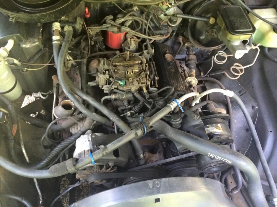

I also started cleaning out the engine bay with a vacuum and some spray and shop towels. I need to do some painting and install the correct green silicone hoses.
One of the pics shows some Buick skylark poverty caps I have. They have the same cap for Chevrolet with the bow tie instead of the tri shield logo. Looks pretty good. Not the end game tho. Not by far.

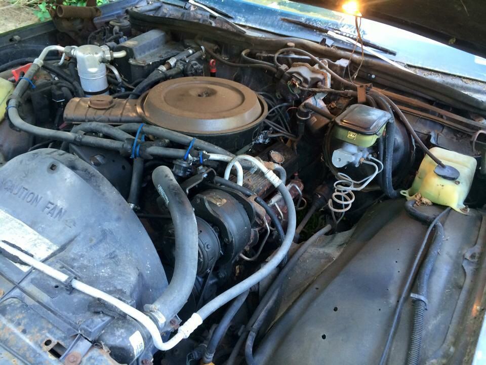

Surprised still at how clean under the hood is. Even tho it's a newer engine, I expected all kinds of rust and seized bolts. Nope. A while back I pulled AIR pump and it's associated web of wires and hoses. Both check valves snapped right off as they were rusted inside. All that's left is re run the vacuum lines and install some little brass threaded plugs once I get the injection tubes out. I'll end up with headers eventually.

Still sitting with no title. I'm still in hopes, so I did end up repairing the lower quarter rust on the drivers side and re-painted it. The whole car would eventually need more body work and complete re spray. Still has a coolness factor despite the never ending headache this has become. Hoping the next owner can really make it shine.
1988 9C1 project "Sabotage" Image_zpsnqq8ysgo
1988 9C1 project "Sabotage" Image_zpsou2umeop
1988 9C1 project "Sabotage" Image_zpspdvgrxrl
1988 9C1 project "Sabotage" Empty
PostSubject: Re: 1988 9C1 project "Sabotage"   1988 9C1 project "Sabotage" EmptyTue Oct 20, 2015 8:14 pm
Looking good, I missed a 90 9c1 a month ago up here. Needed work, but would have made a good addition to the hoard. lol
