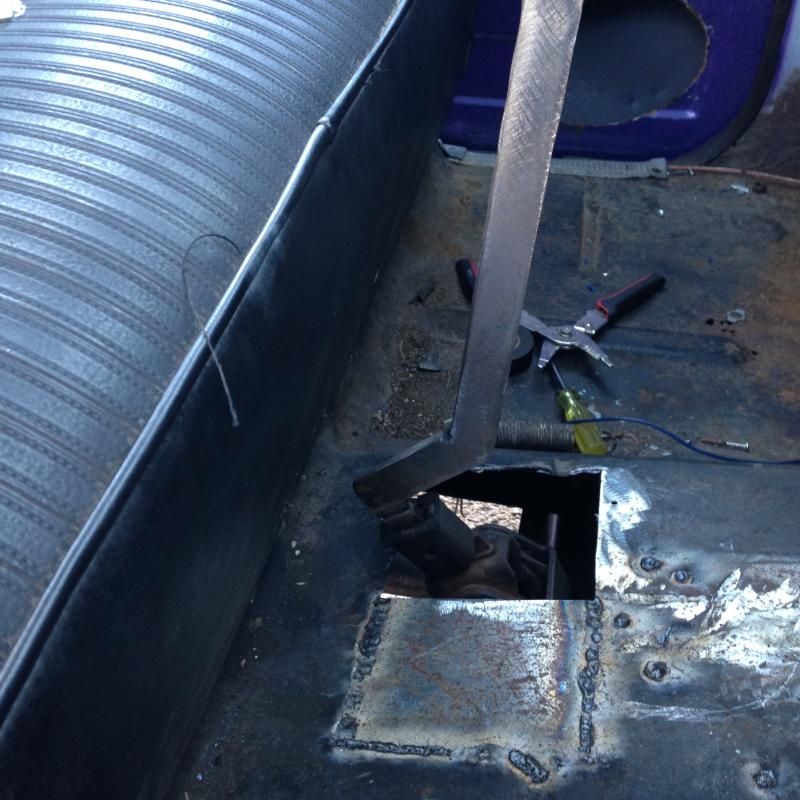

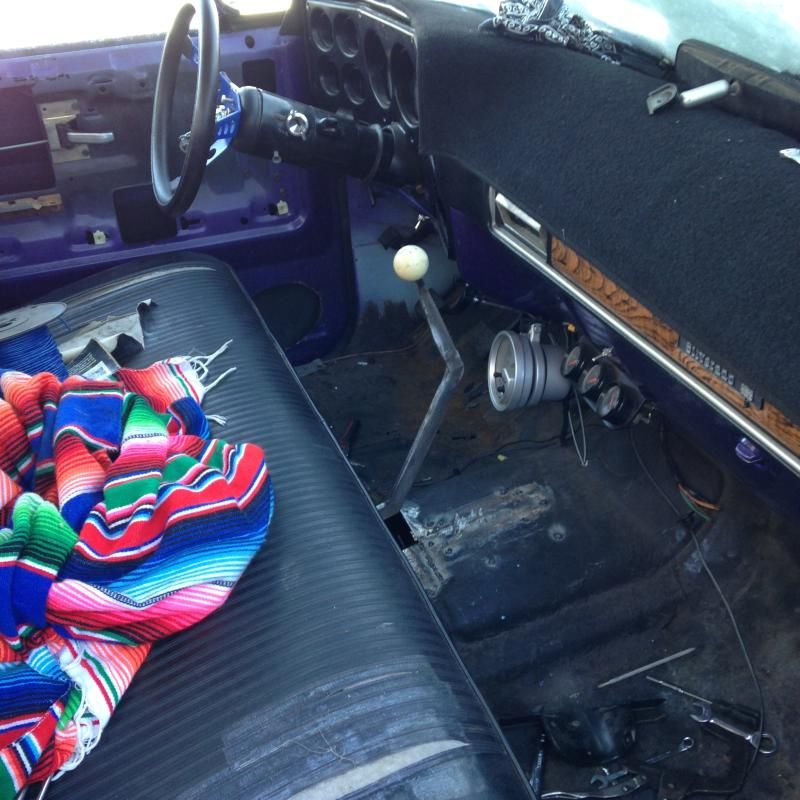

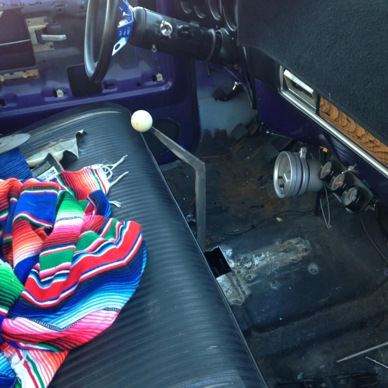

I went 4 speed route.. But essential the same involvement (minus pcm).
I'm cheap so I didn't use the f2b. I cut a b pedal assembly and welded it to an f pedal assembly.....got the same results but for $400 cheaper.
I was able to use the factory crossmember with the super t-10.
Pic of the shifter placement and pedal assembly.
If you want to retain a full bench seat you will have to buy (or if your crafty enough build) a bench seat shifter.
I built this one for a total cost of $8....
Pics of it installed in my c-10
