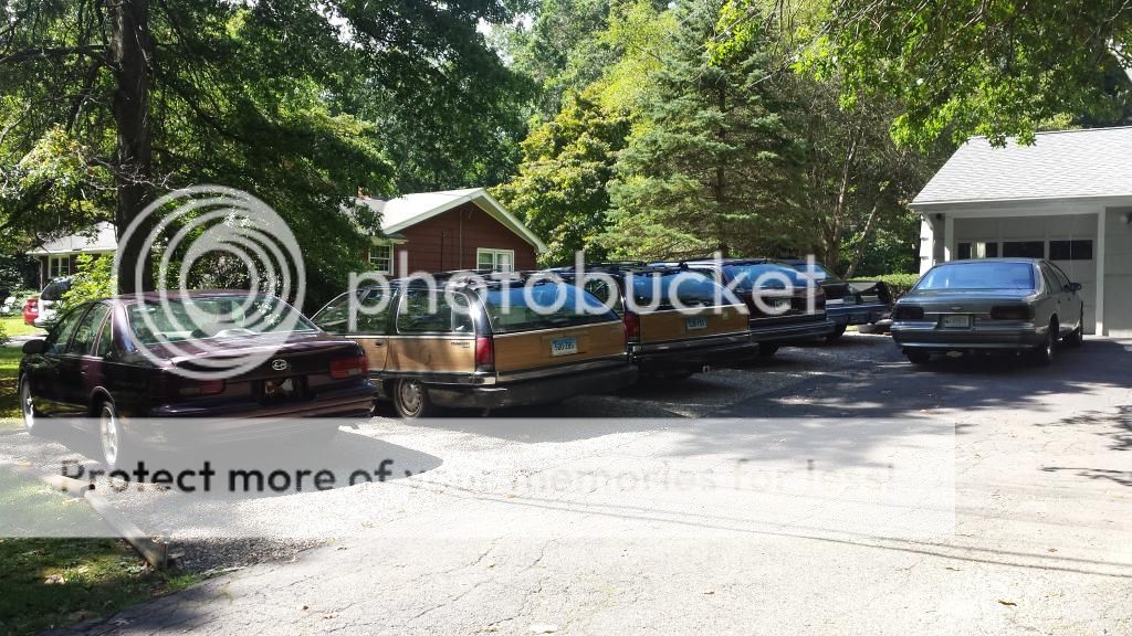

Shot of the used car lot that is my driveway this morning. I really gotta do something about this....
Posts : 1510
PostSubject: Re: Found an SS, and it's the fast color   Sun Sep 07, 2014 3:15 pm
Professional help may be necessary.

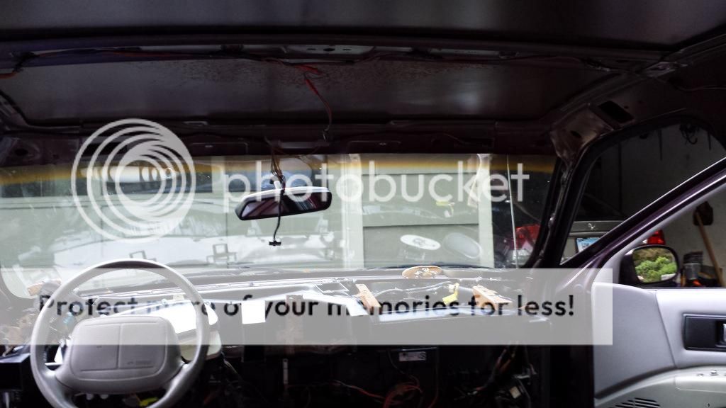

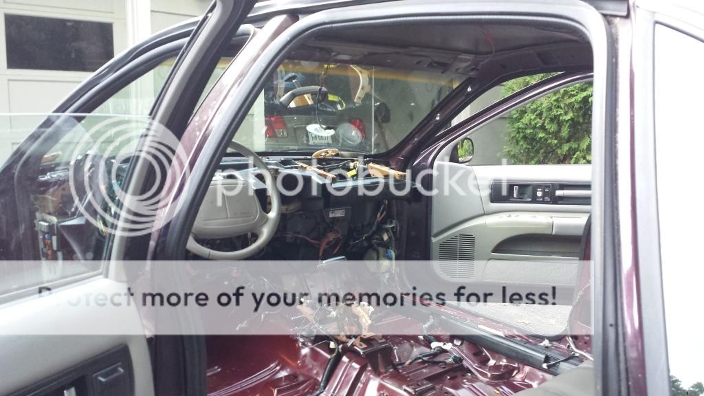

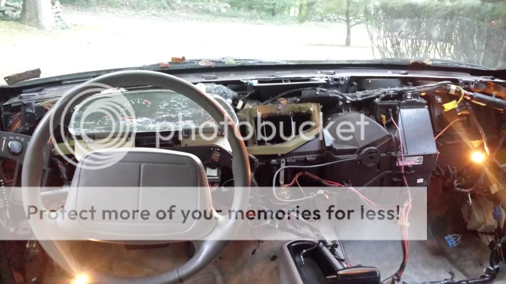

It's been a long time since I made an update on this car, and I have made some progress.
I haven't even touched the motor yet, I've been de-mousing the interior.  St this point, a shorter list would be where I didn't find mouse shit.  I found that and nest material (insulation) in the A, B, and C pillars, the rails in the roof, the trunk lid, and the list goes on.  There must have been a hell of a nest under the center console, everything is rusty there and the floor shift cable grommet has been chewed completely off.

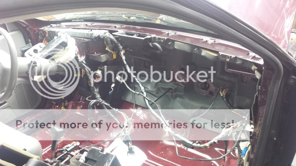

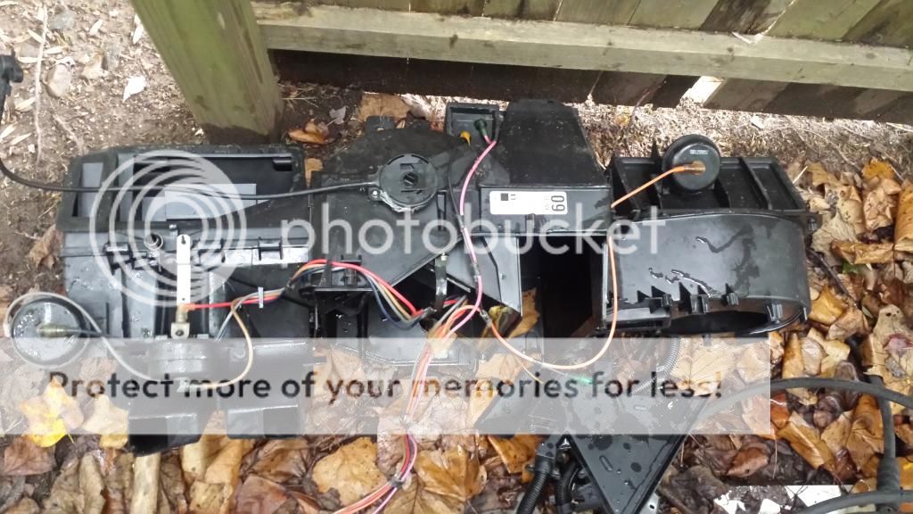

I opted to completely throw out the HVAC assembly, it was beyond nasty.  I cleaned and replaced that with a cleaner one I had from a parts wagon I had years ago.  The interior had to be completely gutted and scrubbed down with enzyme based cleaner to kill the smell.  I tried to clean the carpet but ended up throwing it out.
The more I tore into the car I found out someone had been this deep before, the insulation under the carpet was some store bought thin stuff, the headliner was duct taped together, and every bit of padding that could be thrown out was missing.
Between swap meets and trips to the junkyard I replaced the headliner, carpet, rear deck carpet, most of the interior plastic and the dash.  I had to clean the seats as SS seats are worth their weight in gold, but did manage to buy a used driver's cover to replace the torn one that also had a nest in the rear pocket.
At any rate, it smells 100x better and I can tolerate sitting in it.  Now it JUST needs the engine replaced  Twisted Evil
Pics of the progress:

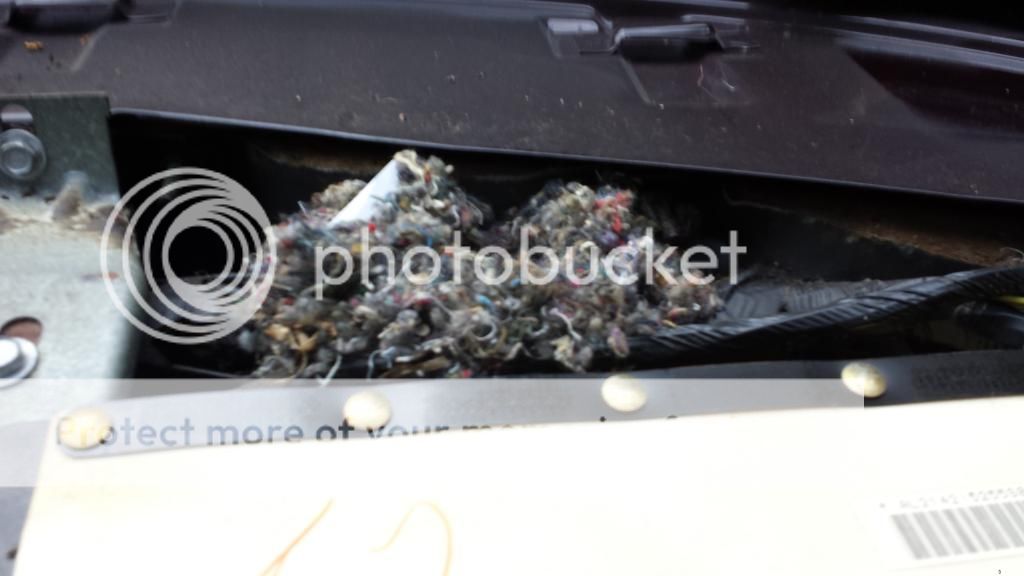

Rements of a nest and mountain of shit under the passenger air bag
Look at that chewed up foam in the center
The last time I had a B-body this stripped it was headed off to the crusher
Nasty old HVAC box
Hard to see, but there's rust on the roof from a nest that was above the headliner

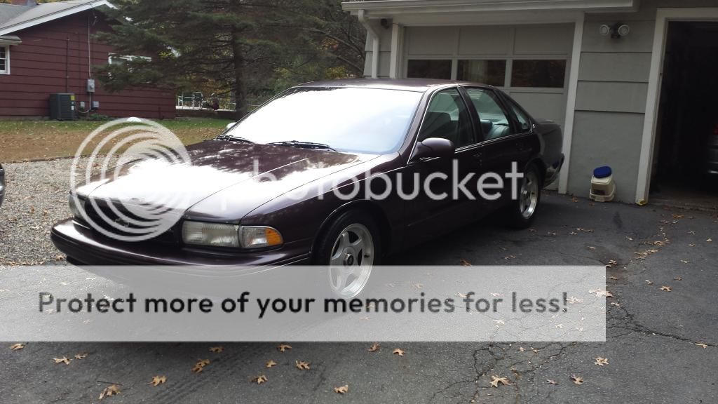

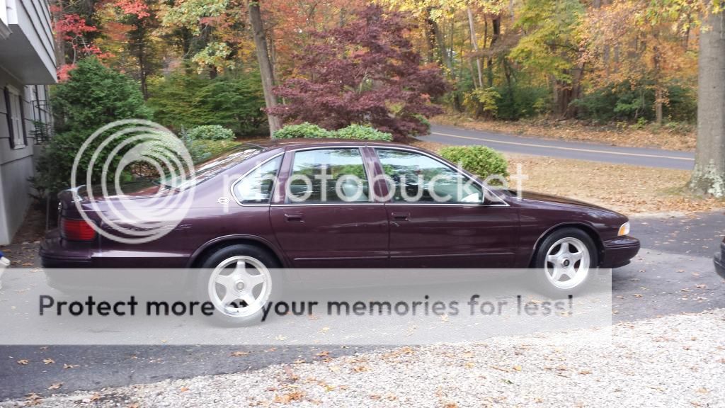

Finally had a chance to wash it today, cleans up pretty nice

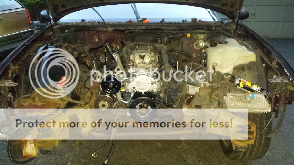

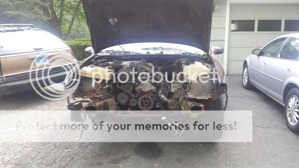

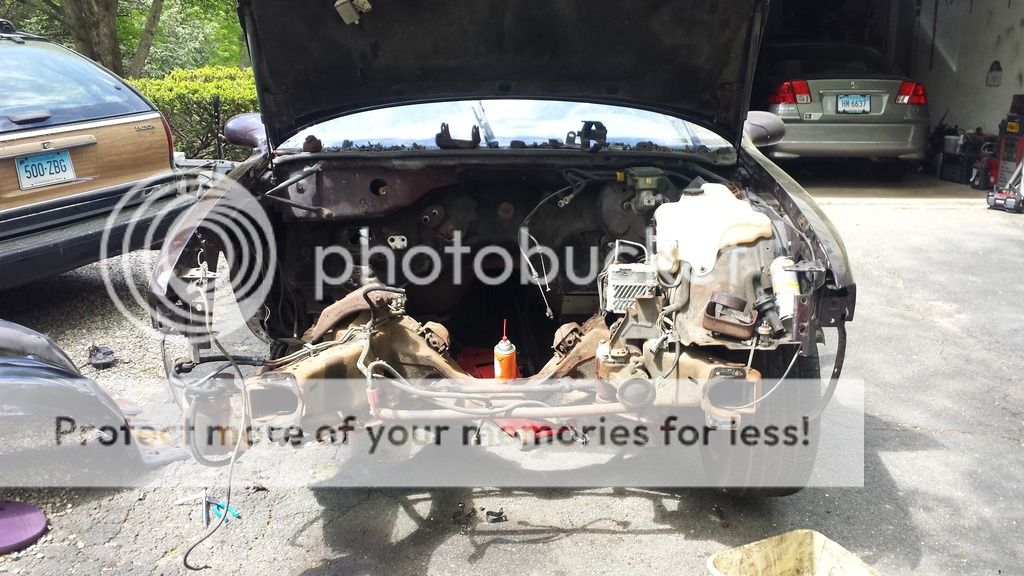

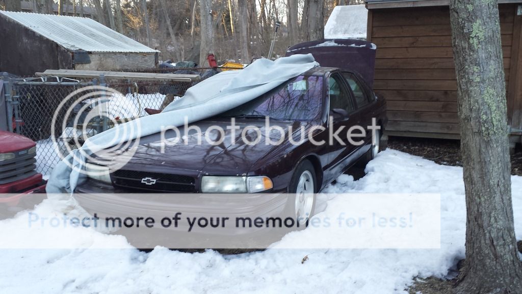

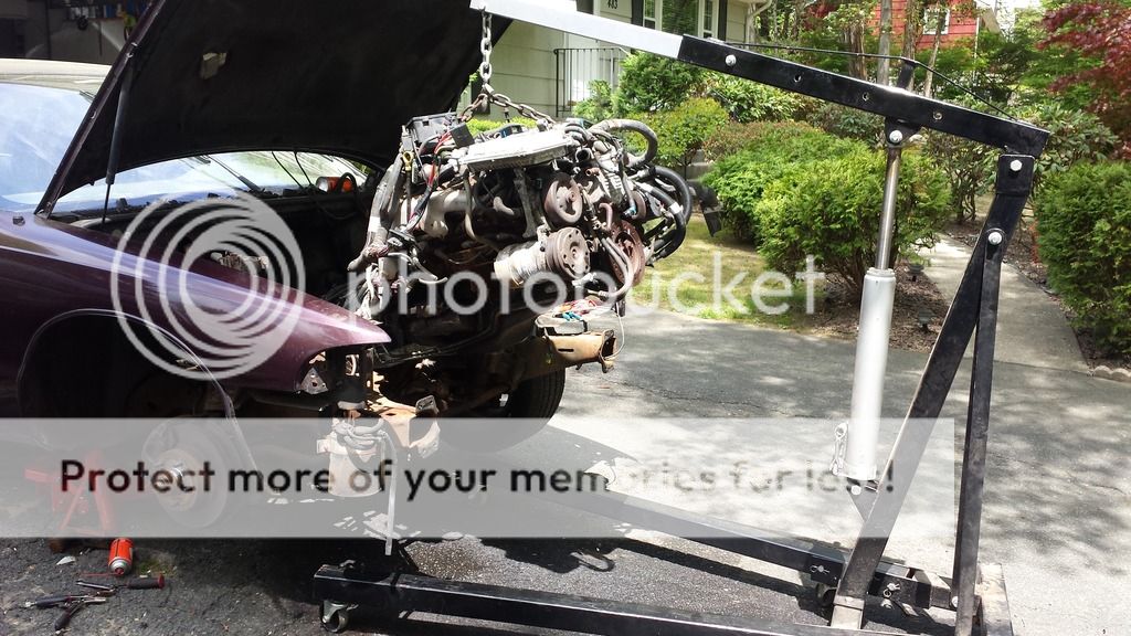

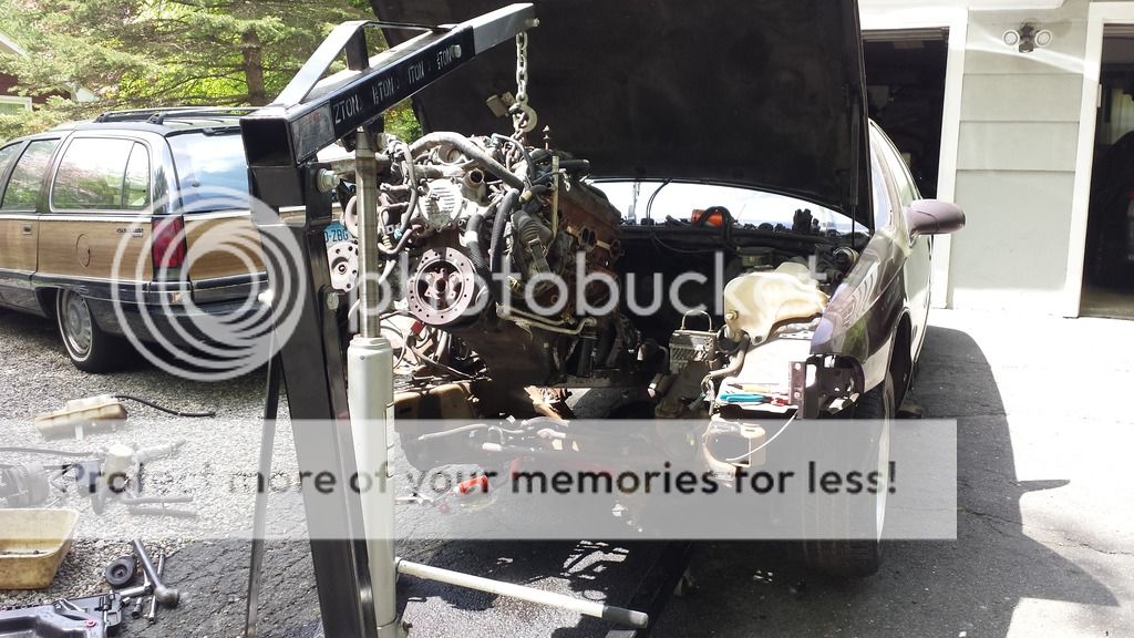

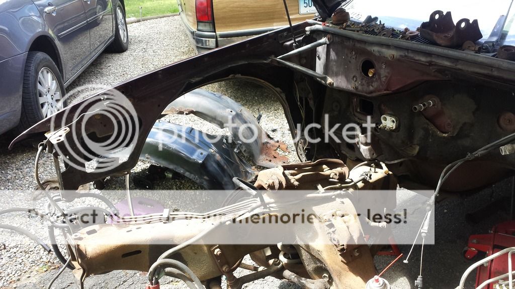

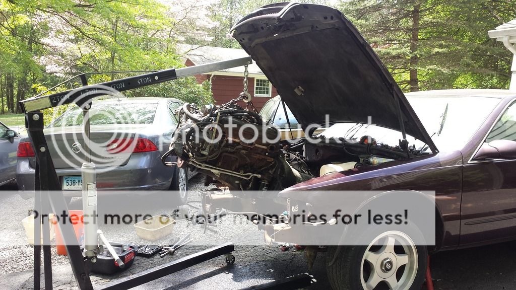

Finally pulled the car out of "storage" (the back yard) a few weeks ago and got right to tearing the knocking engine out.  It's a damn shame this thing has a bad bearing, it's one of the best running LT1s I've ever owned and pulls real good.

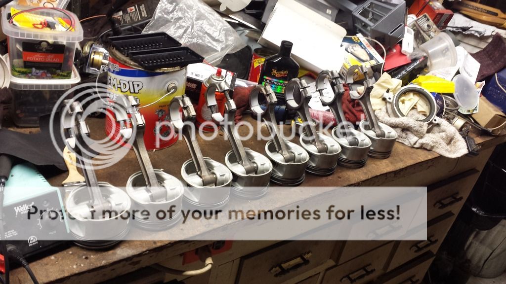

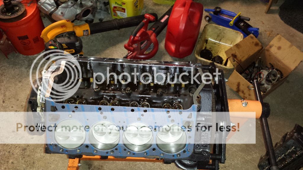

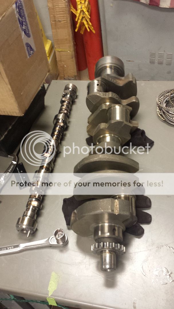

The motor swapped in is an LT1 from a 94 RMW I bought years ago.  I took it apart and replaced the rod, main and cam bearings as they looked well worn and threw new rings and gaskets in there.  Being extremely cheap I cleaned all the parts at my work and did the "machine work" myself with some emery cloth and a drill powered hone.  Everything came out nice and within factory specs cheers For the valved I cleaned everything up once again at work and lapped the valves.  Nothing fancy here, just a standard 150k LT1 that's bone stock.  The only mods done are put a vette servo in the trans with the .500 boost valve and an S10 torque converter (stall is around 2k RPM instead of the stock 1200rpm).  I would have liked to go with a 6.0L LS, but cash is tight, maybe down the road it will happen.

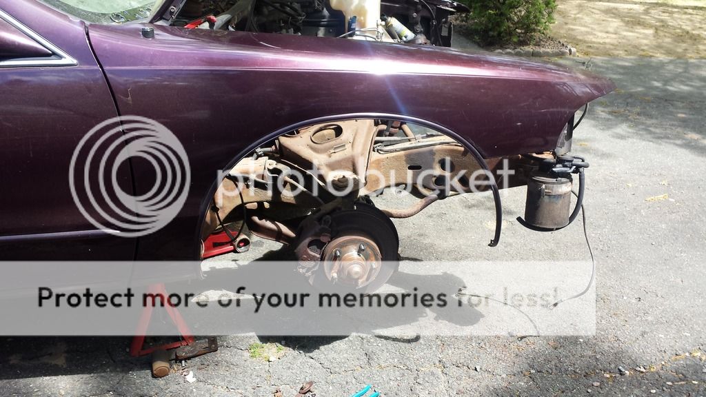

Had a week off between jobs so I got to pulling the drivetrain out.  I also swapped out the rusty PS fender well and the rad support with some clean NJ parts sourced from the Englishtown swap meet a few weeks prior.  I believe this thing had a battery leak which rusted out everything near by.
Finally got the car back together and much to my relief that motor started with no odd noises besides some clanking rockers.  I had to readjust them with the engine running and all is good.  This thing pulls hard and shifts great, really pleased with the turn out Laughing
Photo time:

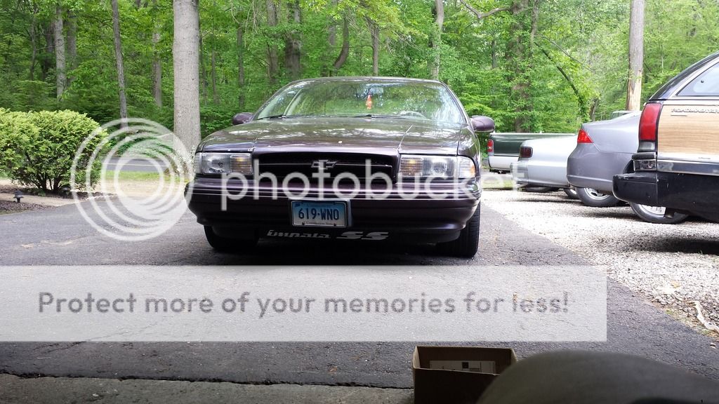

Waking up from it's long winters nap:
worn bearings:
Cleaned parts:

Front end torn off:
Knocker coming out:
Gutted engine bay:
New motor in:
