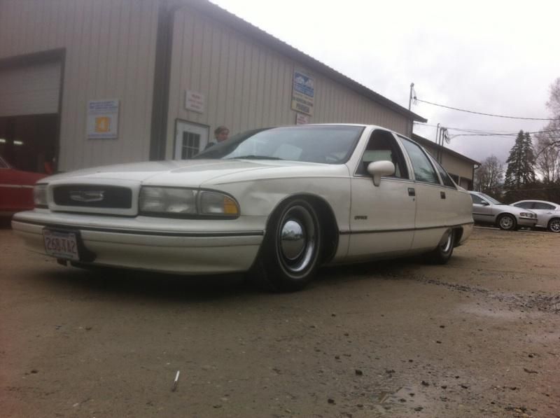

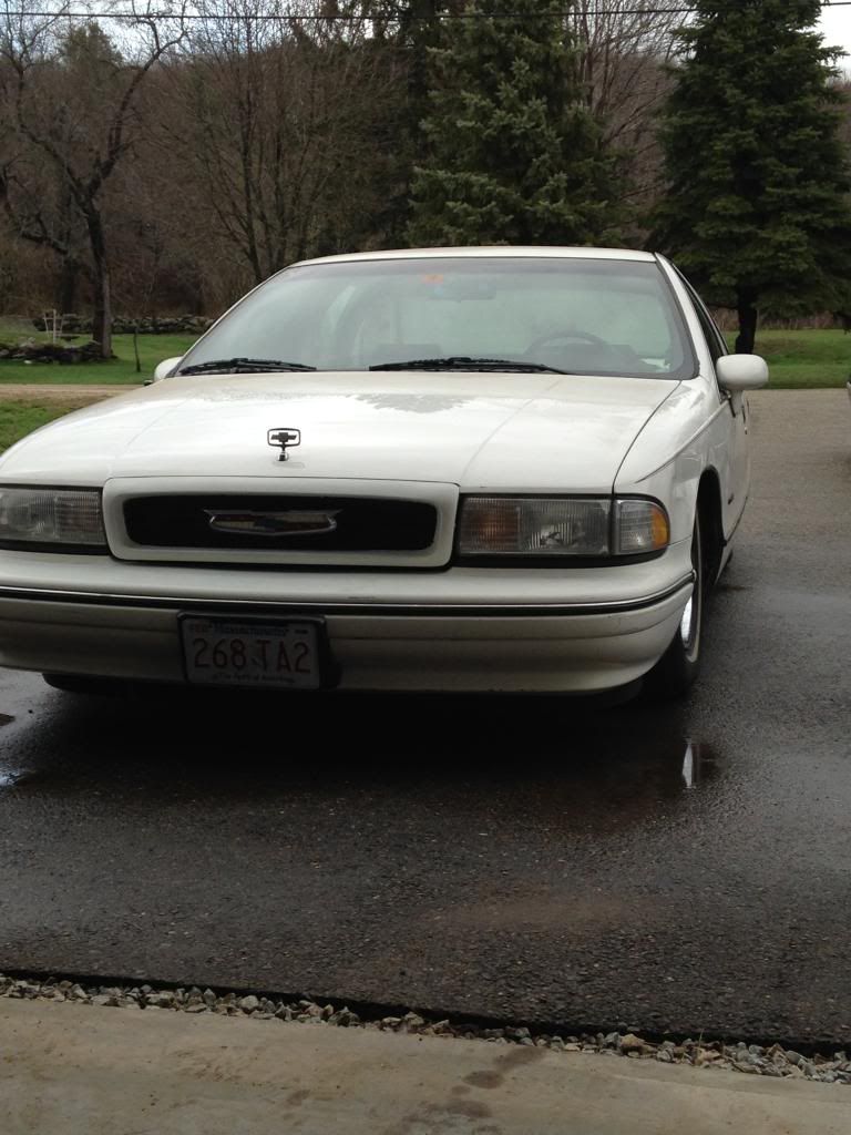

Seeing everyone else's progress got me all pumped up to start a thread about the '92.
For anyone who doesn't know, after Bowtiepimp bought another Caddy his white 92 Caprice went up for sale.
I was hesitant to buy because I really wanted a roadmaster sedan.
After weighing all the pro's and con's and NOT finding any RMS's I pulled the trigger and bought it from him on Easter Sunday (2014).
With a mod day at his place just one week later I got right to work on it!
Astro rims and tires came off for some steelies with moons and rings wrapped in 225/75r15 whitewall's
Did the air ride system in 3 days and I'm pretty sure I broke my thumb in the process. It was in there and all together but just barely. I took the ride up to his garage in Groton, MA for the mod day which was the car's maiden voyage with the air ride. Car ran hot the whole way up, drove with the heater on the entire way. Just when I think I'm in the clear the rear brake lines blew out on me at a stop light just over the town line in Littleton. Made the rest of the distance babying the car. When I arrived I also found a loose power wire that needed attention as well as it looked like it was dragging the ground for a while.
With a little help from a few badass dudes we got the brakes all patched up so I could make it home. It made 2 other journey's. One to a stop and shop and one to my job. It's been parked since.

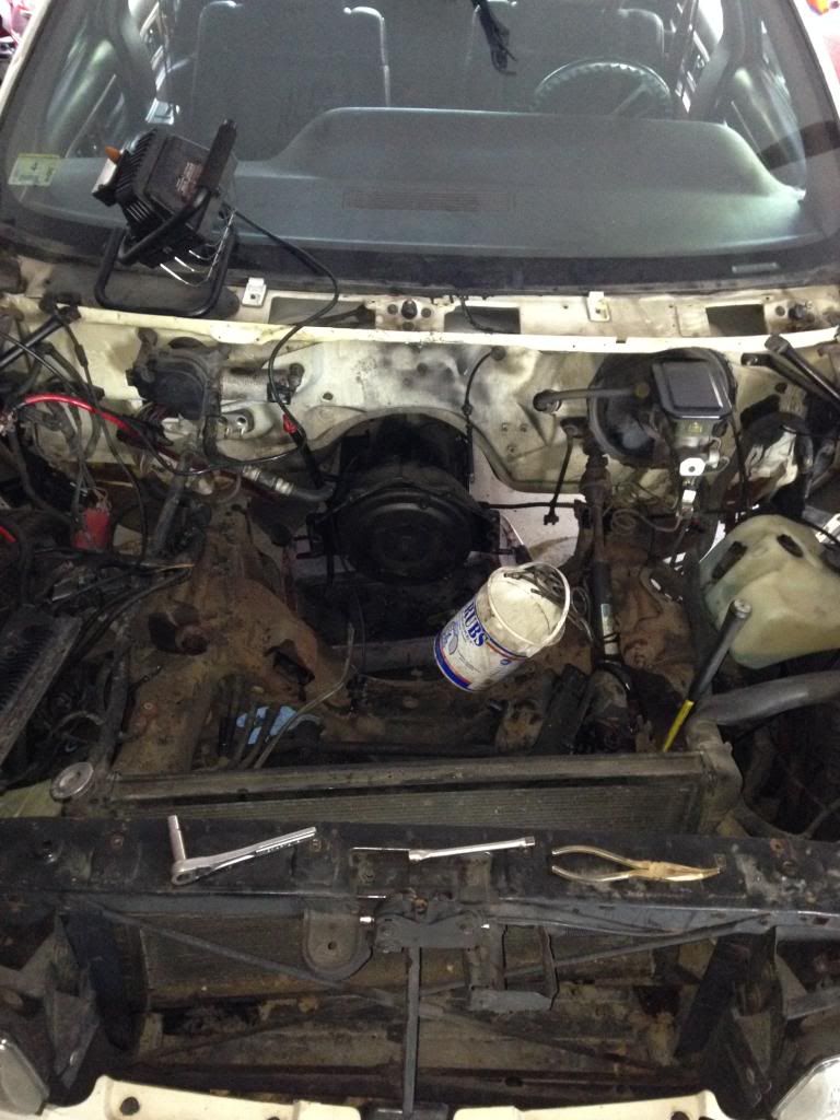

Engine was pretty beat with 186k on it. Overheating and blowing oil all over the underneath.
Planned to pull it anyway so out that came.
Next to come out was the trans and cross member.
I had planned to use the 4l60 mated to the 350 I have hanging around but after second thought decided to go with a manual trans.

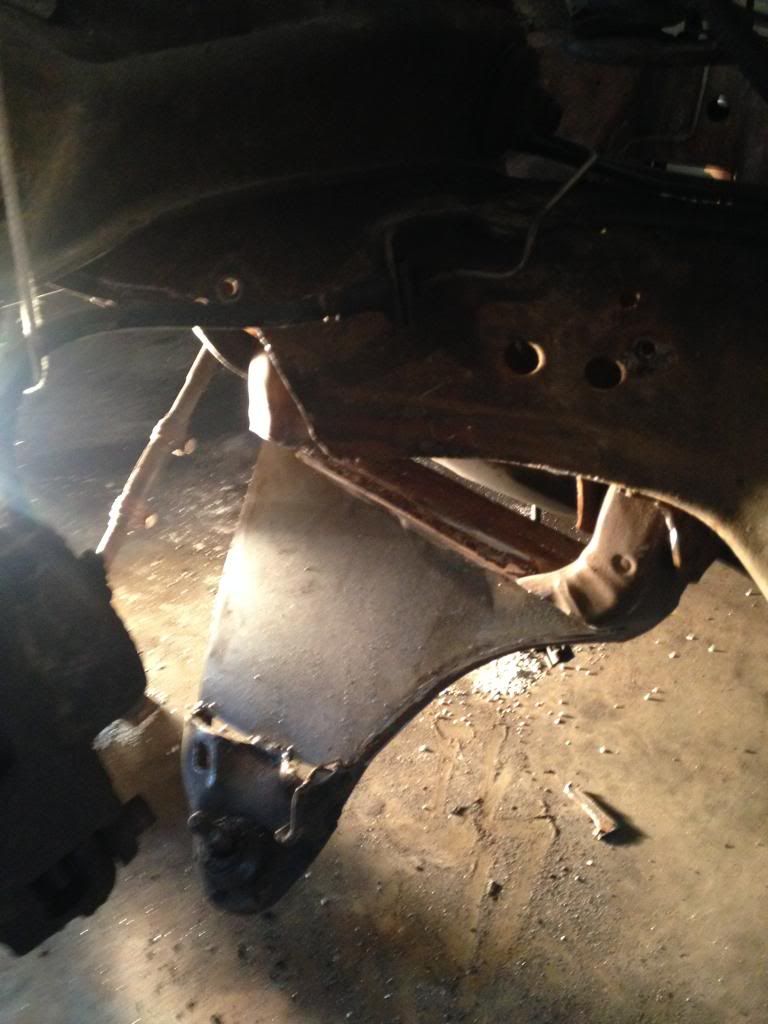

While pulling the engine somehow one of the front bag brackets went crooked and I dropped the car down on it wrong and it tore the bag away from the lower mount. Had to replace both front bags!!!

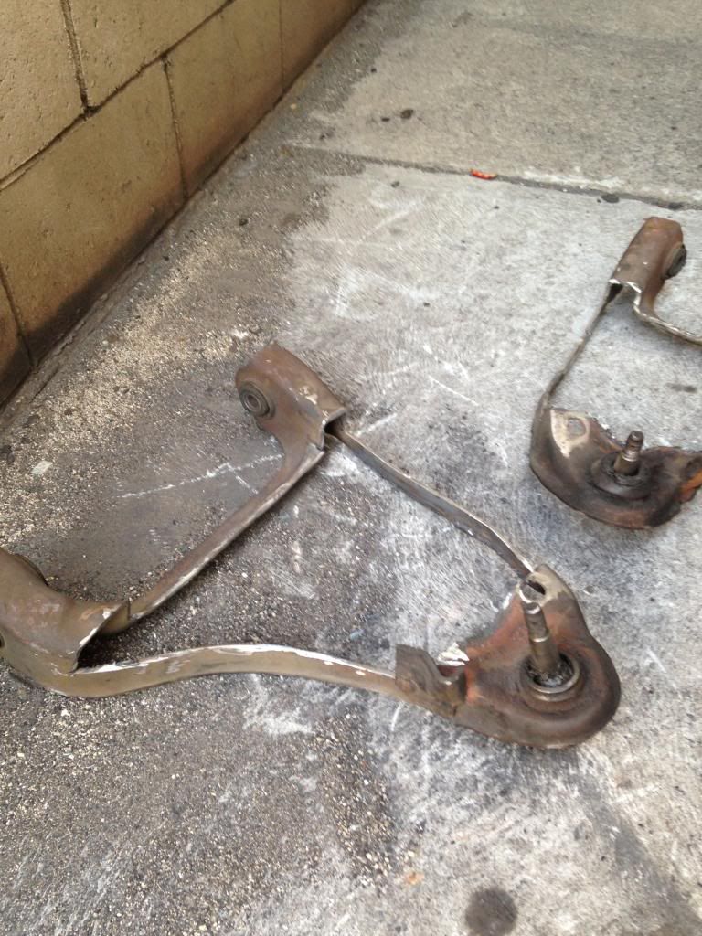

While I had the bags out I notched the frame for the tierods, and took out the LCA's to modify them so the bags won't rub and to get the car lower. They still need to be cupped a few inches because I am still a mile from the frame touching concrete,

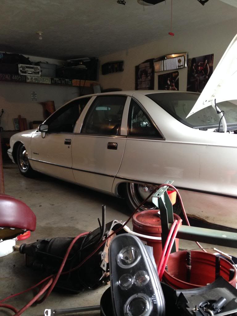

Some pics of the car at mod day and in the garage

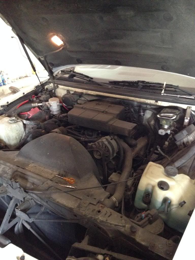

Motor went in this weekend
So did the trans

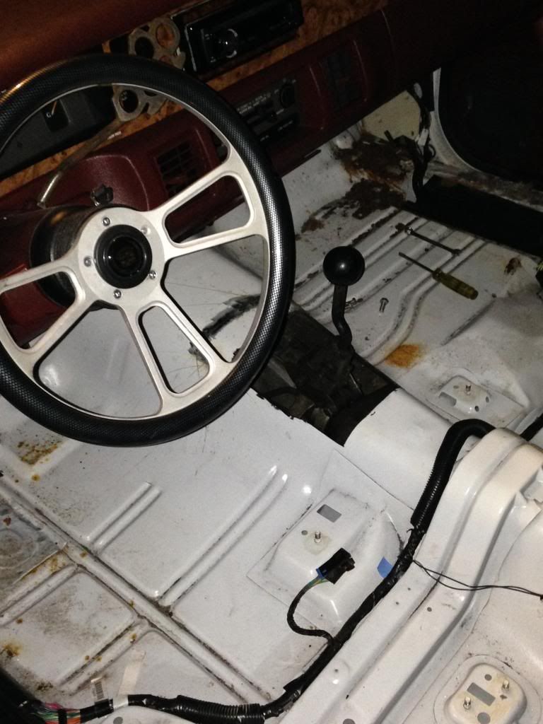

Car is gutted now, found a few lovely spots on the floor that need attention.
Trunk is ridiculous with rot. Will replace as I go.

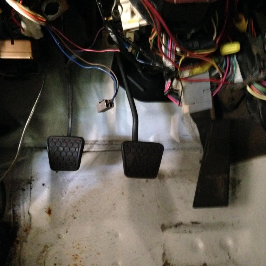

Pedals and exhaust are next as they both need to be present at the same time to find clearances .
Hoping to get it fired up this coming weekend!

Got them cuz I liked them. They also came in the stock height.
Distributor is a point's sized HEI. I made sure I was on number one before dropping it in, I have enough room to turn it if I'm off a tooth. I basically had an anxiety attack over clearance with the cowl. I hammered the shit out of the cowl to gain as much clearance as possible and didn't need to do any if it. Fit in there no problem.
The plan is to only modify what's needed at this point to make the car drivable again. So if I have to cut something it's only because it's a must right now.

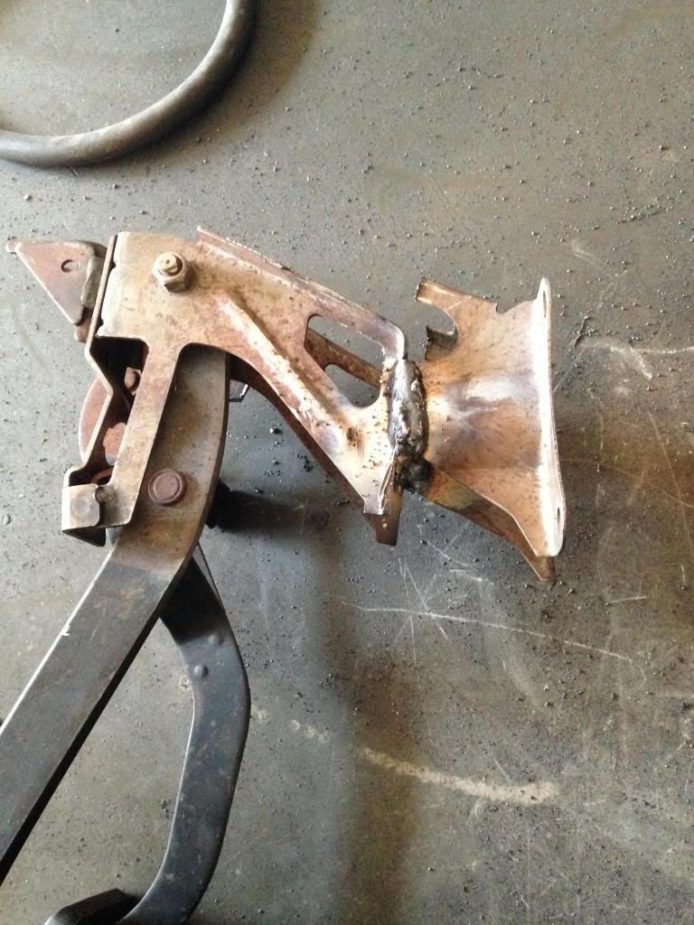

I melted one of the rams horn flanges trying to "burn out " a broken stud. Got that all welded back up and filled the hole with some high nickel 7015 rod... Looks pissah! We'll see what happens when I go to drill it and tap it. (Pics tomorrow)
I have a mechanical clutch setup from the c10 I think I can make work, V8Killer offered me a whole setup for a Good deal. If this doesn't pan out I might go that route.
I'm planning on moving the ball stud from the trans to the block like they were back in the day. Looks like I have a better angle there.

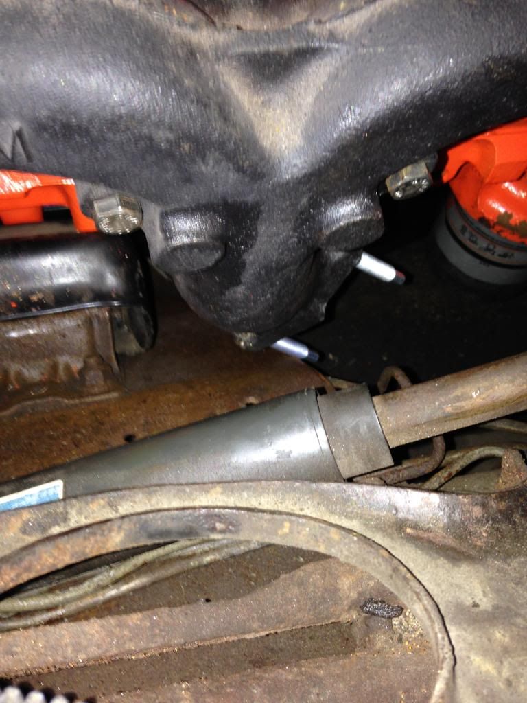

Found a mechanical fuel pump that will work with the car today. Got a 3/8 fitting to use and flare the end of the stock fuel line to mate the pump to the factory nylon lines. Piece of rubber line will take care of the return line.
Also got some 3/8x16 studs for the ram's horn manifolds.
I forgot that on 265/283/327 intake manifolds there is no spot for the alternator bracket to bolt to, the oil filler neck is there and the thermostat housing is moved to the drivers side slightly.
Going to have to cut the bracket and weld in some metal to make it reach the gooseneck bolt.
No pics, didn't have time to take any. Tomorrow is another day!!
Posts : 2125
PostSubject: Re: Nine Deuce: The Official "Slammed Sedan" build thread   Wed Jun 25, 2014 1:30 pm

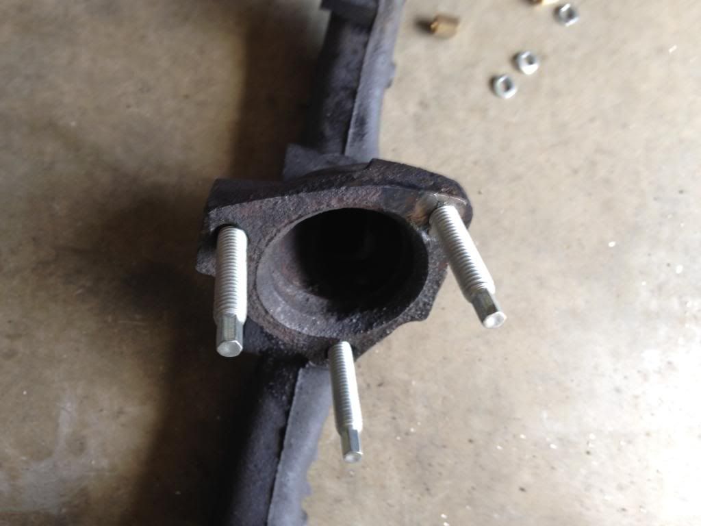

I got the manifold drilled and tapped this morning, installed studs and got the new flanges in the mail today from Bear River Converters in Utah.
Already ran into a problem.... Slight clearance issue on the cradle. Nothing a little cutting won't solve!!
I also tried installing the fuel pump and after adding the rtv sealant realized the cam eccentric is in the compression position which made installing the pump impossible. Gonna have to crank the motor over a little to get the rod off the lobe.
Out of time today. Tomorrow is a bust ass on it all day kinda day!

The passenger exhaust manifold won't even bolt on it's hitting the cradle so much.
Gonna have to do some serious work in that area. I'm almost tempted to just run the dumb stock manifolds at this point!!

Today I got the dash stripped out and the z-bar pivot ball moved from the trans to the engine block.

Besides buttoning up stuff here and there with the engine, my main goal and focus is now on the clutch setup.
After that im on to re-wiring the car so it will start with a key and not me rubbing wires together.
I decided to NOT pull the engine, bought an adapter and some 3" cut off discs for the die grinder and was able to notch the cradle on the passenger side with no issues. So I'm assuming there will be no problems on the drivers side as well.
So as soon as I find some good lt1 exhaust pipes those will go in as well. (Again for clearance checking the clutch linkage, I'm still focused!!!)

Alright here we go.
Even though it was hotter than a Witch's a**hole today I found the courage to go into the garage and get some stuff done.
Removed the brake pedal assembly ( Mad Mad Mad ) and started to get the new ones built.
After thinking this over a few weeks I concluded the easiest (and cheapest) route would be cutting and welding both sets together.
Measured both sets to see what the difference was from pivot to mounting surface, then cut them apart and welded them together adding the difference to the assembly.
Still need to do some re-enforcing and add metal to tie them both together.
And the pics for proof:
They are just loosely in there held by 2 nuts finger tight for now
Brakes hookup nicely, and the pedals have good swing. I could still add a hydraulic setup at this point but I am determined to get a mechanical system to work..... Nothing like the feel of it!!
Next step is the actual z-bar and see what I need to cut/ add/ bend to get the pedal to the z.

Knocked out both lower ball joints, tightened and torqued the entire front suspension, removed a ton of crap I don't want from the car this weekend.
Got the hole cut in the firewall for the clutch pedal rod to pass through also.
This weeks project is going to be making a mount for the z-bar to frame, and bending the tabs on the z-bar to reach the rod coming through the firewall.
