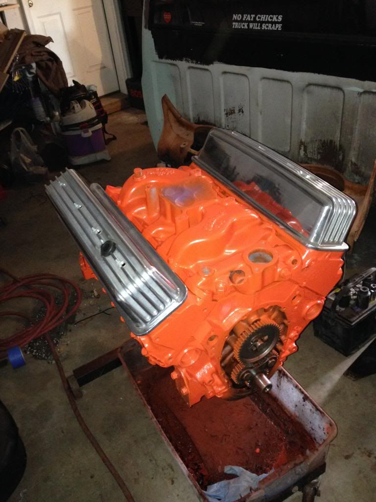

It looks like those will fit. See how one of the covers has the front of it notched a 1/2" or so? That's how they fit the B and D cars. But... I have never seen those in person. I'm just going by the pic.
I have aluminum valve covers that I got off ebay a few years ago for like 80 bucks... Lemme do a quick search...
Yeah, these:
http://www.ebay.com/itm/Small-Block-Chevy-1993-97-LT1-Aluminum-Valve-Covers-350-Polished-SBC-Hot-Rat-Rod-/350992475666?pt=Motors_Car_Truck_Parts_Accessories&hash=item51b8c82612&vxp=mtr

I'm running these in my caprice. But I'm trying for old school

I got them a while back on eBay., they are super tall for roller rockers. I had to relocate the alt to the bottom of the engine on the lt1 I had them on.
I'm hoping they clear the damn wiper motor!!!
