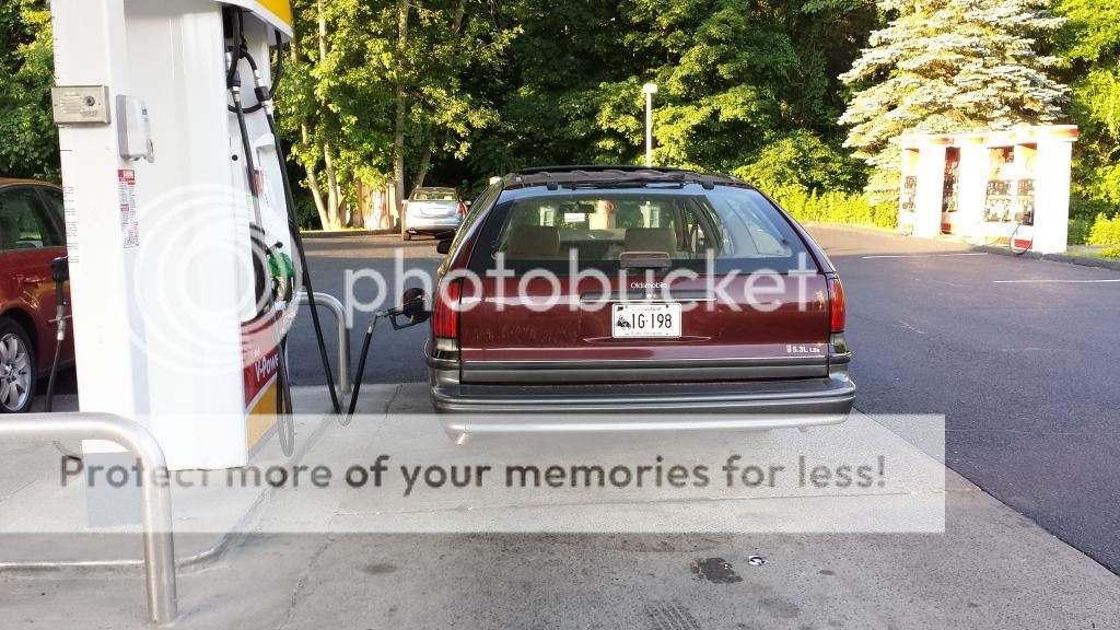

The LS picking up it's first meal

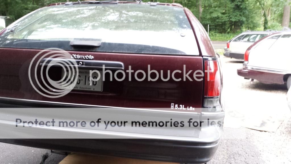

The all important badge I made at work
