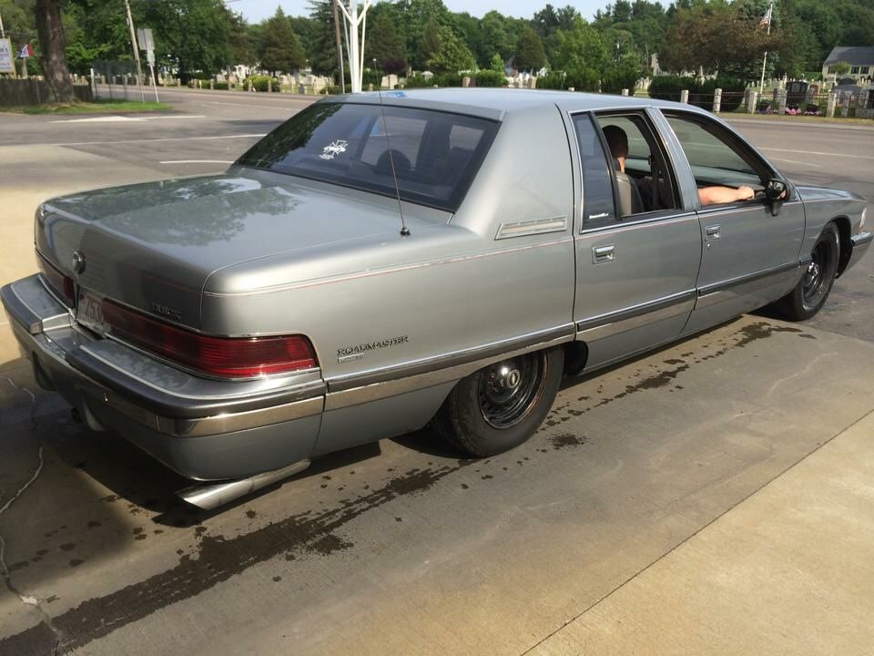

Yea, more tire is right! I don't want huge stock SS size tires (after seeing Billy's. Looks good, just TOO much sidewall IMO). I'll end up just putting the lace wheels and tires back on (once I fix the flat). These here are bald on the inside front tires, so I can't keep driving like that. No $ for tires. That's why I'm trying to sell shet.

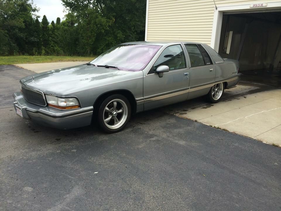

I think those wheels look good on that car regahdliss, kehd. The spokes match the paint. Haha.

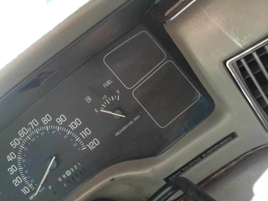

175k and the seat belt warning light burned out. I'm not upset...

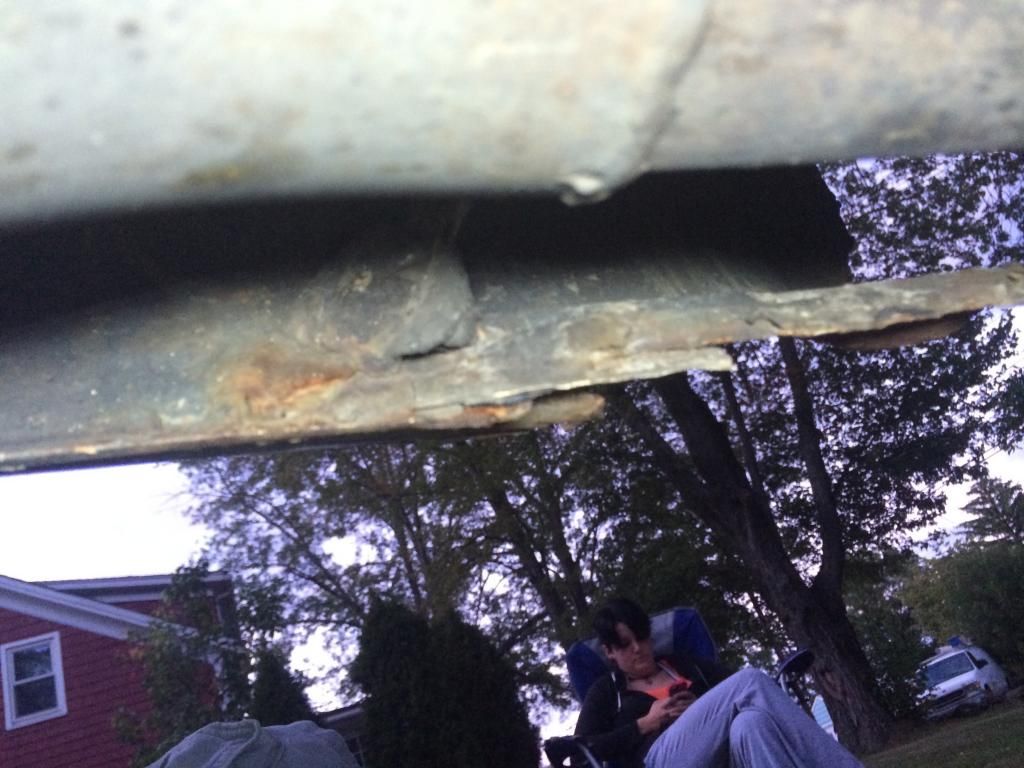

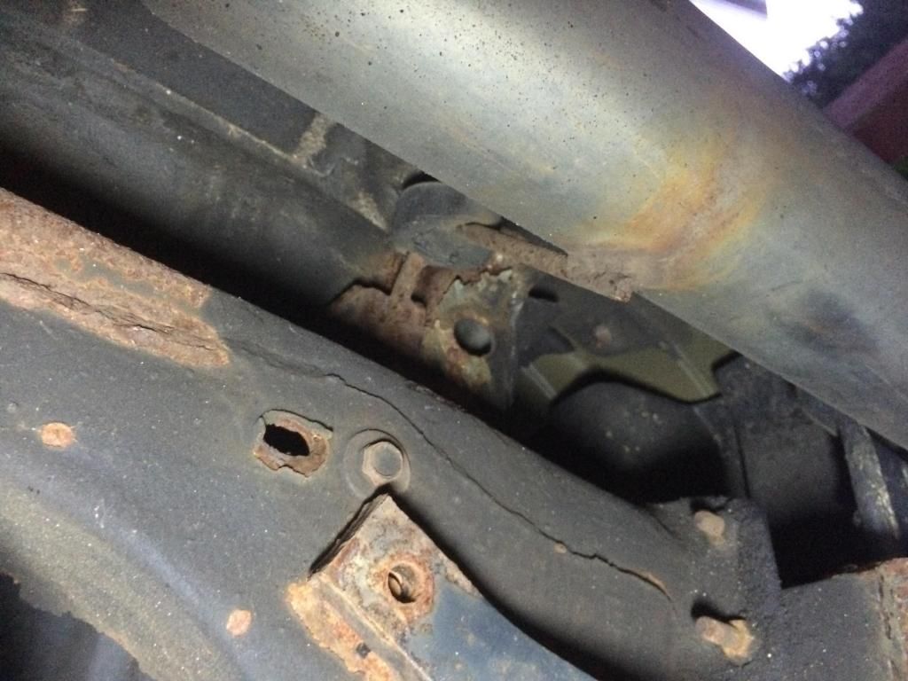

Had the OTA pipe come loose from the muffler on the drivers side. I'd've left it (sounds nice) but the whole OTA and tail pipe clanging around was really starting to wear me thin. That and the heat shield in front of the gas tank chattering and banging around was really pissing me off.

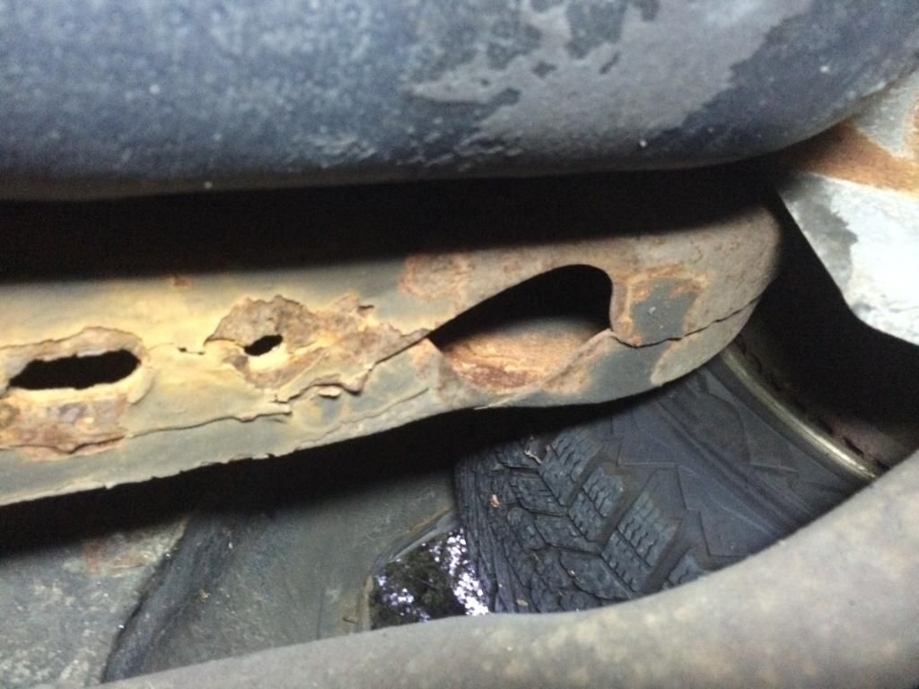

I ripped out the heat shield after I undid the 3 7mm bolts that secure it to the floor pan shield. I'm pretty sure there's supposed to be more than just the 3. Pretty crusty regahdless.
The rear underside of this Buick is in far better shape than I actually thought. If I strip it all, patch up some stuff, and do some rust proofing, we should be good. Why not? You know? I'm tired of seeing B bodies go to the crusher because people are talentless when it comes to repairs. I don't have all the right tools or experience, but it's going to happen. Most would get rid of the car, but why? Cuz it's rusty? I'd rather save it.
Anyway, I'm provably going to toss these tails and put turn downs on the mufflers. Eventually I'd like to get the pypes x pipe and some mufflers Tim suggested.

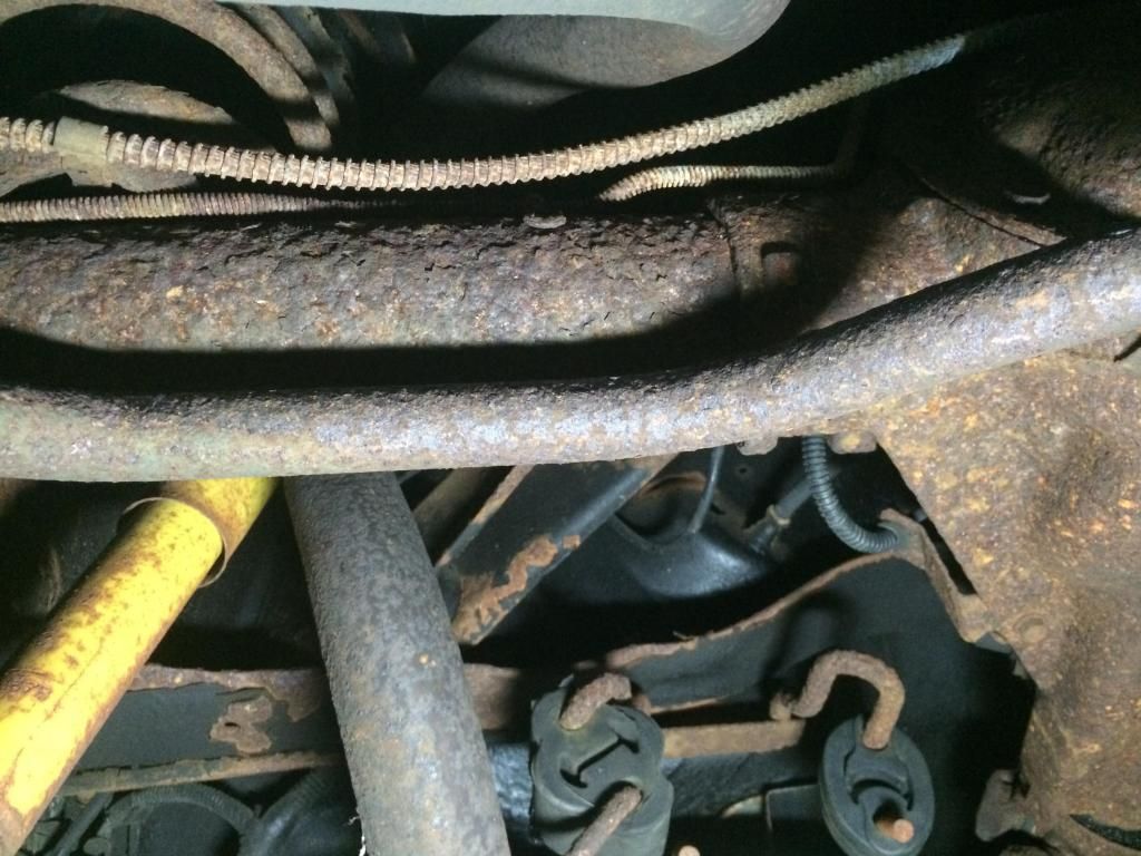

No rear brakes, rear sway bar fell off last night while driving (my own fault).
All is well.
PostSubject: Re: New (to me) RMS   Sat Oct 25, 2014 12:44 am
Sway bar? oh sh!t! I was looking at the pics and she looks in pretty good shape for a NE cah.
Posts : 4253
PostSubject: Re: New (to me) RMS   Sat Oct 25, 2014 1:01 am
It's my fault. I took it off to replace the lower control arms ( rotted) and never torqued the sway bar bolts back.

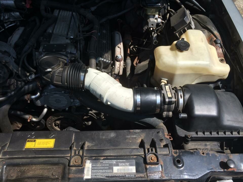

Swiss cheese air box. Noob mod.
Unpainted sewer pipe, AIR delete, TB bypass, new WP.

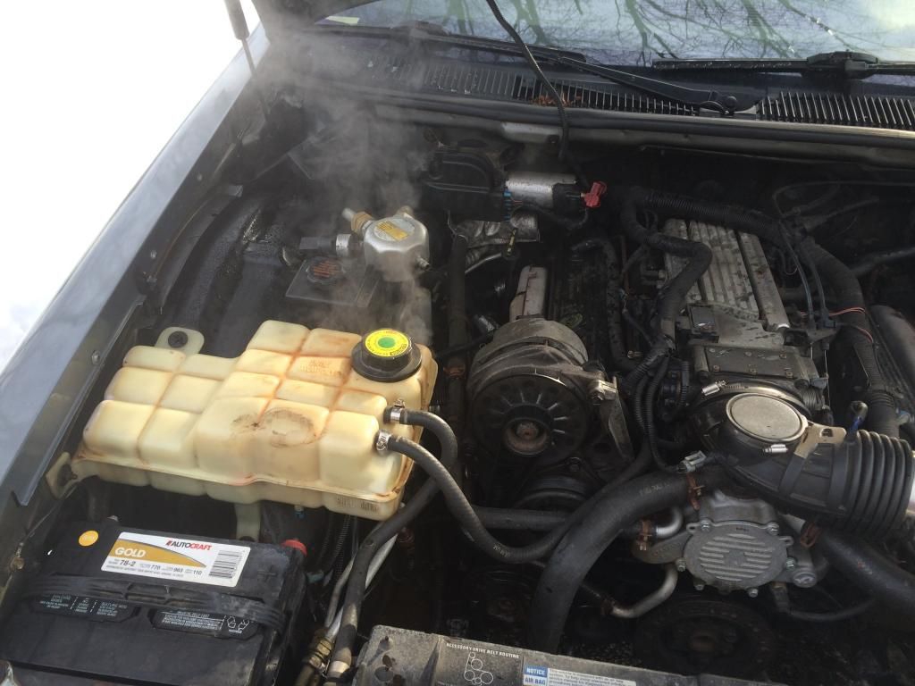

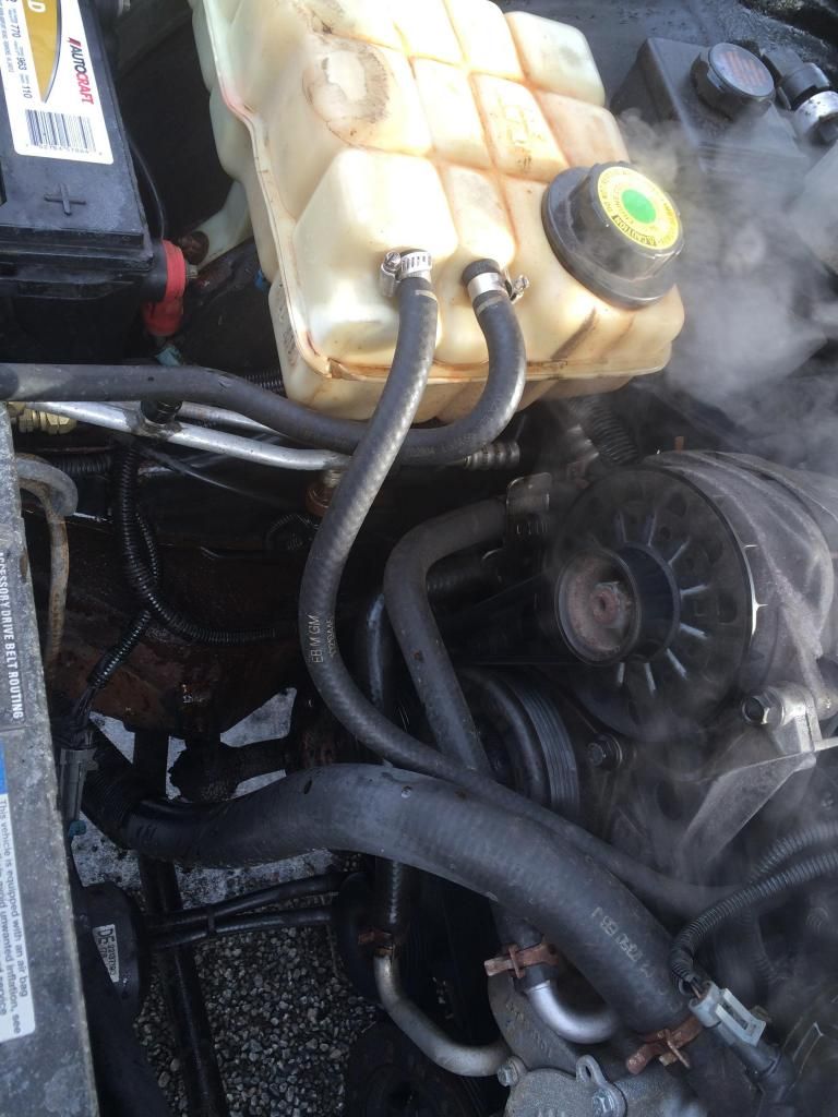

Roadmaster overheated on me on the highway en route to a VA appointment. There was no chance I was gonna stop with it in the single digits, with my 3 year old in the car, and risk being stranded. So I drove it back home.
I'm not sure what happened, it's kinda cold to be messing around in the driveway.
PostSubject: Re: New (to me) RMS   Fri Feb 06, 2015 9:14 am
Looks like a bad cap...unless you cracked it open already.
Always was amazed that the cap will cause them to overheat...but...
Posts : 4253
PostSubject: Re: New (to me) RMS   Fri Feb 06, 2015 9:23 am
Haven't cracked it open yet. Was still boiling. Sounds like plenty of coolant in the system still.
Posts : 4253
PostSubject: Re: New (to me) RMS   Fri Feb 06, 2015 10:11 am
Thinking it's the cap. Kinda stuck until wife gets home. Can't drive to the store to get coolant. Have 2 other cars, but you know Wink.
Only other cap I have is on my 9C1. I'm not canibalizing that car. I ordered a new cap from Hamilton Chevrolet. If there was enough room for steam to pour out as it was, maybe there was enough room for coolant to spray out. If the negative temps somehow compromised the cap overnight, and caused the system to be depressurized, I can see this happening. Air in the system, coolant boiled, etc. I didn't notice the fans running or not as I turned the car off as soon as I got in the driveway. All the noticeable leaked coolant is directly under or in the immediate area of the overflow tank.
The Buick has a new HC, WP, and t stat. System was flushed and filled etc. that was last year or shortly after I bought it in 2013. No problems with cooling, heat, or anything like that until this morning.
