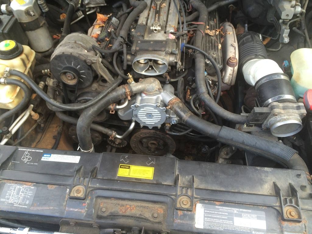

Very true. Can't hurt to look anyway. I was driving 65 when it happened. Not sure how long before I looked down at the gauges tho :/ but there's still a lot of coolant left in the system. I've had a lower hose go before and that drained everything. That was also winter.
Kinda stuck until wife gets home. Will fill with coolant and try to recreate the leak.

Buick is topped off. Ran it up to temp. Fans work and thermostat opens on que. No leaks.
I want to say it was the cold weather or magic loose cap. Can't see loose cap...hood hasn't been open in months and even then that wouldn't have been touched. 10,000 trouble free miles.
Haven't driven it yet. Will take it to work tonight. Wish me luck!

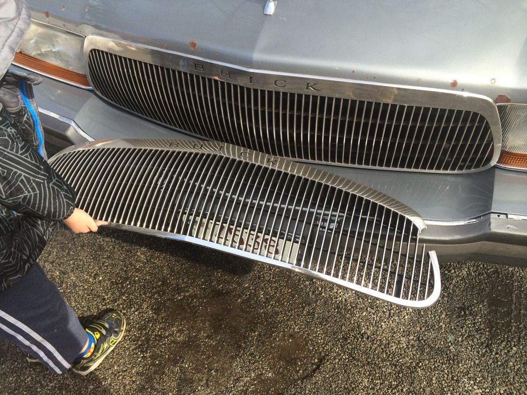

Got a used grill from Indigo, to replace my cracked one.

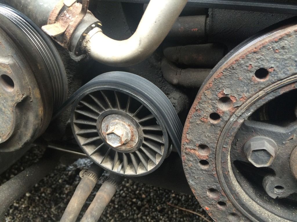

I got tired of the squeak squeak squeak squeak squeak squeak.
After a few trips today with the window down, I had enough of it. I figured I'll try free remedies first. I dug out the tensioner from that '83 Caprice LT1 swap junkyard find. 2 10mm bolts and bingo! I start the car up to idie, no more squeak. 18x,xxx miles on what looks like the original tensioner. I am now content.
Some sort of non OEM replacement tensioner. The hex head used to release the tension, is a bit larger than an OEM one.

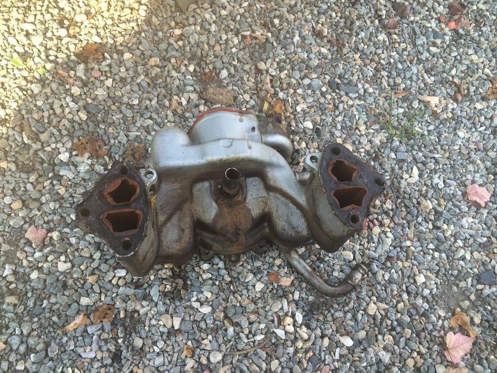

Water pump went. Started leaking pretty bad from the seal in the back where the input shaft/coupler is. Of course it happens this time of year.
I ended up flushing a ton of crud from the heater core, radiator, and block (again). Maybe I'll have heat this year cheers
The coupler seems to be stuck to it. I left it sitting in PB blast for the night.
It looks like she'll end up parted out after this season. For me, there's too much rot to justify any of the other repairs. I gave another club member a laundry list of issues and things it would need. They even said it's only worth parting out or doing a frame/drivetrain swap for something else. I know I've said one other time I was parting it out. But I never got a title for the other car I have to replace it. I suppose I could just use my company car until I find something. My wife's car needs to hit the scrap yard too.
I think I've already got someone here interested in the whole front clip. It's a tough issue for me giving up on a car like this but it wasn't taken care of too good prior to my ownership. Even tho it's Swiss cheese outback, I still wash it frequently in the winter and keep up on fluid services. It's super reliable and fast for a junker. It's just got a mountain of issues stacked against it.
I'd like to replace it with another Caprice (91-92 or 95-96 LT1) or even a Buick wagon (95-96).

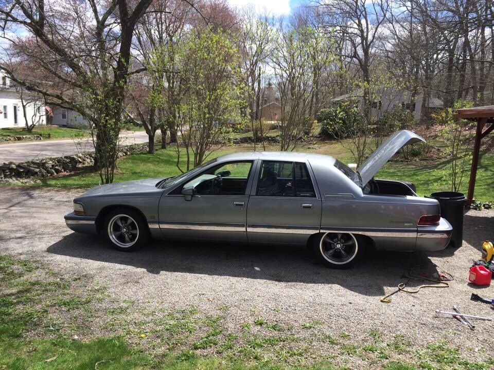

This happened yesterday. Not even a mile from my house. 7am. Just got done working an 11 hour shift.
Posts : 1508
PostSubject: Re: New (to me) RMS   Mon May 02, 2016 7:46 am
Ugh..........definitely not something you'd want to face after working 11 hours all night.
Good Luck
Posts : 4253
PostSubject: Re: New (to me) RMS   Mon May 02, 2016 4:05 pm
Worst part about is I can't fix it until tomorrow. Apparently nobody stocks C clips in store anymore. Not bad tho, Tuesday is one of my days off. Hopefully I can finish this up then get the Caprice going.
