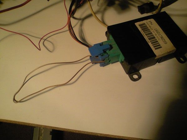

The 9C1 doesn't HAVE VATS exactly. It does but since it has 1 key for the entire car and no key chip, the factory just pinned the wire back into the box to "trick" it. There's also a way to add resistors some way or another. I saved these pics form the big forum a while back showing what a 9C1 VATS box should look like. Either way, you'll need it with the PCM.
84 caprice lt1 convertion attempt :) Image-10_zpsb56ed7b2

So in the process of attempting to remove the unneeded wires from the old harness I found a cluster of them that have cracked and exposed themselves. Found them the shocking way as the brushed against some thing and got a little spark. Now I'm thinking it might be best to just get an after market stand alone harness. This way its all new wires and not 18 year old dry cracked ones waiting to cause a headache. I've seen them available on a few different sites ranging from $500 - $1200 for the engine and transmission harness, and Painless Wiring is the most expensive one. Does any one have a suggestion on where to get one from?

What Tim said. And you do not need to involve VATS in any way shape or form. The 9c1 came without it. It is not even in the PCM program.
The only thing you will need to do is either notch the cross member on the frame for the a/c compressor, or use a a/c delete pulley. Pretty much everything is bolt up.

I disagree Bill. The engine will run fine for about 90 seconds and then die unless you program out the VATS. Been there done that.
Posts : 4286
84 caprice lt1 convertion attempt :) Empty
PostSubject: Re: 84 caprice lt1 convertion attempt :)   84 caprice lt1 convertion attempt :) EmptySat Jun 01, 2013 4:48 pm
That's why I posted the pictures. Bill must have missed that one while building his boat.
