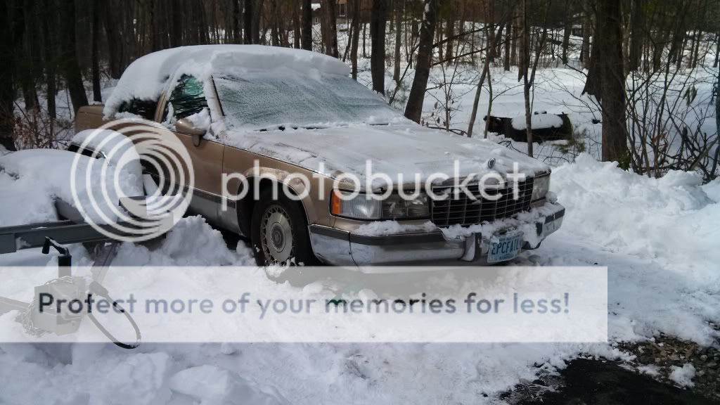

So that's how it sits. But now it's under a foot and a half of snow... I'll have at it again once the snow melts. Then I'll do the brake lines. Eventually... I just want to drive the damn thing!
I love this car. Rolling Eyes

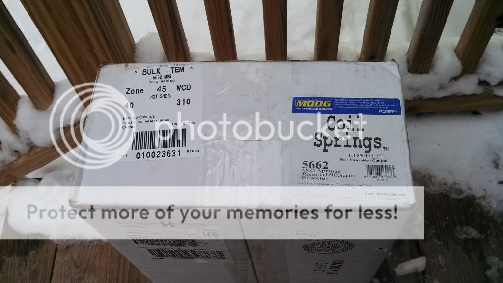

Oooh! Look what showed up today! Very Happy

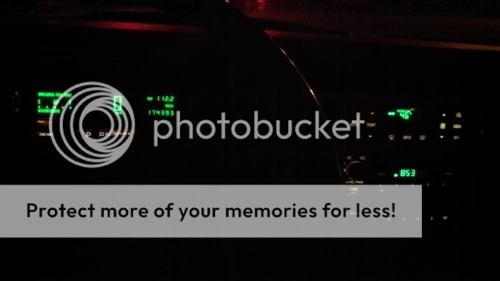

Dat MPG..... Used 19 gal for those miles.

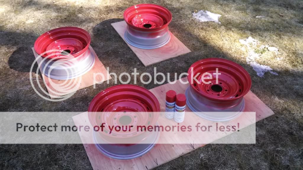

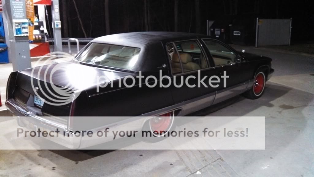

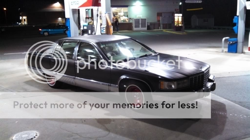

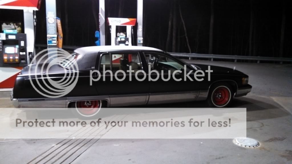

So the mods have begun. Sorta... Wink
I replaced the leaky coolant tank cap and fixed my mystery coolant leak. Smile
Also painted the wheels yesterday. Screw proper prep and waiting for warmer weather! Wink
Also scored a set of BFG 225/75/15 whitewalls for 75 bucks offa Craigslist this morning! Had to drive up to Berwick, Maine to get em. So I had a pleasant ride up in the illwood, with the radio cranking out some Blake Shelton the whole ride. CD player works! Very Happy
Hopefully I can at least get the rims and tires on this week. Maybe paint it next week or weekend some time. We'll see. I need to get the tint on the windows and dye the roof, too...
Would a red top be too much with the satin black? I'm thinking it might be. But I think I'm going to go either red scallops or red pinstripe flames, so... I'm not sure?
Diggit! Very Happy

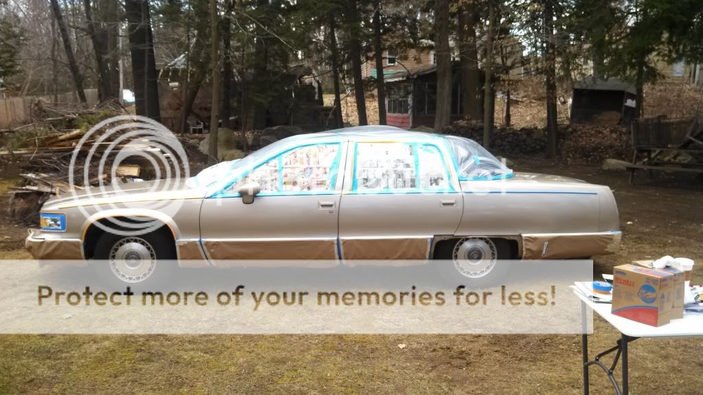

PostSubject: Re: I don't know why they keep following me home...    Sat Apr 13, 2013 8:55 pm

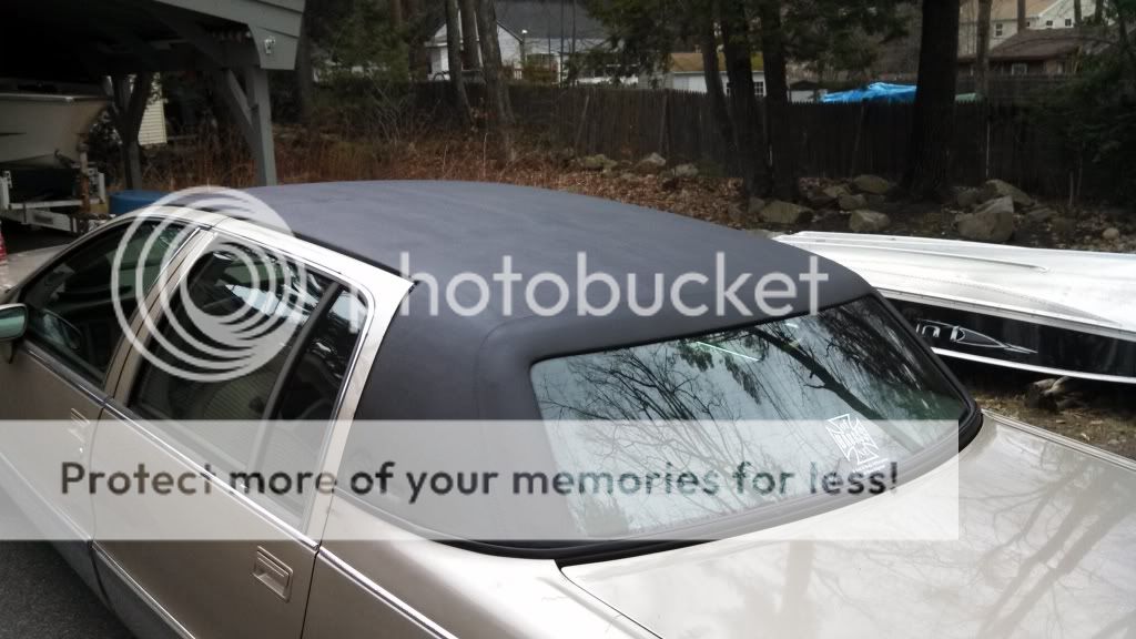

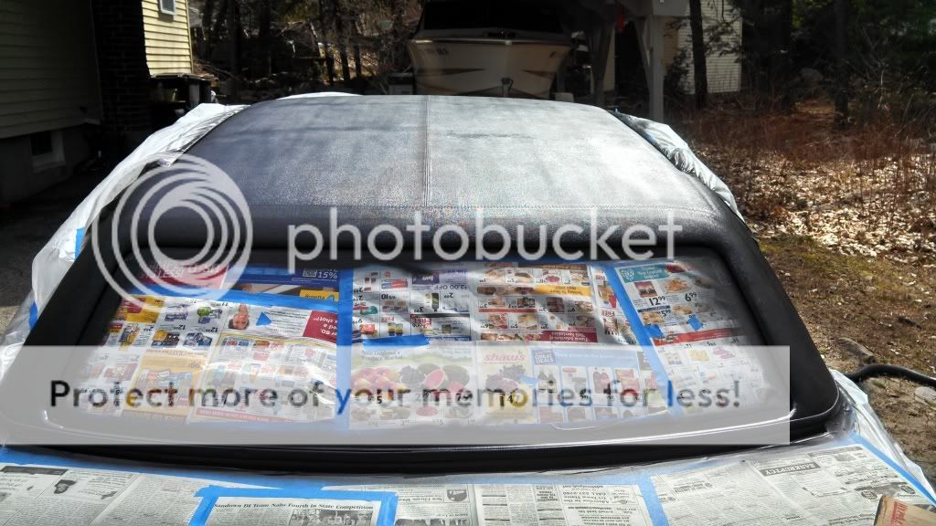

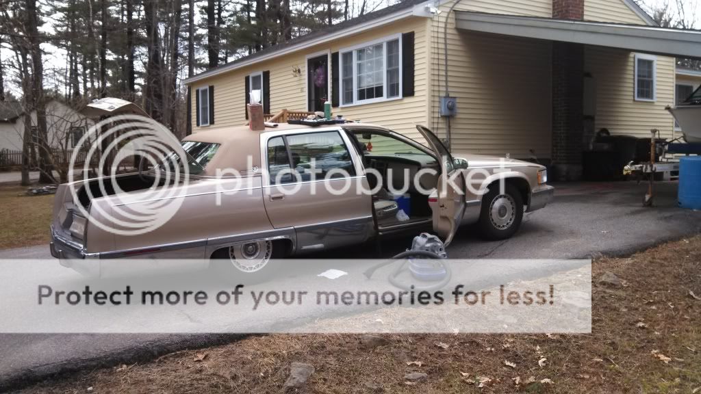

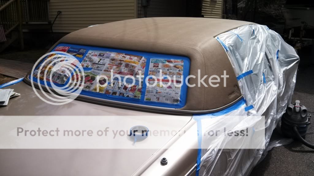

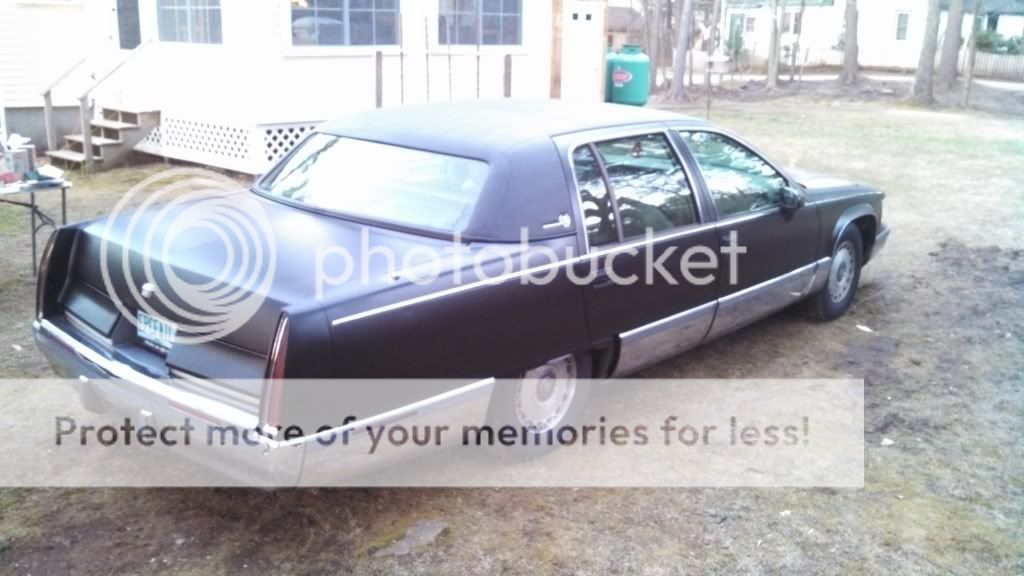

So it warmed up enough today about 11am to go out and start this whole painting project.

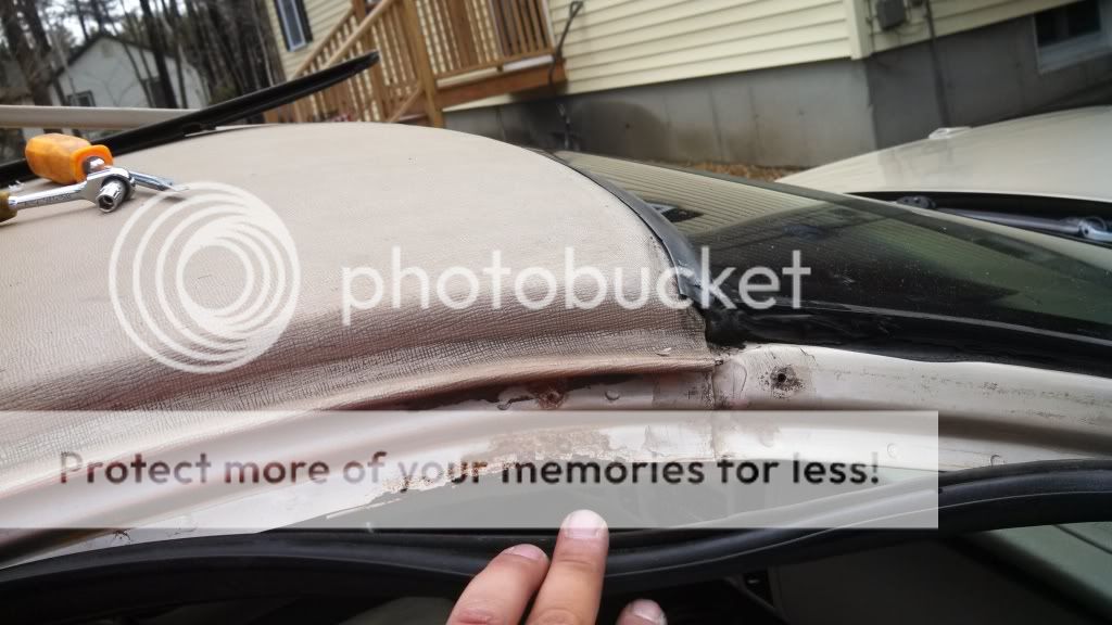

First I had to start by fixing the major water leak I had at the top of the passenger side windshield. I narrowed it down to water getting in at the seam.
I cleaned it as best I could and layered on the Automotive Goop and crossed my fingers. Wink
Then, the masking began...
Once I had it all masked, I used a green Scotchbrite and scrubbed the heck out of it. Then I used the SEM vinyl/plastic prep and a bunch of rags and cleaned it up as best I could. I used SEM Satin Black dye. Of course. Wink
I did my best not to tiger stripe it, but I only had two cans because that's all the parts store had, so I had to stretch them.
It came out pretty good. A little bit a tiger striping, and a little heavier at the overlaps, but still good enough for who it's for...
Then I got the whitewalls cleaned up as best I could for now, and have them ready to mount up after paint tomorrow.

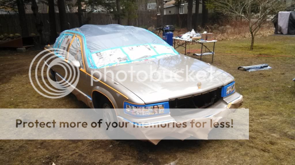

Then I spent a couple hours sanding and disassembling and then washed it with dawn to prep for the real paint.
I was going to go to Chris's shop about an hour away to paint it tomorrow because I didn't know where my compressor or gun where in storage. Well, I spent an hour at the storage unit and lookie what I found!
So it looks like I get to spray it in my yard tomorrow! Woot! Very Happy
I've got a few hours of masking ahead of me tomorrow, then a final wipe down and spray. We'll see what happens! Hope I don't get too much crap in the paint!

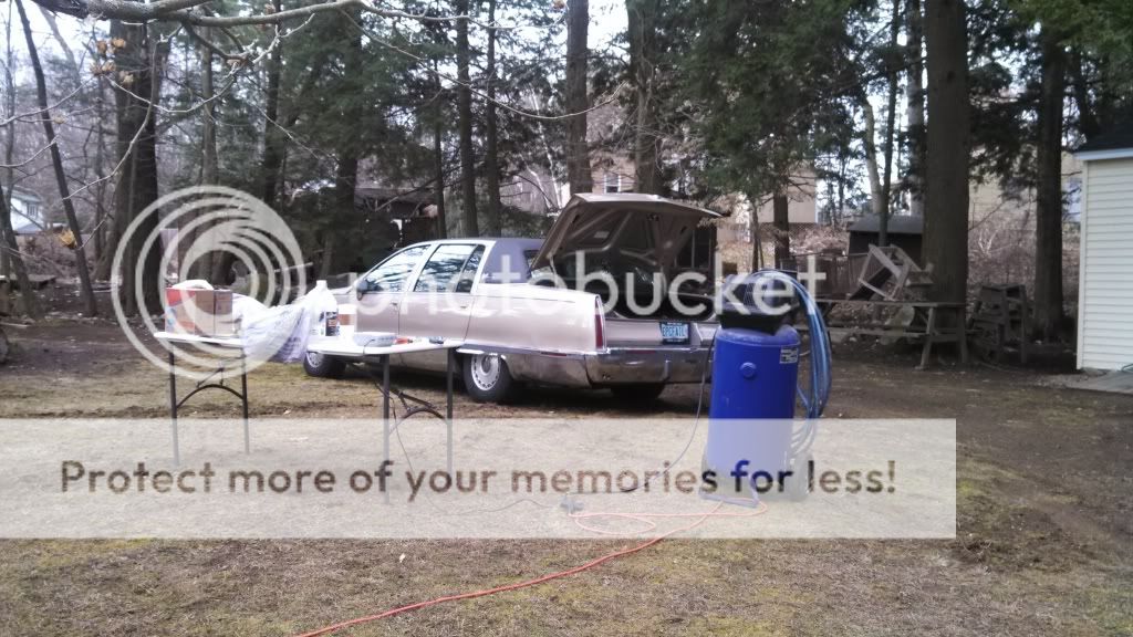

PostSubject: Re: I don't know why they keep following me home...    Sun Apr 14, 2013 9:24 am

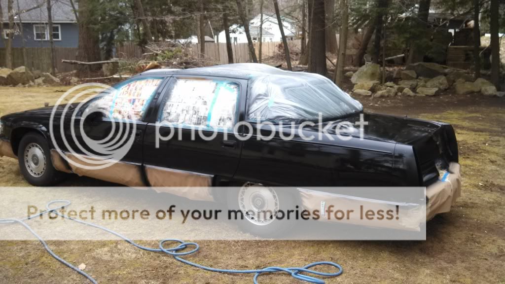

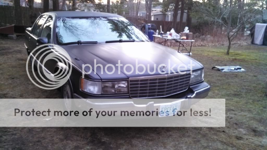

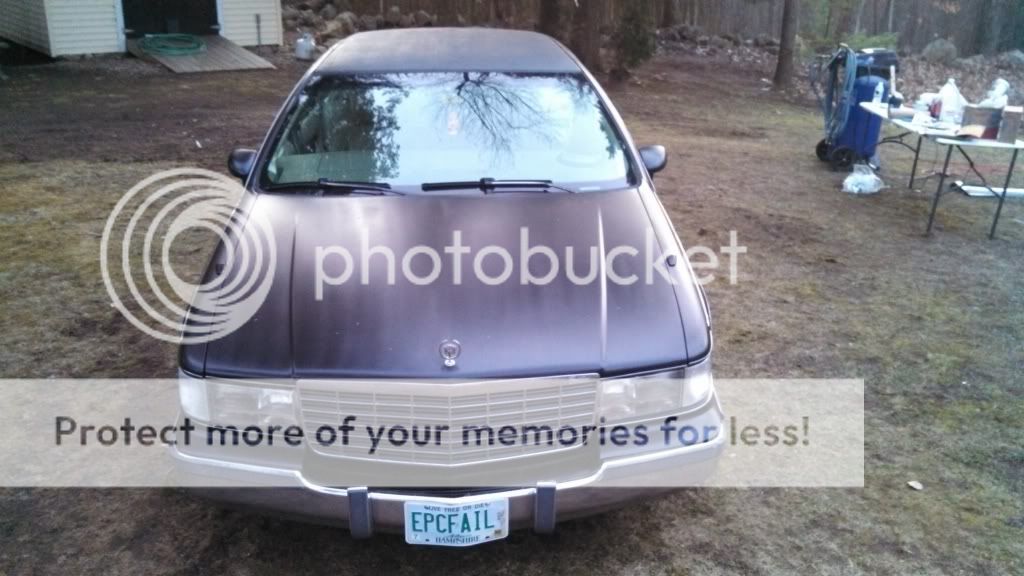

And day two begins....
Figures. It was beautiful, sunny and calm when I walked out here an hour ago and moved the car. 45*. Now it's cloudy, noticeably cooler and windy as hell... Awesome.
Wish me luck!
PostSubject: Re: I don't know why they keep following me home...    Sun Apr 14, 2013 2:49 pm
Of course it's been windy and sprinkling on and off today.... Grrrr. But it's all masked and wiped down and ready to go. Waiting for the wind to die down and those threatening clouds to either do something or blow away...

PostSubject: Re: I don't know why they keep following me home...    Sun Apr 14, 2013 7:34 pm
Normally I am not a fan of the whole satin black thing, but LDM is one lame ass color. That roof came out great!

Well, it's painted! Smile
It wasn't without it's challenges today though. Between the wind, pine needles, rain, clouds, and teasing amount of blue sky and warm sunshine, I managed to conquer the beast! lol. Man, I gotta say, it is A LOT of work masking one of these off by yourself! I had 3 rolls of tape, and I ended up running out and had to buy two more!
Anyways, pics or it didn't happen, I know...
Here it is all masked.
So when I finished masking, after about FIVE HOURS, the clouds were really threatening rain. So I waited it out a bit. It got really windy and cooled off. But after about a half an hour, it never rained. And most of the day I could see blue skies all around me and it was really pissing me off! Ha! So I said "screw it" and decided to start shooting. And damned if it didn't get windy again and start friggin sprinkling half way through shooting it. Dammit! So I ended up with a bunch of little gold spots wherever the rain drops hit. But luckily, it only lasted a few minutes. I just kept going. And after it started to dry, I went around it again and fogged it in the thin spots and tried to cover the gold pimples... And the whole time, bugs were landing on it and little pine needles were landing on it. Grrrrr... As of right now, it's STILL tacky, so I can't really pick them off yet. Hopefully after baking in the sun tomorrow, it'll cure and I can get that crap off of there.
So here are the painted pics. It's still very wet in those pics.
At this point I had to run out and find a tire shop that was open at 4pm on Sunday. I had one tire that had a good leak in it, so I took it to get it broken down and have some bead sealer liberally applied. Found a place, and 20 bucks (!) later, I had 4 tires holding air.
When I got home, it was drying, but still very tacky. But it had been sitting an hour and a half at this point, so I decided to de-mask and reassemble it. That blue tape DID NOT want to come off in the cold! So friggin aggravating! And the orange tape kept leaving residue spots. Maybe warmer weather than 50* would have helped.
Ready to remove the mask! Bella even helped. lol. I was really worried that the vinyl top hadn't had enough time to cure, and when I peeled the tape off that all the dye was going to come with it. But I lucked out! The dye stayed in place! No damage! Woot!
And reassembled...
At this point, my wife was running thin on patience, and they were eating dinner already, so I went in and joined them and hung out for a while. Sure felt good to sit! My back was killing me!!!
And here it is. With the new (old) wheels and spider caps. I totally diggit!
Side note, the first tank of gas netted me 19 MPG mixed! Not bad!
I also replaced that banged up rear stainless trim on the driver's side with the spare I got from Indy. I still need to swap out the bumper.
As of 10pm tonight, the paint was still very soft. Hopefully it'll be sunny tomorrow and it'll fully cure in the sun.
I'm pretty satisfied for the 50 bucks I have into it. I used one quart of Rustoleum Semi-gloss black (like I have used many times in the past) and thinned it with mineral spirits til it looked thin enough to spray and then shot it with my 10 dollah Harbor Freight HVLP gun. As far as prep work, I masked it all off, scuffed the whole thing with a green Scotchbrite pad, and wiped it all down with mineral spirits. I had sanded all the real rough spots yesterday before I washed it.
So there it is. Another 50 dollah Crovo special. It came out pretty good considering the horrible conditions I sprayed it in. I can't wait to get some pinstripe flames on it! And my 20% ebay tint kit. And my lowering springs... It's almost there. I have an appointment Wednesday at the exhaust shop to get rid of those blown out mufflers and to get some Cherry Bombs on it.
Phew. I'm beat. Going to BED! Very Happy
