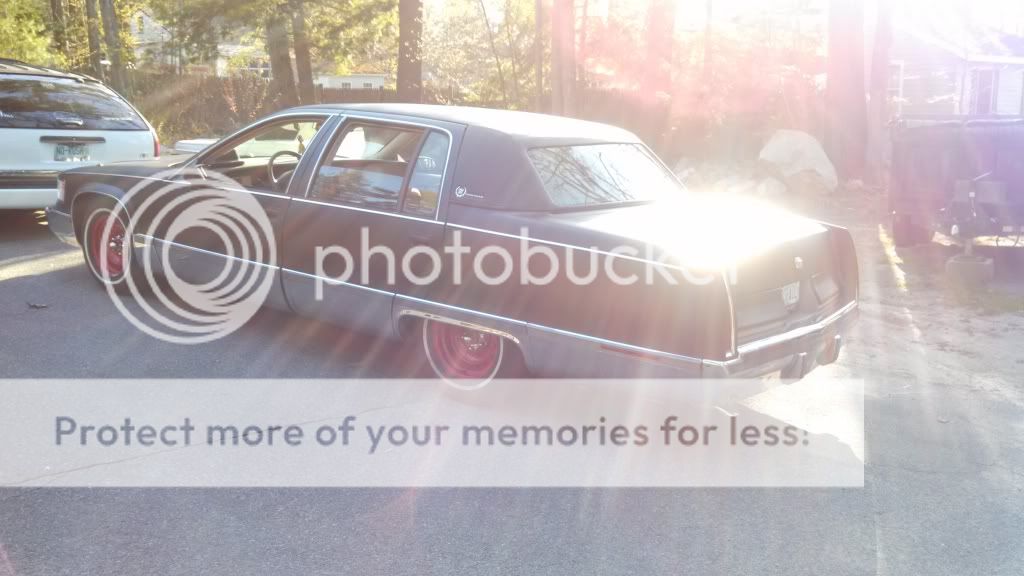

So I just snapped a couple (already) dirty, just-started-raining, daylight pics... Smoothed itself out pretty good!
Now, no more pics til it gets more lower. It's embarrassing! Razz

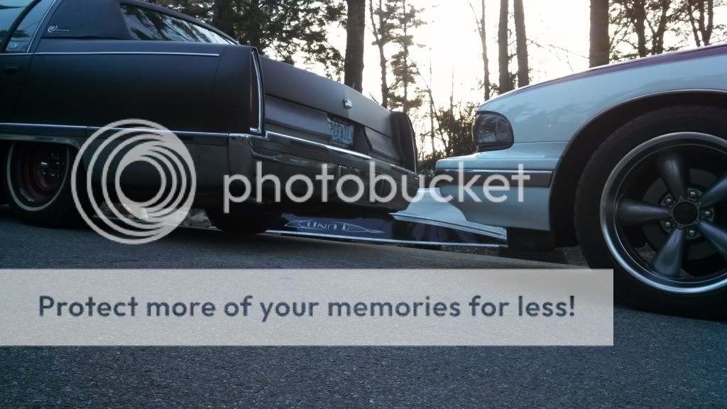

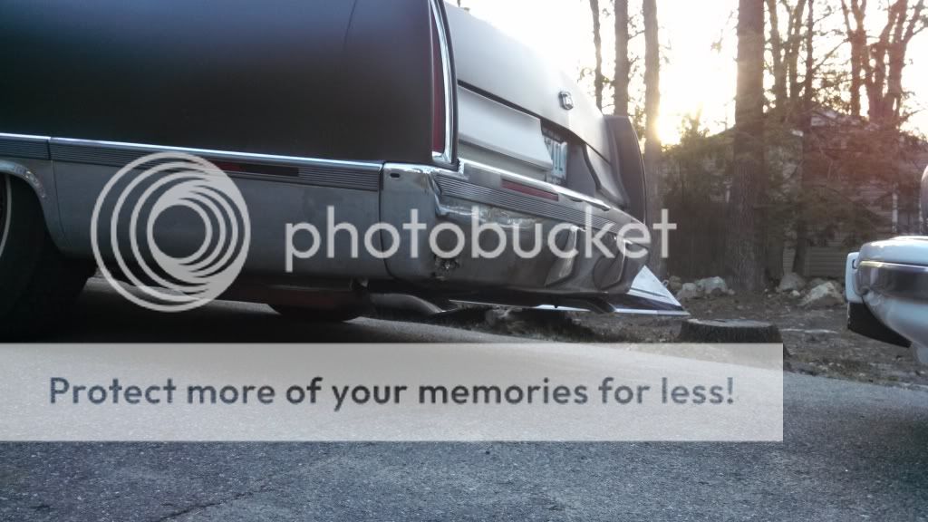

So I got the exhaust done today. Muffler delete with glasspacks in place of the resonators and chrome turndowns. Looks good! Way too quiet though. Go figure. Hope it gets a little louder when the glass "breaks in"... Wink
I wanted to be able to see them from the side. He didn't quite get them low enough for my taste, but probably saved me a ton of aggravation when I lower it. Wink
Here's a couple poor lighting, out of focus, blurry and can't-quite-see-it pics:
I'll get better pics in the sunlight. I like the way it looks. The classic chrome turndown tips really look at home on it!
And I know I said no more pics til it's lowered, but the back isn't embarrassingly low, so these get a pass. Wink

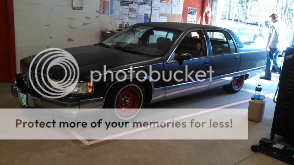

Got some more work done on it today. Replaced a roller in 3 of the 4 doors and now all my windows work! I also programmed my eBay sourced remote to the factory keyless and now I can lock and unlock it like a normal person. Wink
Pretty much done except for the bumper, driver's seat fix, springs, and eBay tint. Smile

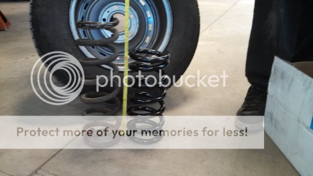

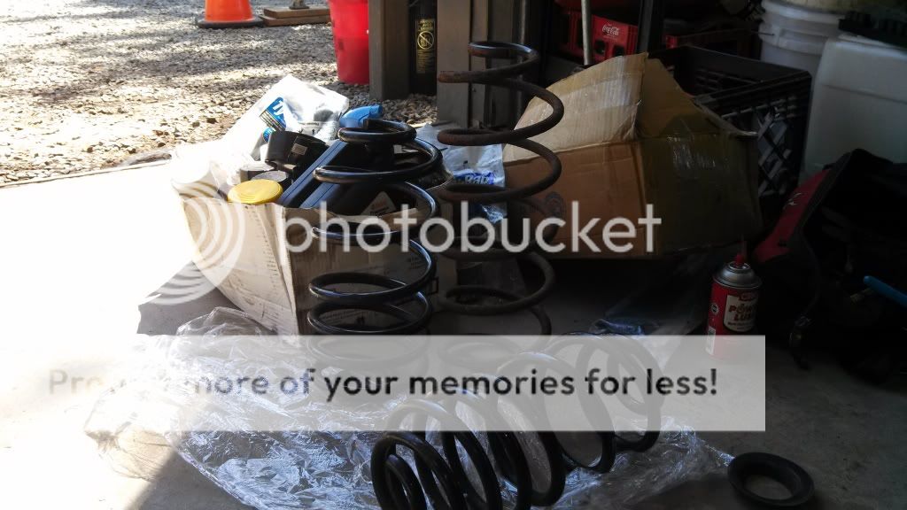

I'm waiting in anticipation for the lowered pics. Do you have springs already? I might remember moogs being mentioned. I've got those chopped SS springs kicking around if there's interest, let me know.
PostSubject: Re: I don't know why they keep following me home...    Sat Apr 20, 2013 8:12 pm
Yeah, I got a pair of those magic front Moog springs and a pair of used Eibach rears. Hope it's low enough. Wink
Pics of your car on those cut SS springs?
PostSubject: Re: I don't know why they keep following me home...    Sat Apr 20, 2013 8:20 pm
As low as the rear seems to sit, I would replace the fronts, and drive it til it settles and see if it sits nice.
PostSubject: Re: I don't know why they keep following me home...    Sat Apr 20, 2013 8:25 pm
Maybe, we'll see. That was my original plan until I stubbed my toe on those Eibachs. And I'm pretty sure that the passenger rear spring is NFG. It wicked sags on that corner.
PostSubject: Re: I don't know why they keep following me home...    Sat Apr 20, 2013 9:37 pm
Chopped SS springs/ST rears

Wow. That was low. Too low for a daily! That's for sure! Looked totally bitchin, though! Very Happy
PostSubject: Re: I don't know why they keep following me home...    Sat Apr 20, 2013 11:02 pm
Yup. Its not even a daily and it was too low lol. But the 5662/drop shocks/new isolates/zq8 helped the drive. Not the handling (yet) needs alignment still. But it handled friggin awesome when it was basically body in frame.

More betterer pic of the ezzozt?
And newest mod. Missed her. Wink
PostSubject: Re: I don't know why they keep following me home...    Thu Apr 25, 2013 8:42 pm
Sure to cause some distracted driving Very Happy
Nice speed hole in the bumper, if your ever in this part of NE and want one less rusty it's all yours Arrow

She got more lower today!!!! I went with Moog 5662 front springs and a lightly used pair of Impala Eibachs in the rear. Swapped in a pair of Gabriel Ultra shocks up front and new sway bar bushings, too.
Here's the spring comparison between the stock Caddy springs and the Magical Moogs.
And the stock caddy rears and the Eibachs.
I saw the height difference and was like, "EHRMEGERD! I made a HUGE mistake!"
But I didn't. I so didn't.
Here's the before measurements. They were taken from the floor to the bottom of the wheelwell trim in line with the center of the rims.
LF 28 3/4"
RF 28 1/4"
RR 16 3/4"
LR 17 1/4"
And after, right off the lift and a short drive. Probably no settling. (It looks lower after my 50 mile ride home)
LF 26 1/4"
RF 26 1/2"
RR 16 1/8"
LR 16 1/4"
Car rides awesome now! No more float! Love those Gabriel Ultras! And before, the thing leaned like a mo-fo in the smallest of corners, now it easily overdrives the tires. LOL! Very Happy
The car is much more pleasant to drive now, and looks just right and I couldn't be happier with the way it sits! Very Happy
All I have left is to install my eBay tints and replace the radiator that started leaking today. At least I have one. In storage. Somewhere. Rolling Eyes Doh!
She's just about done!
