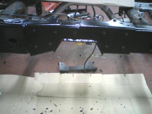

Removed, rear bumper, hitch, & spare tire. New steel rollpan
Pulled the bed, removed rear axle, gas tank, charcoal canister, wiring. Stripped the frame to bare steel, ground & sand-blasted any rusty spots, cut the frame & installed boxing plates, then everything got 2 coats of SEM Rustshield

Frame all done, thru the old axle in to move around till I finish the new one.

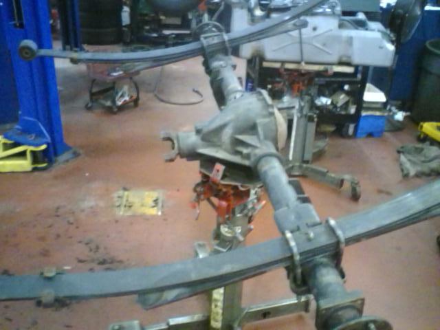

new rear diff:

Rear diff is in, ON TOP of the leafsprings (dropping it 6 inches). New e-brake cables, brake shoes, rear shocks, resurfaced and painted the drums.
