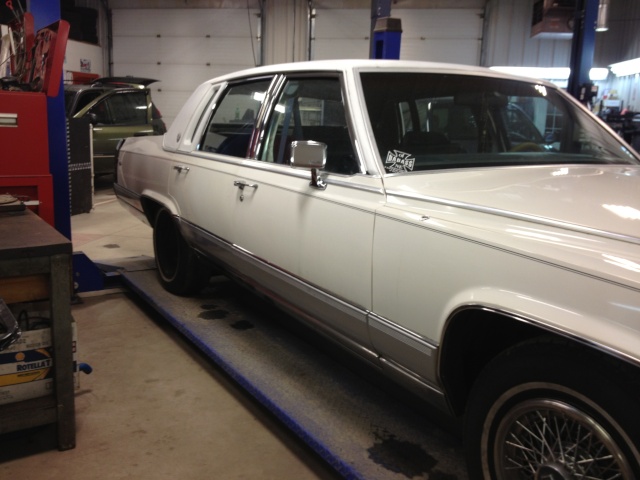

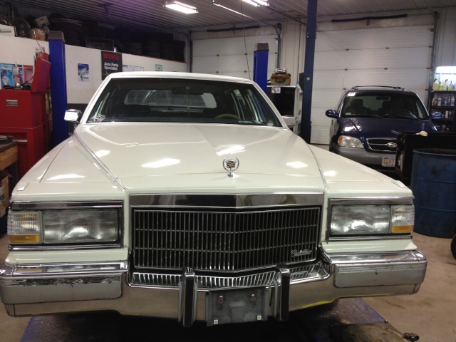

all this cadillac talk got me motivated......
Well I got to thinking, and remembered I resealed the intake manifold about 2 years ago and never set the timing after. D'oh!
Which is kinda weird cus when I moved the car last year it fired up and I hit the highway doing 80 like there was nothing wrong...
She wouldn't hold idle yesterday, I did nothing and said I'll try again tomorrow. Today she held idle without any adjustment scratch
I drove it in the shop and adjusted the timing and she felt right again.... for the moment.... When i shut the car off and reconnected the ESC , she wouldn't turn over.... disconnect the wire and she idled and reved like a charm scratch
back to the drawing board tomorrow, study but I did get some up dated pics for you picture hungry mongrels. My 91 FWB..... yup finally bringing her out 3770943023
My 91 FWB..... yup finally bringing her out Img_0115
My 91 FWB..... yup finally bringing her out Img_0116
My 91 FWB..... yup finally bringing her out Img_0117
My 91 FWB..... yup finally bringing her out Img_0118
My 91 FWB..... yup finally bringing her out Img_0119
This FWB has been off the road almost 5 years, all the surface rust is from it sitting in the woods for 2 years, still no rot. The 1/4 panel extensions broke due to being old brittle plastic, not from being rear ended. The top is cracked because some punks smashed my windows. I washed it once before towing to my shop. Clean Huh..... Ive owned the car since 2006, and I have never buffed it. king
