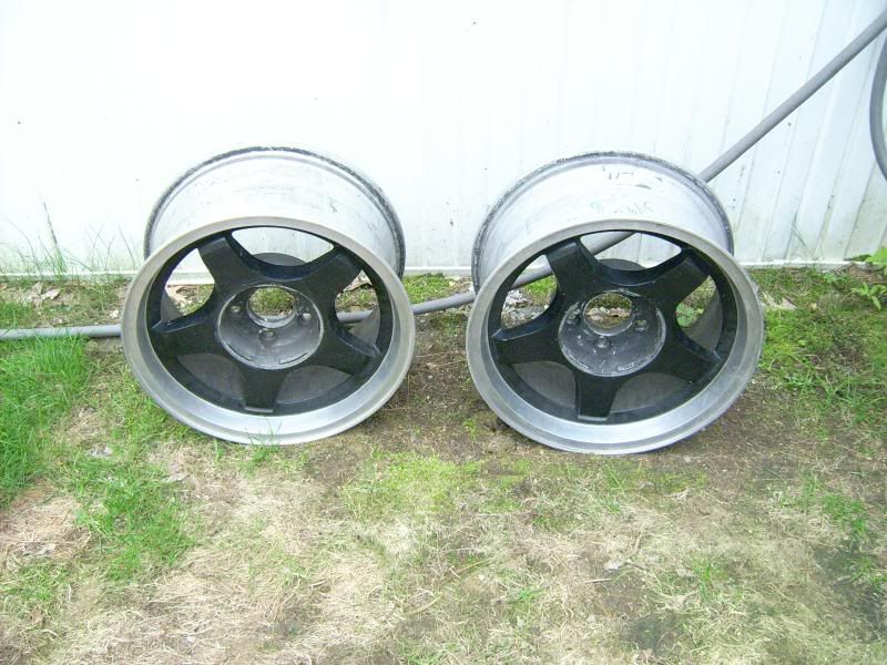

I have had this idea for some time now. And since I had an old set of ss wheels, I figured I'd give it a go. So I started stripping them last night.
This is how all four looked when I started. affraid

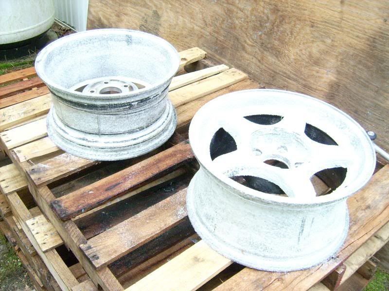

Here is the chemical stripper at work on two of them.

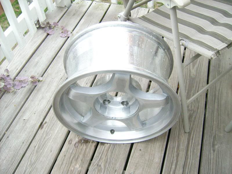

Here is the first one after the center cap ridges are ground off. Just under an hour to get this far. Still needs final sand before powdercoat
Close up.
Kinda looks Corvette-ish

PostSubject: Re: Exposed lug nut wheel mod   Mon May 18, 2009 8:21 pm
Before
Side by side: Notice I grinded the ridge off
After

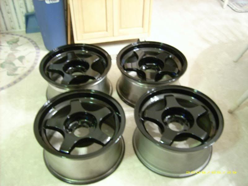

PostSubject: Ready for powdercoat   Tue May 19, 2009 6:28 pm
The grinding, sanding and buffing is now over. These puppies look great IMO.
Just washed and ready for powdercoat. cheers

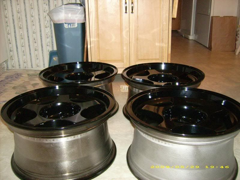

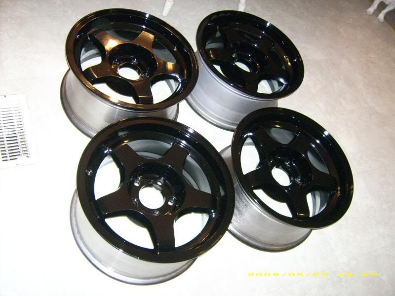

PostSubject: Re: Exposed lug nut wheel mod   Fri May 29, 2009 7:57 pm
Powda coat 101
This would not be complete without the other three.
He even did the back side.

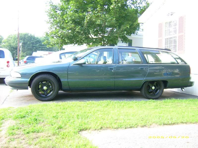

And now with rubber
And finaly on the car.

If those had a chrome lip on them I'd drive up there tomorrow and try to talk you into selling them. As they stand now I think their only worthy of me driving up and taking them when your busy playing with the dogs Laughing
I love how you manage to have a neat idea and then follow through on it. It's inspirational for all us slackers who just think up stuff and then go take a nap. I won't mention any names Wink
Age : 71
PostSubject: exposed lug nut wheel mod   Sun Jun 28, 2009 11:04 pm
billy when did you get the other rear fender done? it looks good. i thought you only had one fixed when i was there.
