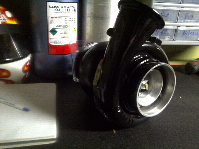

Thanks for keeping me motivated guys lol.
...but pretty soon....I am really going to need someone to talk me out of this...
9/8/12 Race Day Build Count Down - Page 2 Springfield-20101117-00106-1
9/8/12 Race Day Build Count Down - Page 2 Empty
PostSubject: Re: 9/8/12 Race Day Build Count Down   9/8/12 Race Day Build Count Down - Page 2 EmptyMon Sep 10, 2012 8:05 pm
If your looking for good sense....please move along... Laughing
PostSubject: Re: 9/8/12 Race Day Build Count Down   9/8/12 Race Day Build Count Down - Page 2 EmptyMon Sep 10, 2012 10:43 pm
Talk you OUT of it? Not likely. Lets show them damn civics what a turbo does in a real car!
