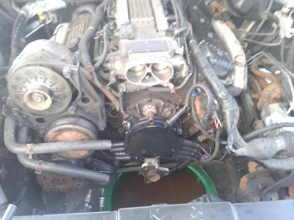

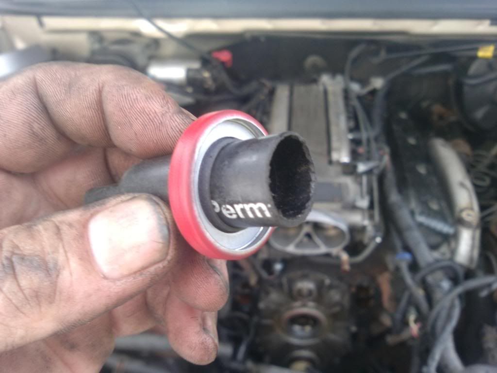

I was trying to track down a slight lack of power other than the fact it is a L99. It just seemed to be held back by something. So I found the inlet hose not attached to the cap on the opti. This is not good. It means anything passing by the hole. Dirt, oil, moisture, will be sucked in by the vacuum. I found evidence of all three. So break out the wrenches and try to beat my own record of 2.5 hours. Not even close. It was hot, and I dragged ass to the tune of 3.5 hours. Figured it would be a great time to take pics of how things should be during assembly. I purchased a new opti, fel-pro front cover gasket kit, and went to town.
The opti in the car seems to have been replaced with a basic ebay unit.

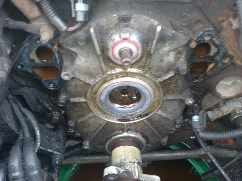

I could see the seals on the front cover had been replaced when the opti was done, but there was a lot of oil everywhere. So I replaced them with the ones from the front cover kit.

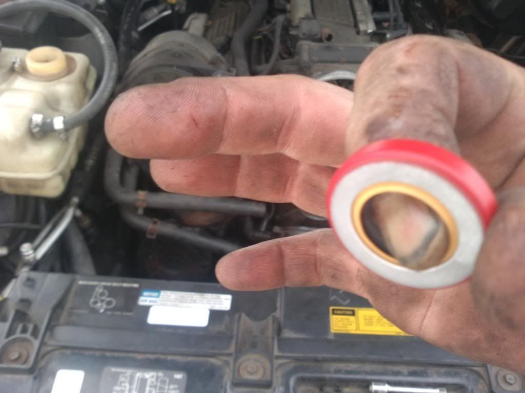

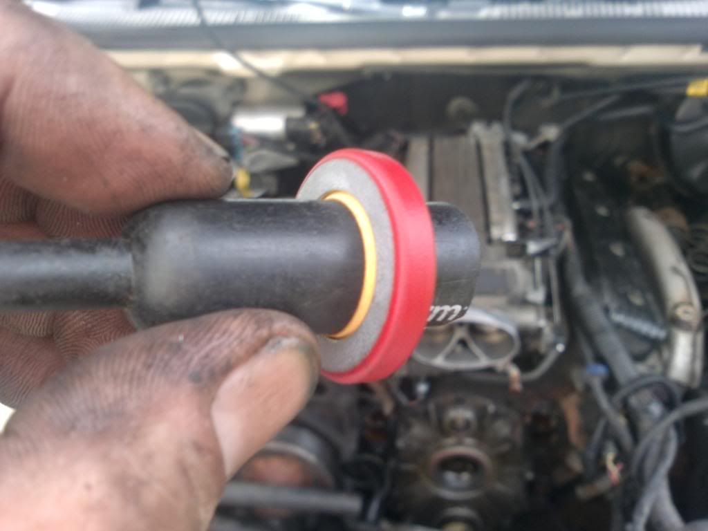

When installing the water pump output shaft seal, it is critical to understand that there is two seals within one. The black one needs to face the motor, and seal in that direction too. The yellow seal should face and seal away from the motor. To do this you need a tool, or make your own tool out of a magic marker like I did.

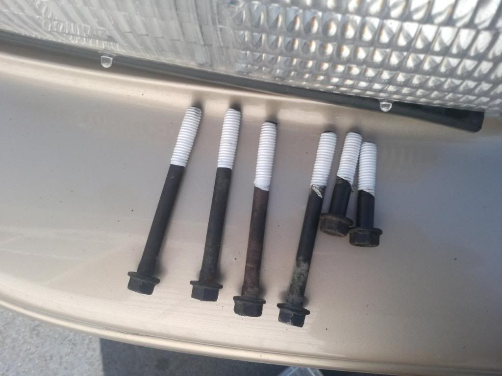

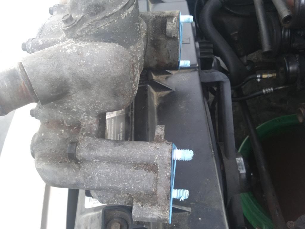

When putting the water pump in, it is important to seal the threads with teflon tape. I wound once up the threads and once back. Then I push the 4 long bolts all the way through the water pump, and install the w/p gaskets. Now put some teflon past on the ends of the bolts and install the water pump loosely. Now install the two small bolts and tighten down the water pum. But watch the gasket to make sure it does not move, as the holes are too small for the hols in the gasket, and can sin and break the gasket. I have had this happen before. Now tighten down to torque spec.

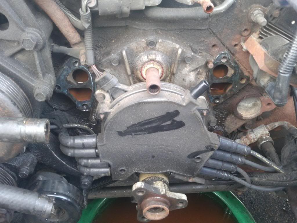

And back together
But that is not the end of the story. I had found 6 of 8 wires touching metal as not were secured up, and two boots cracked wide open, and two plugs loose. So I installed new wires a few days ago. The wires and the new opti helped, but did not cure the lack of power. So after a beat run, I replaced the fuel filter. Still felt like something was missing. I could tell it was no running good when I could grab the throttle linkage on the throttle body and rev it up only to have it bog down, then the rpms would go up, yet slowly drop back down. Finally, I replaced the ignition control module with a known good one. This time, I found a crisp snap of the throttle and she not only responded, but came down as quick as they went up. So I took it out for a beat run. Holy crap! I forgot what a L99 should feel like when it is running great. It pulls hard in the mids now. Still not much at the bottom, but still decent power.
