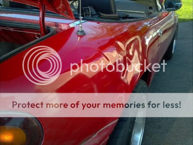

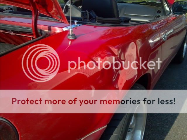

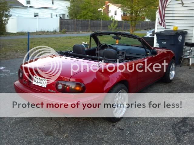

So my miata came with a huge dent in the passenger rear quarter. A friend of mine suggested a BRILLIANT way to try and fix it. So I tried it today. Wink And this is relevant, because you can use it on ANY car! Razz
This is what I started with:
And the day I bought it - only close-up I had!

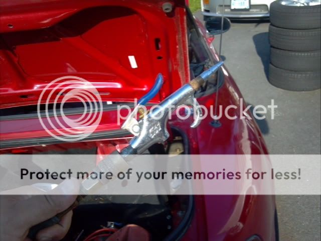

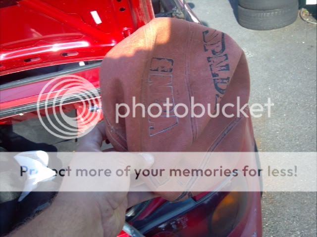

So you ready for this? Get a basketball. And do this to it:
Have yourself one of these ready:
And then do this:
Hit it with this:
Tap outside with hammer. Deflate. Move. Repeat. Deflate. Move. Repeat. Etc, etc, etc.

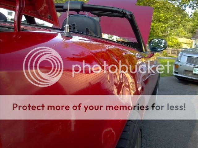

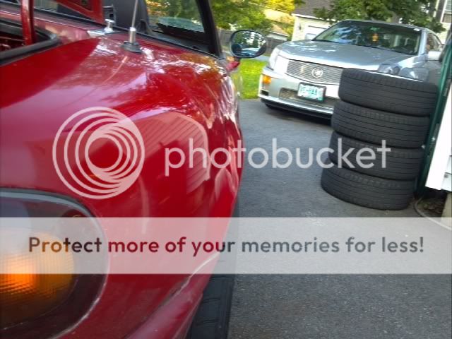

Here it is in progress and after about an hour of messing around on the last one:
It actually looks better in person right now than the pics show. I don't know if it looks better than it did when I started, but it definitely looks... different. lol. It will need some filler when I'm done. But that's ok, cuz I'm going to paint it anyways....
