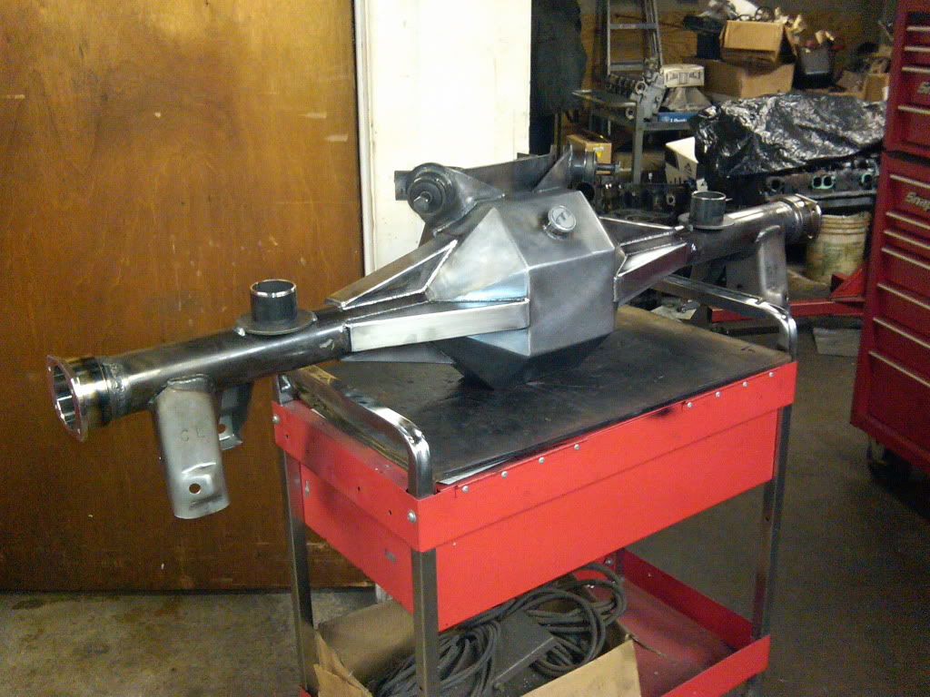

The white 88 LS in my photo below has this 9" Ford that I welded-up from scratch using a 96 9C1 housing as a "jig-core", but I just made it 2" narrower @ the bearing ends so that I could fit big tires.
It has 35 spline axles, both 4.75" & 5" bolt circles, but with a small 2.776" hub diameter, "N" center, detroit locker, Wilwood Dynalite 12" discs, Global West lower arms, stock uppers, it fits both my 96 and my 88 cars.
Question on BOX CAPRICE rear end / spindles E3293b9d
This one (below) I built for my 96 SS, and it has been trial fitted for pinion angle and brake/wheel clearance issues in my 88 LS as well as my 1995 9C1 bare chassis.
It has a Strange aluminum center, TrueTrack, 31 spline Mark Williams Pro-Street axles, 45mm Timken roller axle bearings, 2011 Vette ZO6 brakes, DBA rotors, Johnny Joint upper control arm pivots.
Question on BOX CAPRICE rear end / spindles 30b7a8c5
