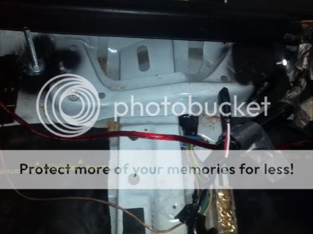

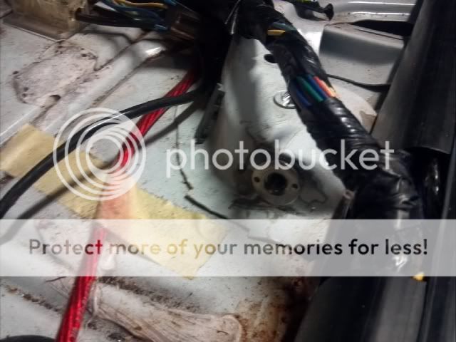

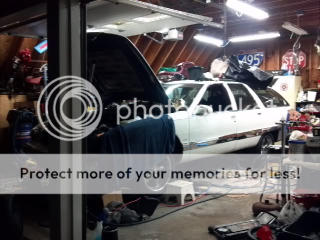

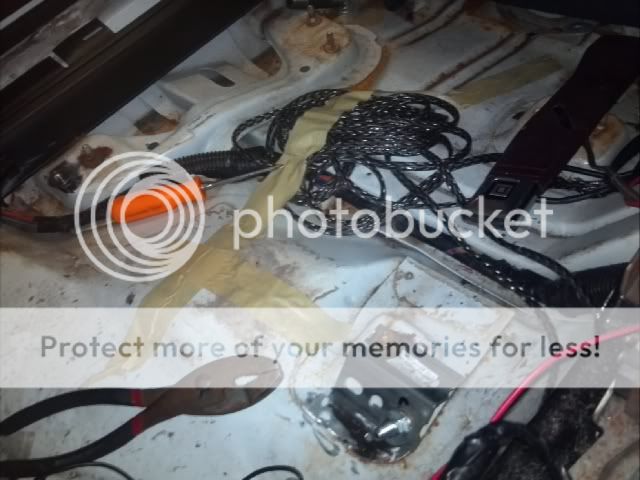

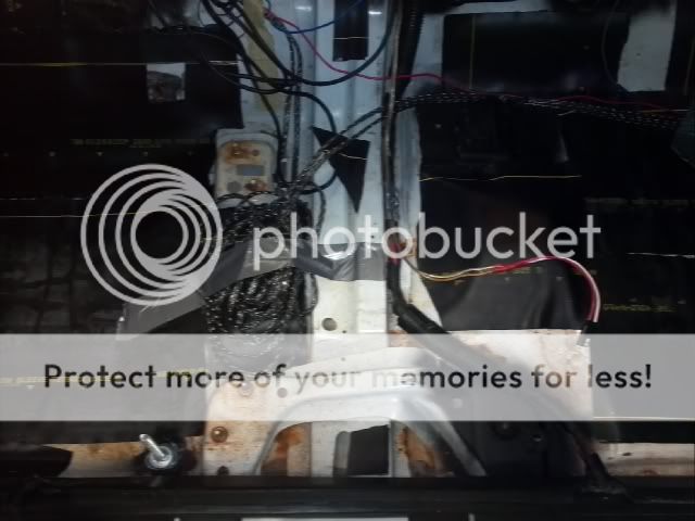

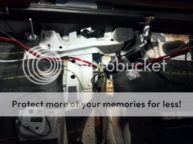

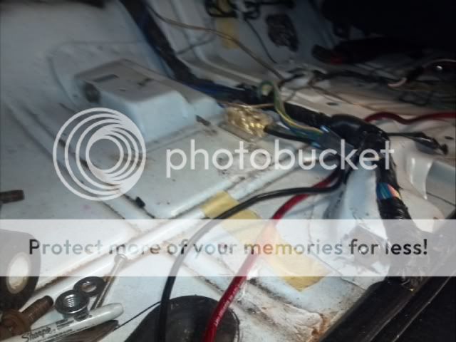

So, some progress. Slowly.... I got the seat mounts figured out. Bobby came over the other day and showed my how to use my welder. Wink They went in pretty easy. Had to cut off a couple factory seat studs, and drill a couple holes. I welded in some thread inserts for 3/8-16 bolts in the holes I drilled to make it secure. Now the interior is out again so I can dynomat the floor. Here's some pics...
Her seemingly permanent position.
And pics of the seat mounts.
I am in the process of cleaning and dynomatting now. Maybe the interior will go back in tomorrow?
Doubt it. Razz

Ok, so I have the carpet back in and 3 of the 4 bolts on the seats in. I screwed up with the thread on the seatbelt bolt locations. It's not 12mm x 1.5, nor is it 12mm x 1.75, nor is it 1/2 13.... Grrr. SO CLOSE!!!!!
Here are a few pics of the final mounts.
Like I said, I also have the carpet in. It's looking closer to being done!

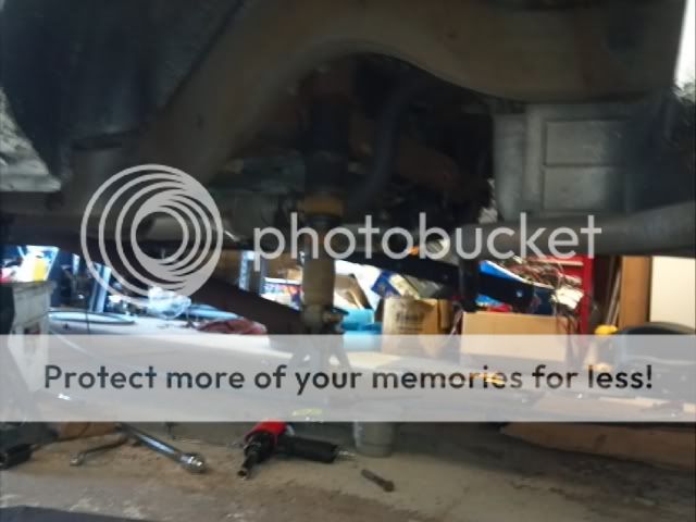

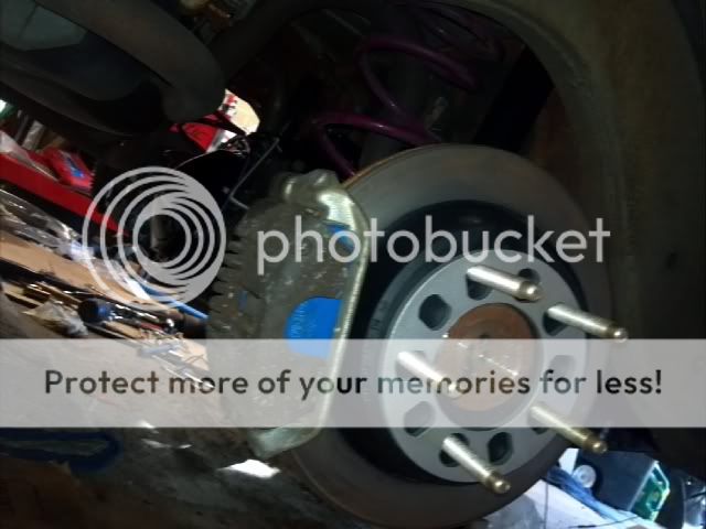

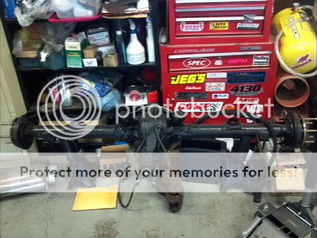

So thanks to BillyMac coming down today, some progress was made! Smile Plan was to get the new rear in and go for a ride. Yeah, not so much. As per usual with all things me, nothing was easy or went as planned. Razz

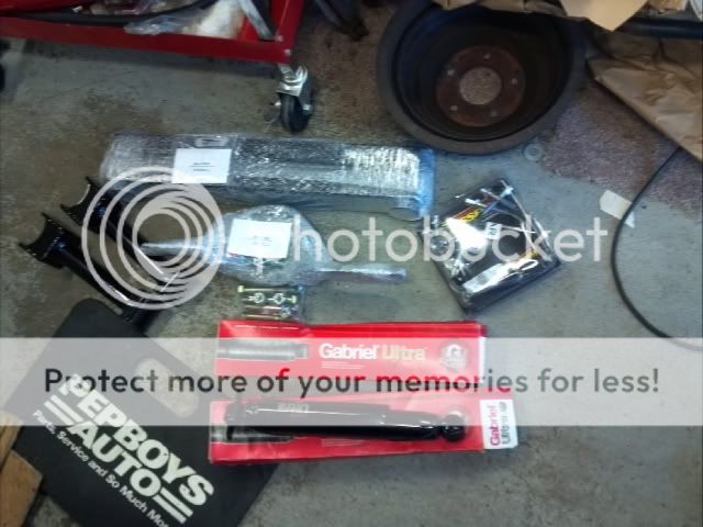

We started with a pile of nice parts...

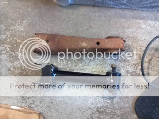

UMI upper and lower control arms, Russell stainless braided brake lines, Gabriel Ultra shocks and the built rear.
Pics of the uppers as a comparison.

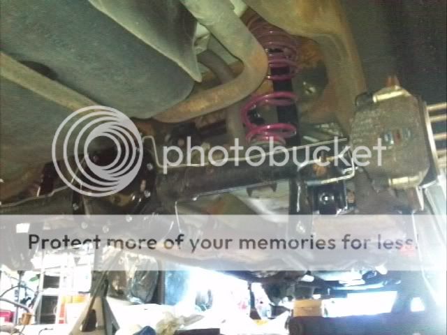

The old axle came out pretty easily.
And that's when it stopped being easy. The rotors has rusted from sitting so long, so I had to find a place to cut them. Ended up at NTB and they did em for 10 bucks a piece. I got back to the house, and the we didn't have the right bubble flare tool for the brake lines. So off to sears. No bubble flare tool. None of the parts stores either. So then we just ended up getting some long bubble flare lines and cutting and rebending them again. And by we, I mean Billy. Smile
We also didn't have the brackets for the brake lines, where the hard lines met the braided lines. Ugh. So I had some from the old rear out of the slut, and we modified them to fit. Plumbed the lines to em and we were good! Or so we thought... Rolling Eyes
So we put in the new uppers, lowers and shocks. Some fighting and colorful language was involved, but they went in. Then we put the rear and, and with some creative prying and hammering, it went in! Yes, you CAN put an SS disc rear in a wagon!!!! But, I uh, forgot to take pics. Oops.

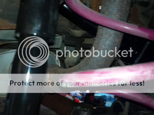

So here is your clearance with the SS wheels on it. There's about a 1/2" clearance between the tire and the frame. And plenty from the tire to the wheelwell lip.
And look! Discs on a wagon!!!

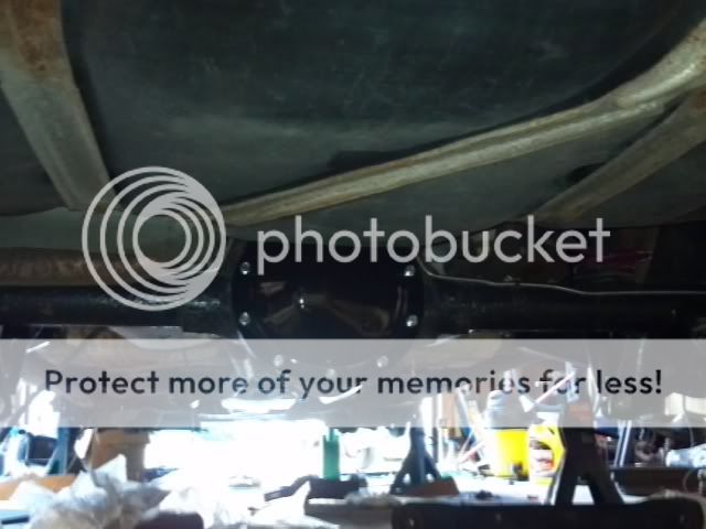

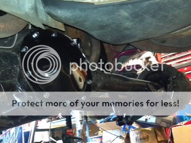

But, there's still some not-so-great news. The friggin' Trick Flow super duper rear end cover hits the gas tank heats shields. Ugh. But that's ok, because it hits the gas TANk, too! Boo!!!! And the brake line brakets we made are in the way of the damn exhaust on the driver's side. Fail. Plus the garage was a freakin' mess and we were searching for tools and crap more than we were working. I take the blame. Oh well...
I ordered a set of stainless hard lines tonight when I got in, and Al said he had a set of the brackets that I need. I need to get a stock rear end cover, too. So when that all gets collected, I'll get back under there and finish it. We didn't even attempt the Panther sway bar today, but I will when I'm back at it. I'll get some more pics then, too.
Sunday I'll be out there cleaning the garge and putting all my tools back where they belong. Today was ridiculous!
Billy busted his ass today, and I wish we had more to show for it, but I had a fun day wrenching and running around. Thanks Bill, you rock! Smile

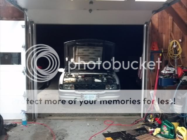

PostSubject: Re: Marshmallow Fluffed...   Sat Sep 22, 2012 1:16 am
It's ALIVE!!!!!!
FINALLY finished it up tonight. Those friggin Subaru seats were holding me up every time I went into the garage. I finally abandoned them this week and got Jay's old seats from Chris for the time being. That was all the motivation I needed to finally spend a few nights under and around and in it to get it done.
I finished about 1215 tonight!!!!
Pulled it out of the garage and went for a ride. Put 35 bucks of 93 octane in it and drove it pretty easy. That converter will certainly take some getting used to. Wink The brake pedal is SO much nicer now with the stainless lines out back and the rear disc. It'll be even better when I get the front lines on and do the stealth bolt and metering rod. Oh yeah, and the Vette brakes up front. Wink
She's quick. Even at 1/4 and half throttle. Oh yes. Smile
Here's a few shots of the rear end all buttoned up...
She sits a LOT lower in the back now, too, without the air ride... Has a bunch of crap in the trunkal area though, too...
Now, I'm going to bed. Felt good to drive her again! So stoked!!!!

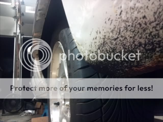

Here's a few more pics I took... Proof!
And oh... Shit.

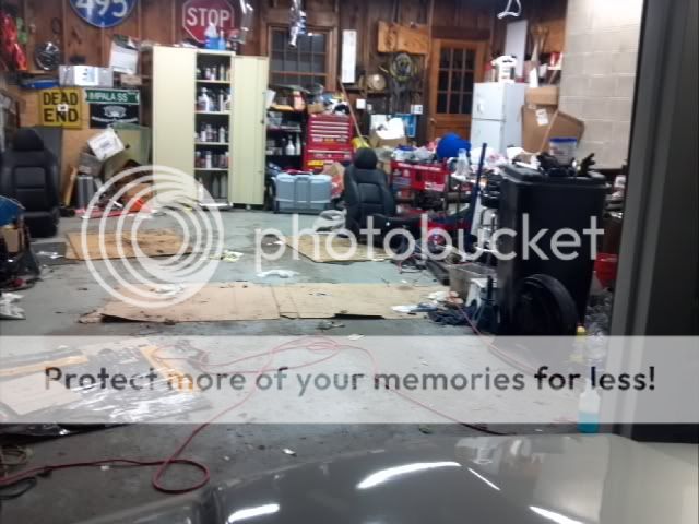

Congrats. Now clean the garage so you can move. Wink
PostSubject: Re: Marshmallow Fluffed...   Sat Sep 22, 2012 6:55 am
Congrats. Now clean the garage call the HAZMAT team so you can move. Wink
Fixt
That garage is gonna miss you Surprised
PostSubject: Re: Marshmallow Fluffed...   Sat Sep 22, 2012 8:08 am
holy shit i thought my garage was trashed. You sir are the winner! Laughing

Sweet! What size tires you running on there?
PostSubject: Re: Marshmallow Fluffed...   Sat Sep 22, 2012 9:30 am
Thanks guys. Smile
Yeah, it feels awesome to drive it again! And no leaks sitting in the driveway all night!!!! Smile Has a couple exhaust leaks, but that's ok as it's getting the Jardine exhaust this week anyways. (One less thing to move) Razz
Tim, those are just stock sized wheels. I couldn't run the Coy's in the back because the backspacing was off with the narrower rear end. I need to get a 20mm or so spacer made for the back. And I didn't want to run SS wheels in the back and Coy's out front, unless they were drag radials... Wink As it is, I'm running 5/16" spacers out back now. Didn't need em, but I had em and it looks a little better pushed out a bit.
And yeah... Not looking forward to cleaning the garage! scratch
