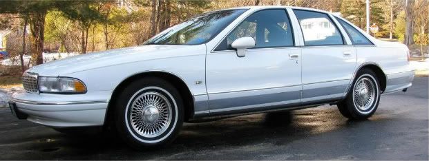

So the picture below, which is also my new signature pic was taken yesterday. As you can see I finally got the lowering springs in it. Found them lightly used on ebay for $90. Dropped it down a good 2 1/2". She is going in for an alignment on Tuesday. I am loving what I've done to it so far and can't wait for the exhaust work to be done. Also in the works, I am replacing the 2.93 gears with a set of 3.42s. I also have an SS spoiler and grill that are being painted right now to match the car. Also I am thinking about blacking out the pillars. I saw them on Matt Trackers white Caprice and loved the way it changed the look of the car. It is not really worth doing too much more to it, as she is getting very cancerous underneath. Most everything I have done and bought for it I can pull back off and resell if it ever gets too bad and needs to be retired. Still planning on a C5 Vette by my 50th birthday. But the Cloud 9 should get me to that point easily enough.

The drop looks perfect. Its come a long way since I was at your house getting those wheels. I cant wait to see it with the grill and spoiler installed. Ive always fancied a white b body.
PostSubject: Re: The Transformation of Cloud 9   Sat Feb 11, 2012 10:26 am
looks good lowered.

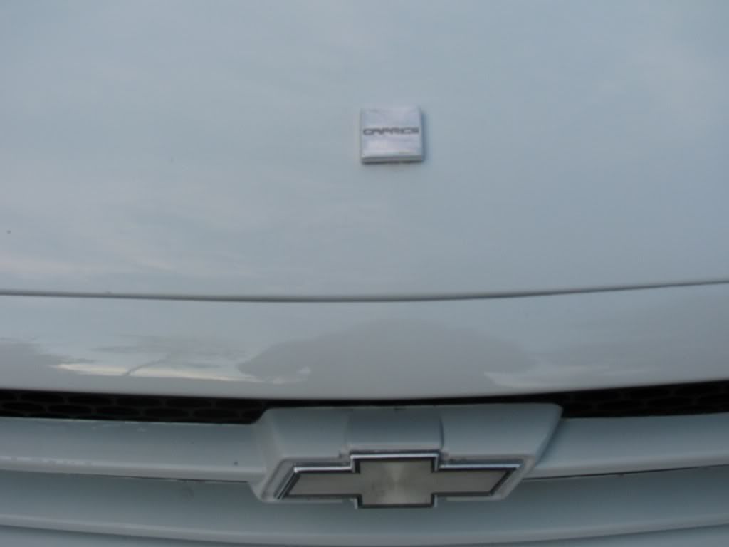

I deleted the gunsight on the hood.

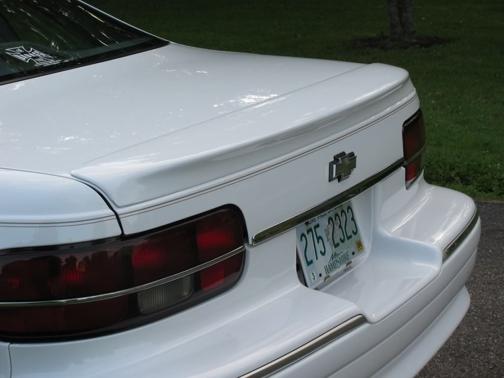

Got the spoiler on.

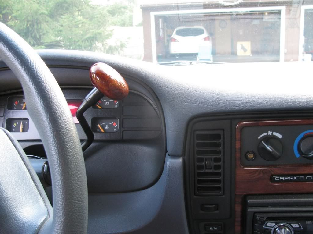

Found this doorknob when I was a teenager in one of my Dad's apartment buildings... just been waiting for the perfect place for it Very Happy
it even kinda matches the dash.

Nice, I'm diggin' the shifter, haha.
