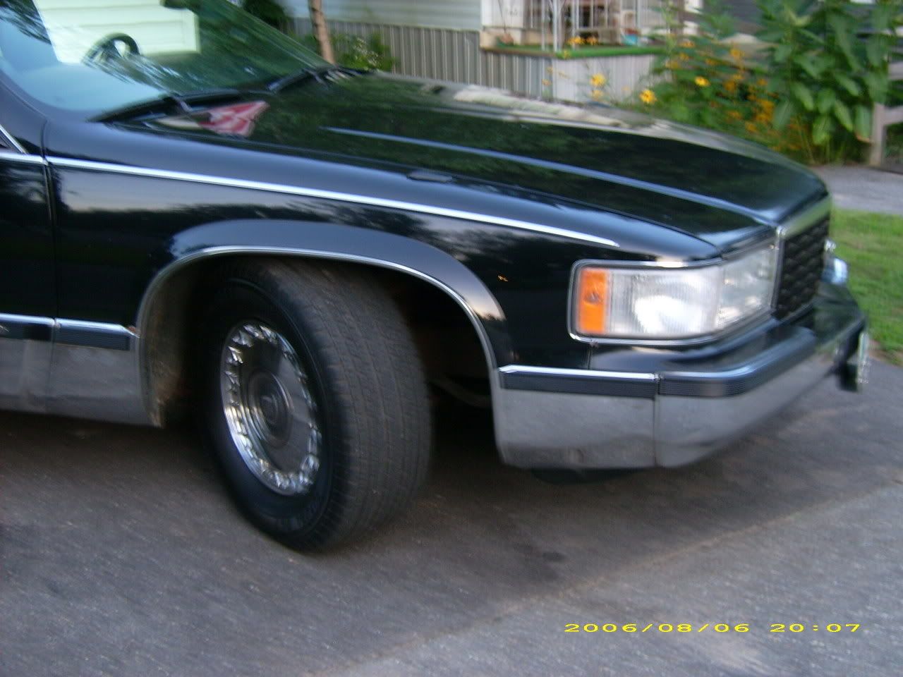

275/60/15 on stock wheels.
Deciding on 15" tire options Blackwallout011
Deciding on 15" tire options Blackwallout023
Deciding on 15" tire options Campicsebay007

PostSubject: Re: Deciding on 15" tire options   Deciding on 15" tire options EmptySun Feb 05, 2012 5:14 am
WOW! I love that Caddy! Those beauties had all the good stuff, and are better looking than even the SS, just not as sporty.
They had four channel ABS, dual exhaust, lots of extra bracing for quieting rattles and shake, the list goes on and on.
I have to concede that there are some advantages to fitting "too narrow" a wheel for a given tire size. Passenger comfort; a softer (Caddy-like) ride!
So it comes down to how you drive, what type of car you drive and what you are willing to give up in performance and/or longevity.
The general tendency is for narrow wheels to move the "engineered-in" pivot point of the side wall outward toward the tread.
The side wall is thinner where engineers intended it to flex. This narrow fitment can cause localized heating in the thicker tapered sidewall area and precipitate premature tire failure.
Generally speaking, a tire on a wheel narrower than what engineers intended requires lower tire inflation pressures to avoid uneven tread-wear patterns.
You also acquire some protection from curb-rash to the wheel, having all that tire to shroud it.
Additionally you gain a lot of snow and ice traction from a fat soft tire mounted on a narrow rim width, provided there is plenty of void area between tread-blocks.
In drag racing you seek a lower tire pressure for the longer & wider foot print, softer sidewall flex, with little concern for optimizing for the best steering response.
So for the Caddy, IF you can accept a considerable reduction of tire life, steering accuracy, lateral stability and gas milage in exchange for a super smooth ride, then its the right choice.
When smoothness and comfort means much less than achieving the best possible vehicle performance from a tire, then vertical sidewalls win the day.
Passenger car tire's wheel widths are designed to be very near 90% of the actual tread width for a balanced compromise between ride comfort, vehicle performance and tire life.
Steering response is WAY better with stiffer (vertical) sidewalls and higher inflation pressures.
These are in a large way achieved by the selection of a wider wheel (within reason and that tire's design limits of course).
I believe in the philosophy of aesthetics that states [ Form Follows Function ].
The short list of primary functions that any of my cars have to fulfill would definitely be the following;
-> high performance, reliability, safety, longevity, and the economy of properly chosen equipment to serve well and live long under variously hard conditions.
My own personal expectations are so ingrained in me, that anything that has been proven to hurt the attributes that I seek in my cars, eventually has come to look "Wrong" to my eyes.
We are all different, and the choices in tires should be based on good science and sound reasoning in order to provide each of us with the best solution to our specific needs.

Right now I have 235/70 Firehawk Indy 500's on what I think is a 15x7 wheel. Tires are ready for replacement.
Deciding on 15" tire options Dscf1660c
Deciding on 15" tire options Dscf1666o
Deciding on 15" tire options Dscf1663r
Deciding on 15" tire options Dscf1668d
These pics are old but they are what's on the car.
I've only had 15" wheels and tires on this car. Nothing bigger than a 235.
Not sure about what wheels I want to use yet..
If I were to go 275/60 all around, what width wheel should I run in front? Should I just stick with 15x9 all the way around? What backspacing for the front?

Nice photography, and really beautiful car! Well worth these efforts.
Since you work in the business, you should just get 2 to begin with, two rears: 15" x 9" with 5" back space.
Your car may be able take 5.250" B/S, but not 5.5" because it will hit the steering arm/outer tie rod.
Iv'e got N97s and with 4.5" back space have nearly, but not quite an inch before contact.
Tried these these on several of my B-bodies with the same clearance results.
The strategy here is to get your rears first, and mount them up front. Keep your 28" tall 235/70 15s in the rear while testing.
And then drive around very slowly, over a wide, full range of wheel movements, stopping often to measure how close you are to rubbing.
If everything is good, your'e done, then get your rears.
If they rub the fender, then go with [235/70 15s on 8.0" x 15" w/" 5.0" B/S (@ 28" tall) <-(good)], - - or - - [255/60 15s on 8.5" x 15" and 5.0" B/S (@ 27.1" tall) <-(better)].
The manufacturer says a 9.0" wheel is the max for 255/60 15s, but it will look quite different from the rear, unless you then use 9.5" rear wheel width, also the max. recommended.
In reality, I think a 9.0" x 15" front wheel is not good, as it will aggravate the car's straight line stability due to the excessive outboard scrub radius caused by steering arm location.
Your new wheel position is going to be measurably predictable: you have 15 x 7 wheels? If they are made like the OEMs, they will have 4.5" B/S.
The new 9" wheel is 2" wider, having 0.5" more inboard and 1.5" more outboard.
If you get too close to the front outer wheel lip moulding, you will have to go with a smaller combo, because you can not move inboard any more than that.
Measure your clearance now, and add those measured increases to your current width and height.
Note: my rear tires now are 28.31" tall (11.8" wide) and my fronts are 26.57" tall (10.9" wide), yet so far I have had no ABS issues arising from that roll-out difference.
